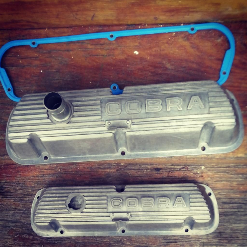

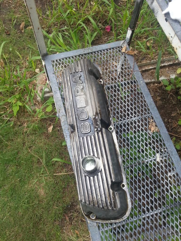

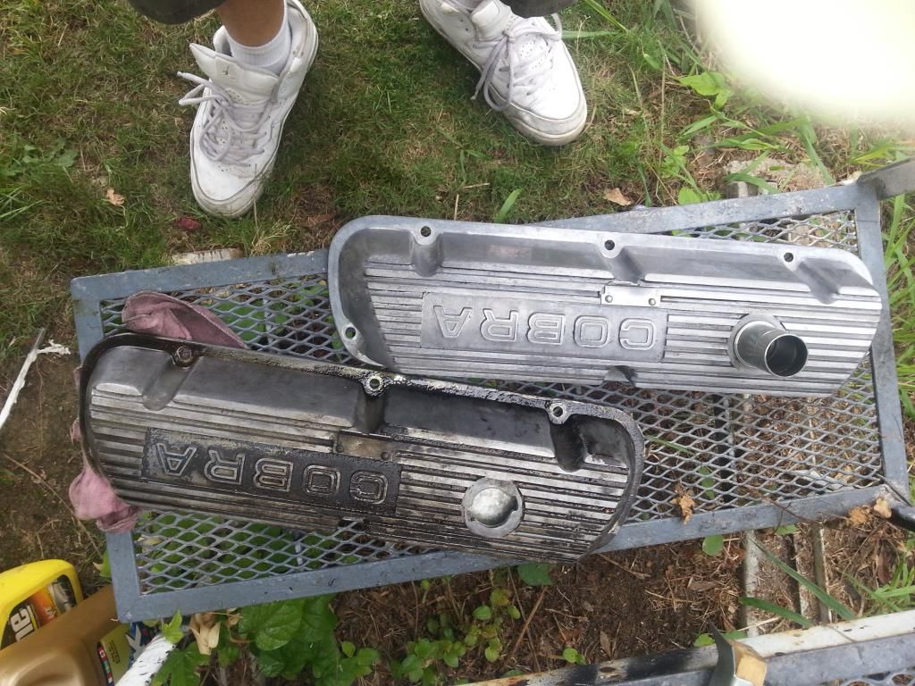

    They were Fel Pro gaskets with the steel grommets. The bolts heads required an allen wrench so I tightened them up hand tight.Ive been driving for two days now and no leaks so ill check in couple weeks to see if I have to tighten them up again. Thanks for all the replies guys.
    Since the valve covers were off I decided to clean them up

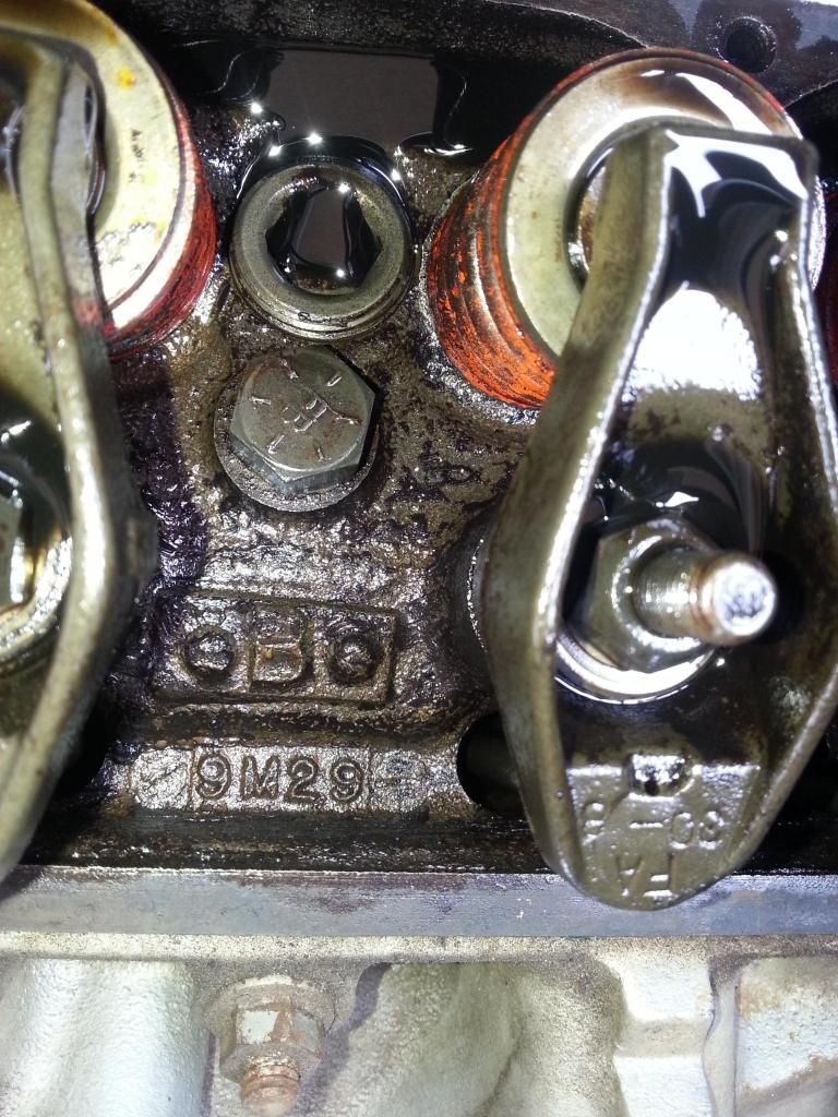

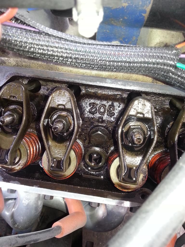

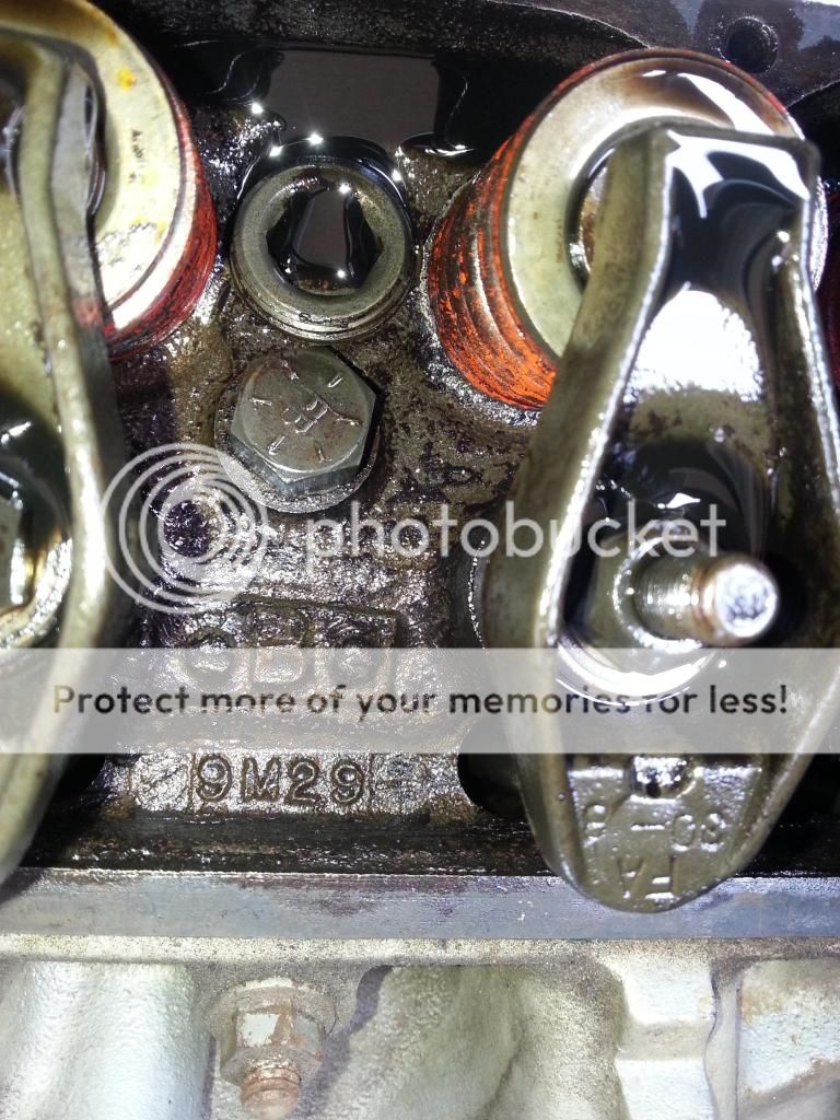

    I also took a picture of the casting code on the heads. Does anyone know if they are stock?
    It read 9M29 with a B above it. The other side has a 302

    That's the date code. 9M29 translates to December 29, 1969, making them 1970 model year castings. Probably C9TE castings. You're using FelPro's steel reinforced silicone gaskets, not the steel grommet cork. The only thing you'd need worry about are snapping the cover bolts by torqueing them too tight. You cannot over torque those gaskets, period.

    Makes sense the casting code on the engine block said its a 69 302
