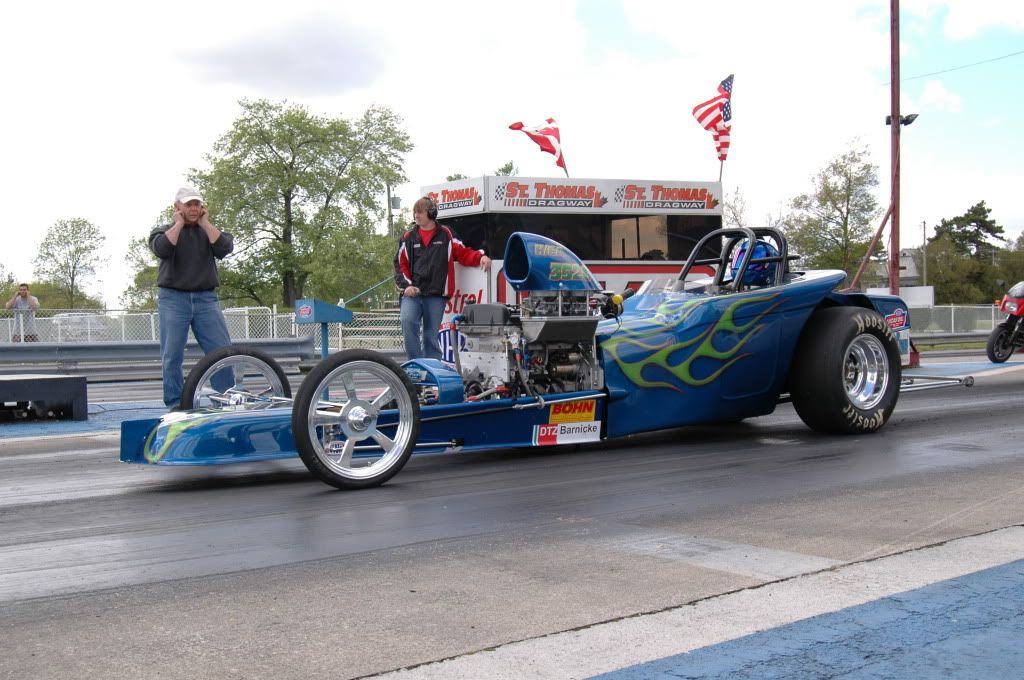

    What engine is in that dragster? A toyota 6 cylinder?

    Hey St Thomas Dragway! Are you located near St Thomas?

    Nice altered. Can't magine why that guy is holding his ears though. Just cause he's standing right next to the exhaust. :biglaugh:

    The Motor in the Drag Car is a 2.8L 4 Cyl out of a 2006 Chevy Colorado Pickup. I'm Located in London Ontario, so I'm about 25 miles from St Thomas/Sparta.

    cant be that loud, its just a four or six cylinder, :biglaugh: I cant tell which, im Import stupid.
