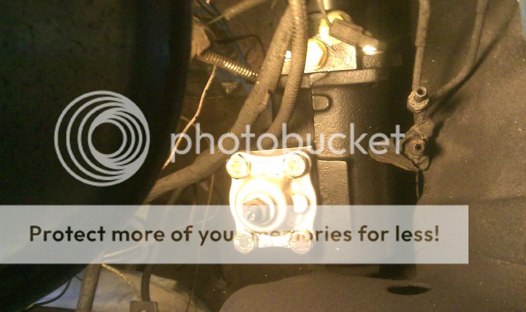

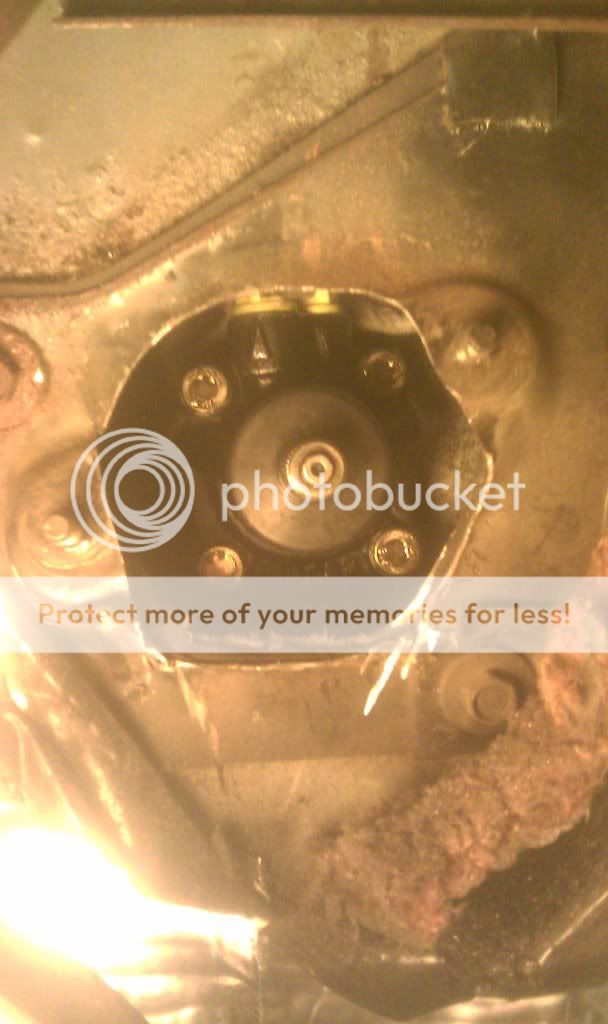

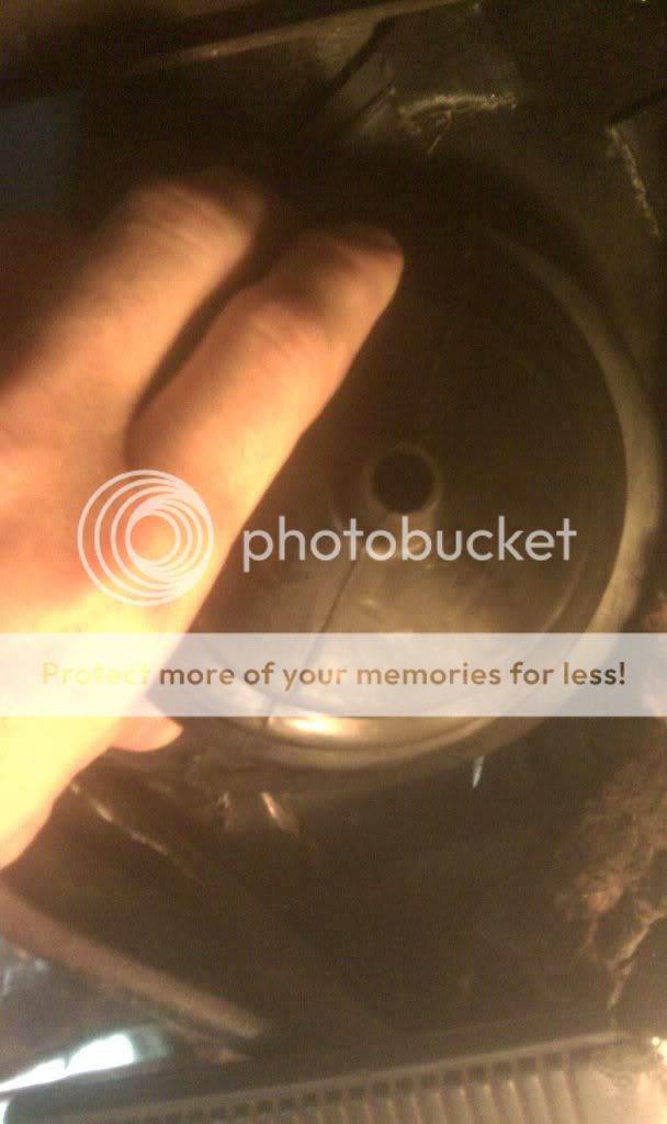

    Installing the borgeson gear box into my maverick with only a few issues. First the column needs to be removed and shortened 2" inches. Second the firewall needs to be trimmed up. The rag joint meets right at the firewall and strikes in a few spots. After a session with the angle grinder its all good except for one issue. The firewall has a gap around the column so after a flash of insight I decided to use a universal shift boot to cover the gap. pics
