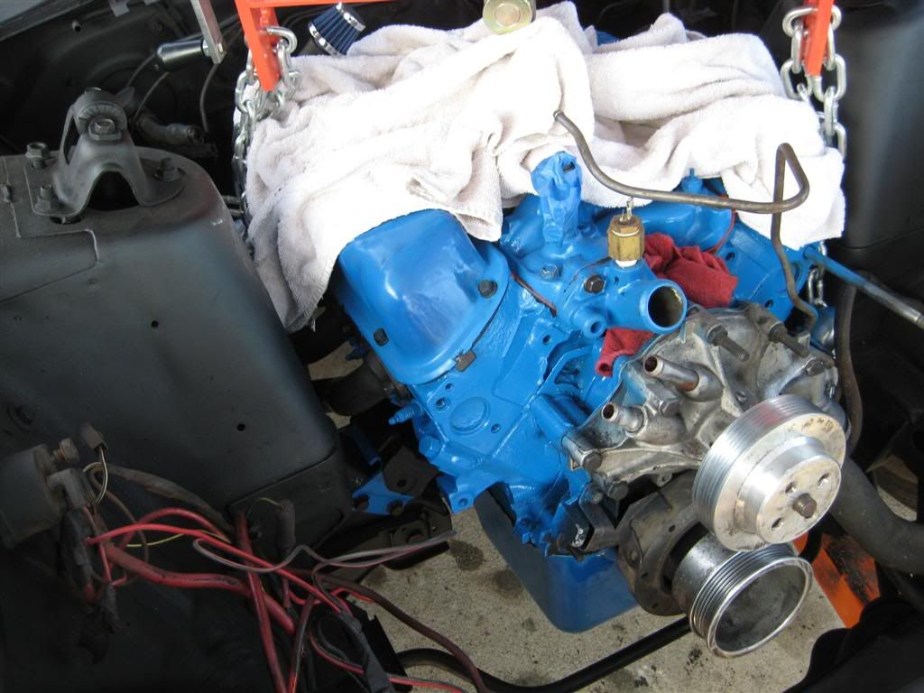

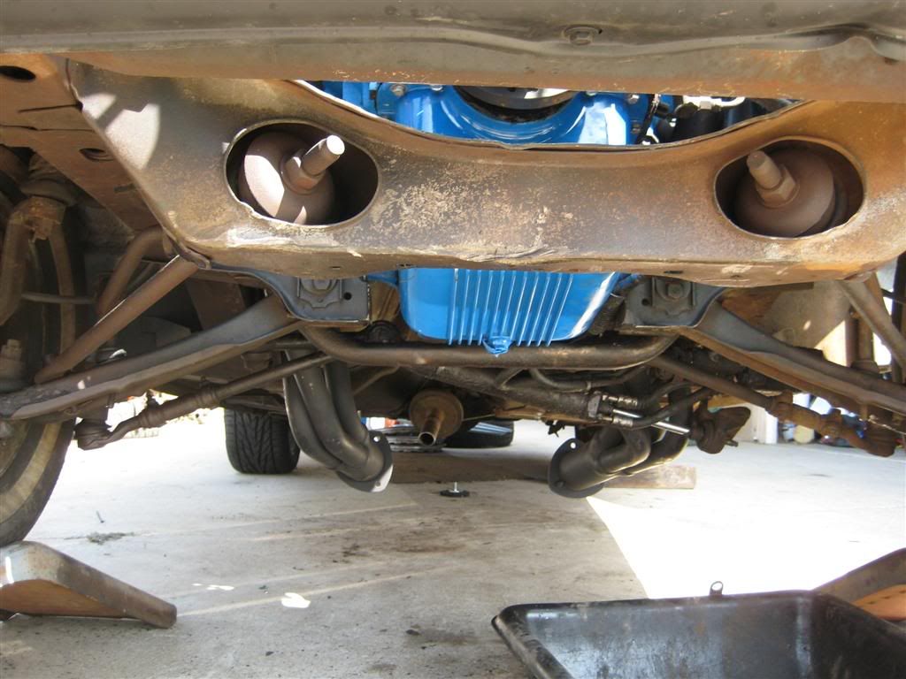

    Helping my brother in law fix up his maverick with a new motor...
    Anybody have pictures of clearance or modifications done? It looks like I need to get the drop bracket for the PS ram, but the clearance to the shift linkage bracket that bolts to the frame rail looks bad too since I had to pull that when I installed the motor this weekend.
    We used Summit brand headers, seem to fit fine other than this but I haven't installed the trans yet.

  3. Dave B
    Are they the G9031's? It says they won't work with column shift automatics. I've used Headman longtube headers, and they didn't either.

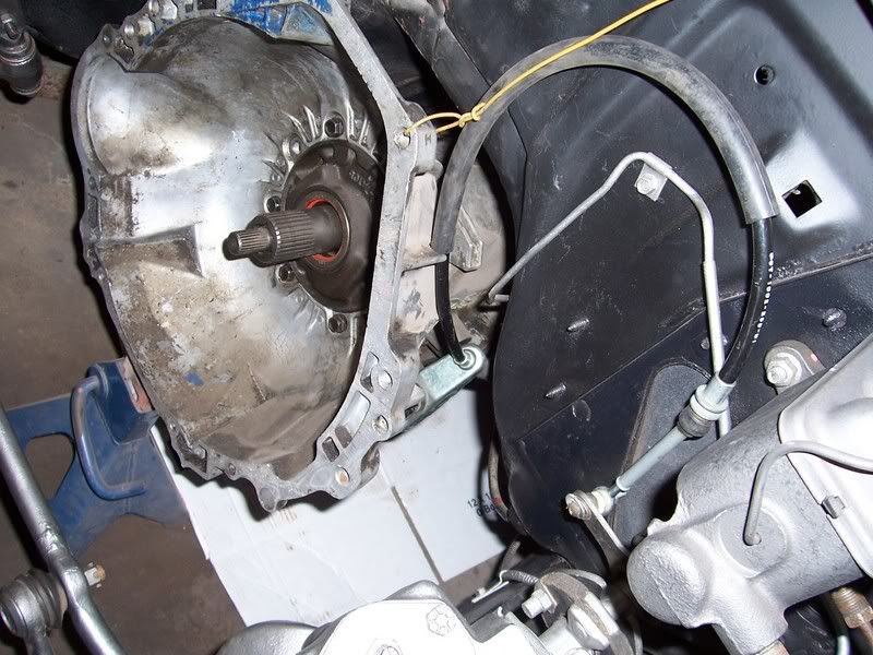

    found this image in another thread, it's a granada shifter cable -
    this should give all the clearance I need and with a bracket mounted to the m/c should be nice and secure.
    can this be reproduced with an aftermarket cable? I can't bring up a shifter cable for a `75 granada at napaautoparts.com....

    Old thread......But I will attempt the Granada shift cable install with long tube headers. One reason for it is that my car has a c4 out of a Granada, so one end is a bolt on. Only have to fab the other end. If I get it to work, I will post some pics.

    The Granada shift cable works great, all you have to do is make a couple of brackets. I modified the original column shifter to fit hooker 6901s. I drove the car with this and long tubes for four years every day. It still rubbed a little bit, but not enough to matter.

    Mine has 6901s too. My car came with 6cyl linkage in the trunk, and I was trying to get that stuff to work and lost patience with it. It didnt line up with anything that I thought it should. I have a bench seat and really want my column shifter to work correctly, so the Granada cable is in on the trans end and waiting for a bracket on the MC end. I complicated it by putting in a power brake booster last summer, but I think it will work out. I will know next week-end. Did your shifter positions line up with that welded bar? That gets points on the simplicity scale.

    The welded bar I posted is the two end points of the original 6 cyl column shifter from my car. The shift points lined up just fine and I drove the car with it (and no kickdown so I was shifting often) for 4 years as a daily driver. I did have to re-weld it once after those 4 years, and then ran it again with my 347 and Doug Thorley shorties.
    I'm also attaching a picture of the Granada cable bracket Jack Grice made for his Maverick.
