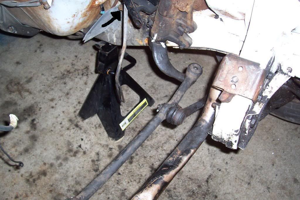

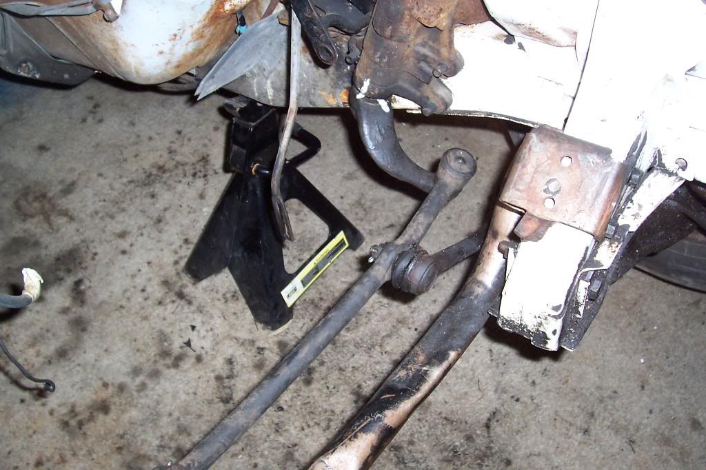

    Is it show in either of these pics from your posts before?
  9. Dave B
    Is it the one in the second picture with the rod hanging down? the one with the slot in it? If it is thats your shifter linkage, most headers don't work with column shifted cars.

    you can just barely spot it in the second pic.
    My shift linkage has been removed, but here is a shot with a MS paint edited arrow.
  11. Craig Selvey
    18,335
    1,385
    Side Note: I have never seen a shield like that located just behind where he drew the arrow.

    I got it off guys. Thanks for the help. It was just the bracket that the shifter linkage bolted to. After looking at the pics again, and looking at the lingake it made sense to me. So I just unbolted it with a bout 4 extensions and a swivel on the end of my ratchet. LOL

    Its hard to see but judging by the location of the arrow, I would say you are looking at the cross shaft bracket that goes to the shift linkage. It has 2 bolts, attaching it to the frame. If so, with headers, you will need to convert to floor shifter anyways, so just remove it.
