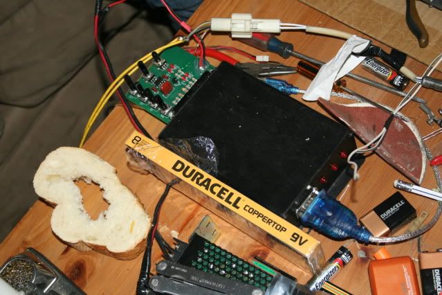

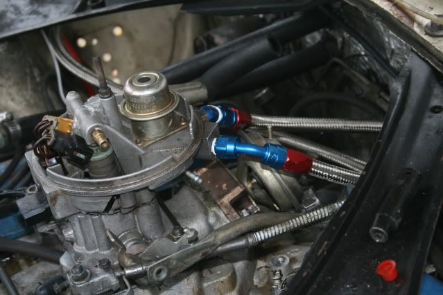

    $30 on eBay bought me this, with injectors that functioned (surprisingly) and dirty everything. Cleaned up with brake cleaner (didn't have carb cleaner at the time) off the engine, and I made a connector for the injector connector (black, on left) by cutting up a computer Molex connector. Mounted and hooked up now, AN fittings are rigged up in this photo.
    Dad's working on the injector wiring here.
    MegaSquirt computer with case bought from DIYautotune.com (I got SO much information from them about the whole project)[​IMG]\

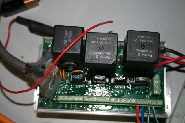

    Relay board, mounts in the engine compartment, connects to MegaSquirt computer through the firewall, controls injector banks and receives data from sensors.

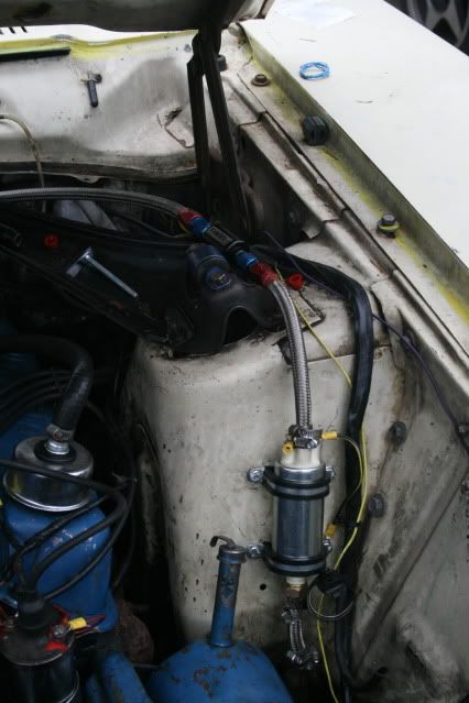

    Fuel pump and filter installed.

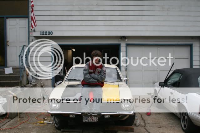

    Sitting on the spray-painted German flag hood I did myself with foglights and cheap black plastic passenger side mirror recently installed :D Once the MegaSquirt is mounted and the O2 sensor is installed I will tune it and finally be able to drive to school in what my peers now know of as a "Ford Maverick", "boss car", "German flag hood", "that car with six horns" (I went overboard with my horn relay I installed and a bunch of horns I've collected), and "Muscle car". All of those names have been accumulated by people on Facebook that see photos I post :yup:

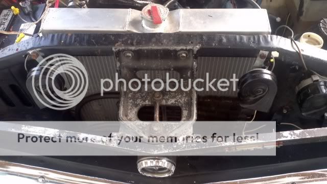

    Interested in following the MS setup and operation. Got any pic's of the 6 horn setup? Im going to replace my horn w/ a new setup, probably a twin-dual tone setup.

    Here are a few pictures: [​IMG]
    The wiring isn't hidden so well, but it will be when the weather is warmer. I am also going to make the brackets for the twin horns in front of the radiator longer because hood prop clearance is very close. Also the relay is mounted where the green and red wire leads between the radiator and overflow reservoir.
