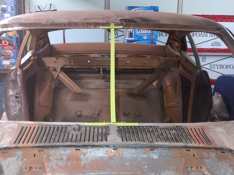

    This is my 1971 Grabber that I purchased in the early fall of 2012.
    It has 20,000 miles on it and I plan on keeping it as true to original/stock as possible. After getting the car home and driving it for a bit, I noticed that I had some cowl issues.
    I started to disassemble the car in February 2013 to fix the cowl and anything else I found along the way.
    The first thing I did was remove the windshield, as I also had some bubbling happening under the vinyl roof.
    Next, the interior came out. The floor pans are in great shape, but I'm glad I'm fixing this cowl issue NOW, rather than later.
    I removed the heater box and dash. I will treat and paint the whole inside of the interior to prevent any further damage in the future.
    This is the passenger side cowl area. My heater box has been taking on water for some time. The dampers are rusted shut.
