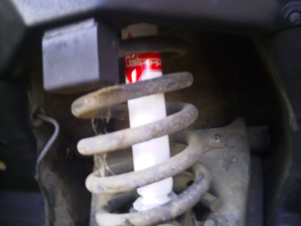

    Step 2: remove shocks
    remove the top 2 bolts on the shock then unbolt the other brackets (not sure what they're called)
    Step 3 remove the 2 lower shock bolts
    Step 4 remove the shock
    Step 5 put the bushings on the shock and install
    if you are just replacing the shock do the reverse of this with you're new shock and your done im continuing for the spring replacement

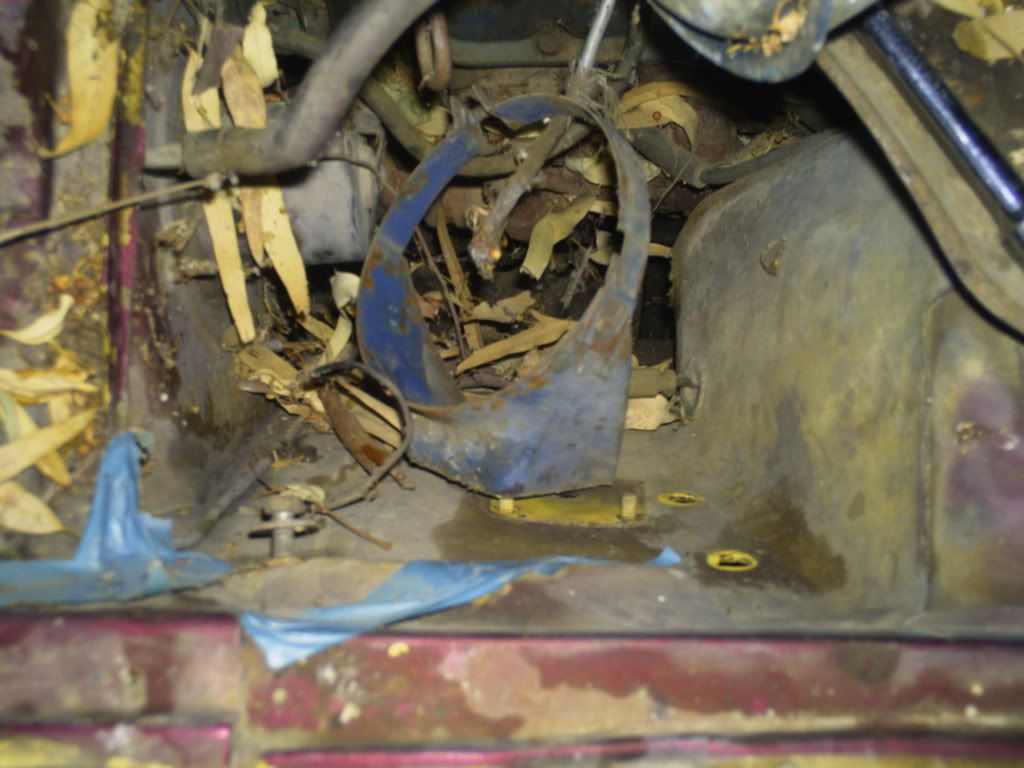

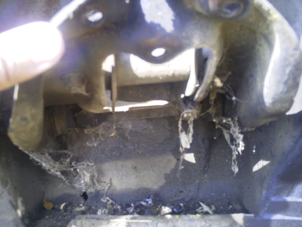

    Step 1 unbolt the charcoal can (if applicable) it makes step 2 possible
    Step 2 remove the outer spring cover (that's what i'm calling it)

    i did not install the new shock i just dropped it in the for illustration purposes.. also my new one is about an inch shorter than the one it had on it any suggestions?

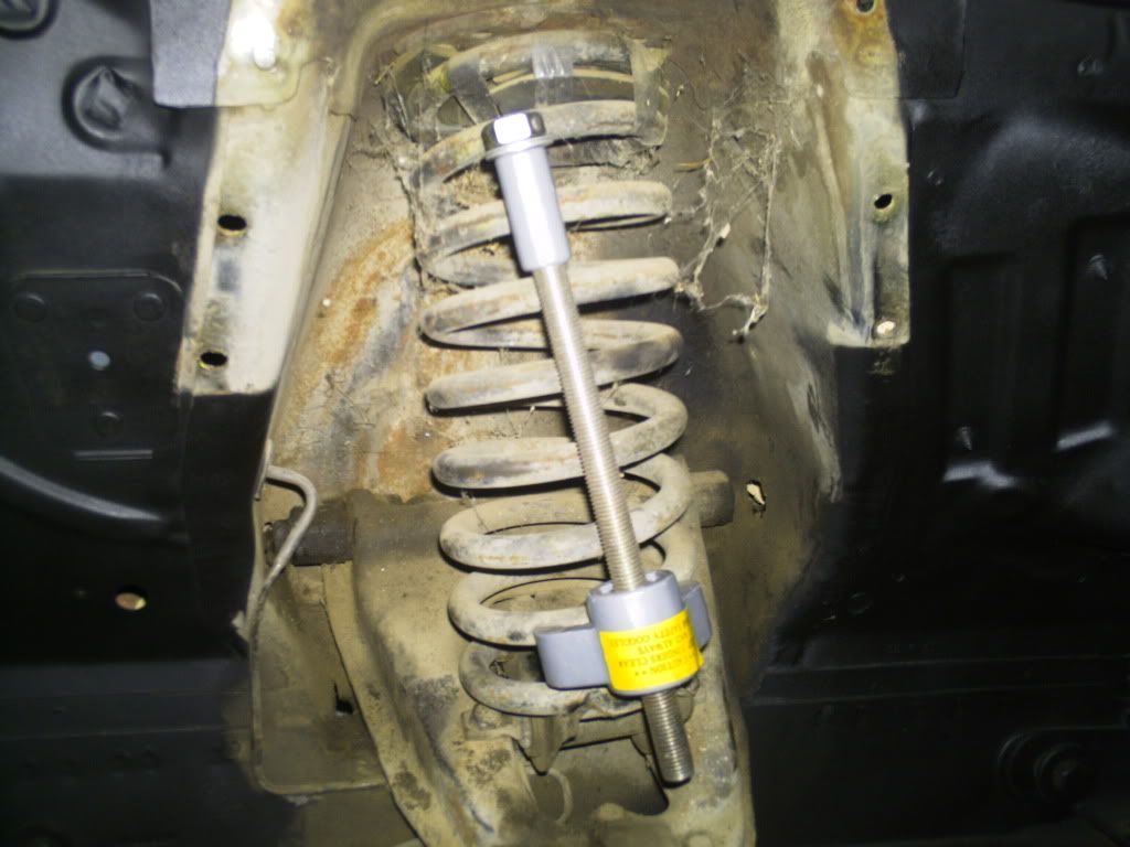

  6. mavgrab302
    I built my own coil spring tool, I tried both of the part store tools and dang near killed myself.... I built one that mounts where the shock mounts and works great... Takes a few minutes to set up but its safe and easy to use....Here's a link to what I built.
    http://home.bresnan.net/~dazed/spring

    Was this done on a junk yard car?
    :D Just looking at all the leaves, cobwebs, etc in the engine compartment.

    unfortunately no the hood was taken off my car and it sat under a nice big eucalyptus tree. i also forgot to put the fender removal. i already had the fender off mine so ill take pics when putting it back on

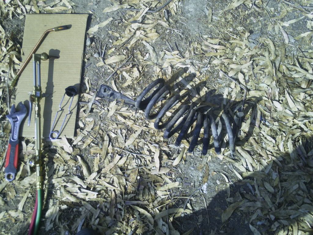

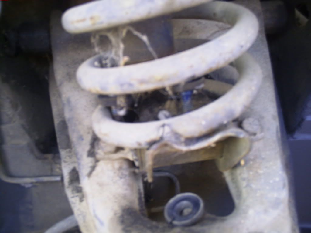

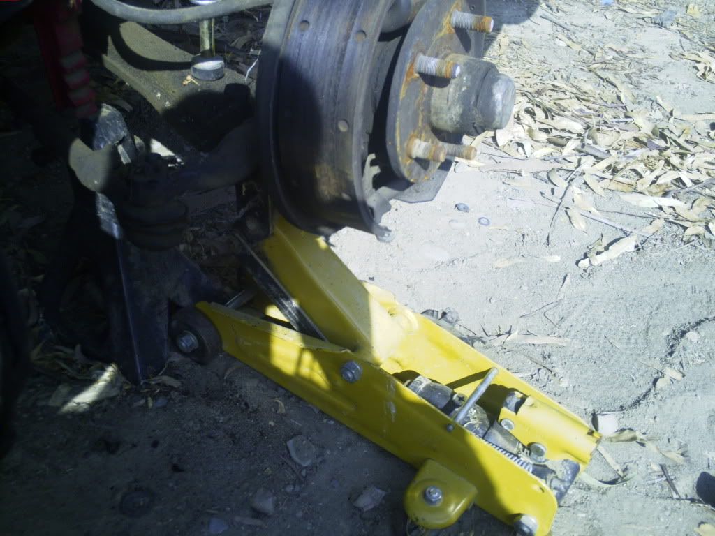

    removed the spring today used a torch (don't use a torch if you want to reuse the spring)
    compressed the coil slightly with a jack
    started heating with a torch let down the jack and hit it with a hammer fell right out
    coil removal complete

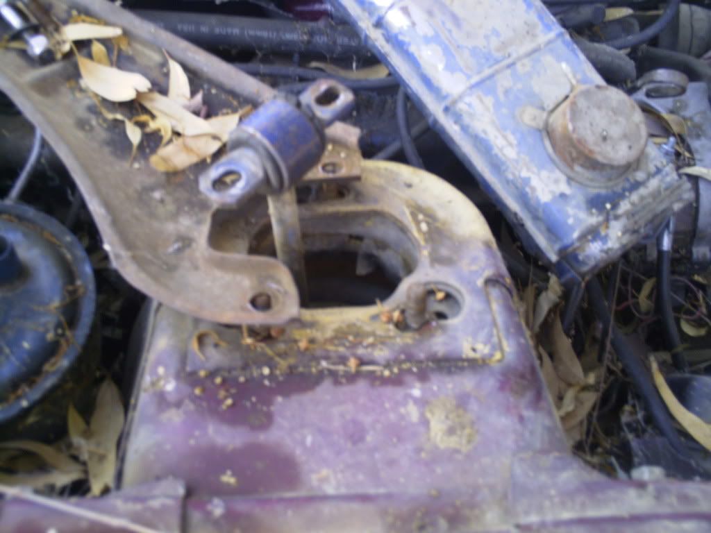

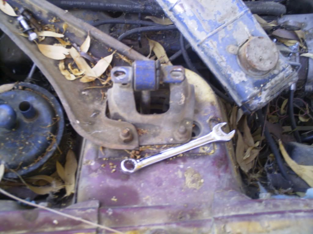

    Upper control arm removal
    unbolt these 3 bolts

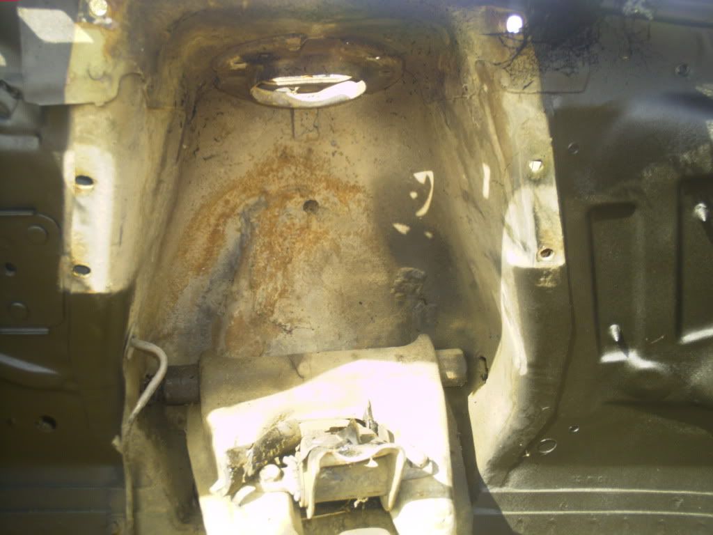

    once they are removed you can lift up the control arm to reveal this
    these bolts go through the fender into the engine compartment. to make this easier you can remove the spark plug wire that get in the way. if you plan on putting in headers now is a great time to get shorter bolts.

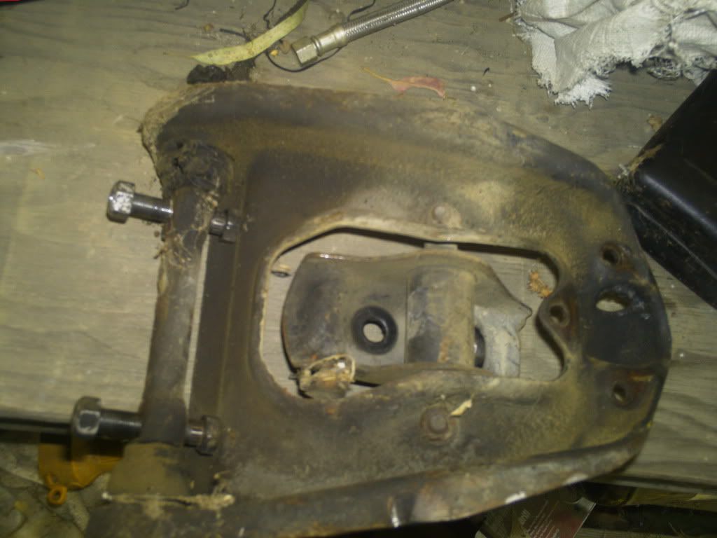

    now that you've removed the control arm you can replace the bushings (i didn't order the upper bushings but they're on my next order)
    to replace the bushings you need to remove the end caps from the rod (they come off pretty easily i used an 1 1/4 wrench)

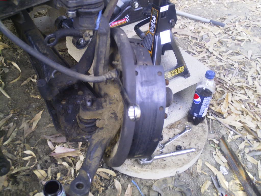

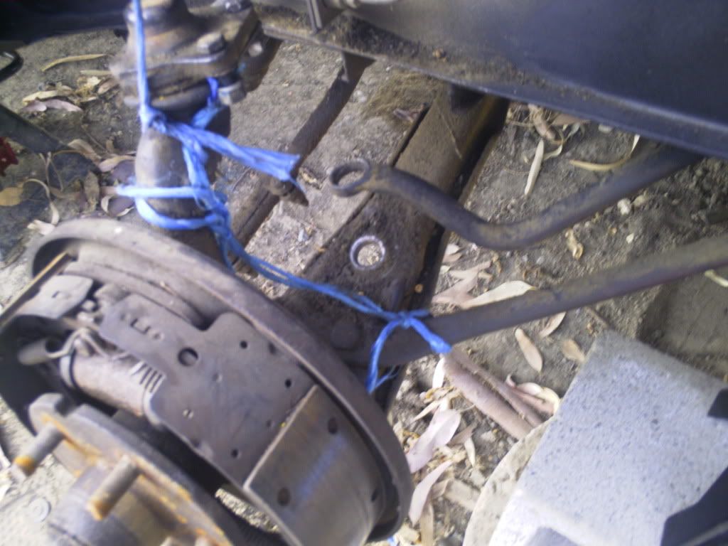

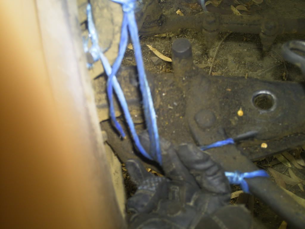

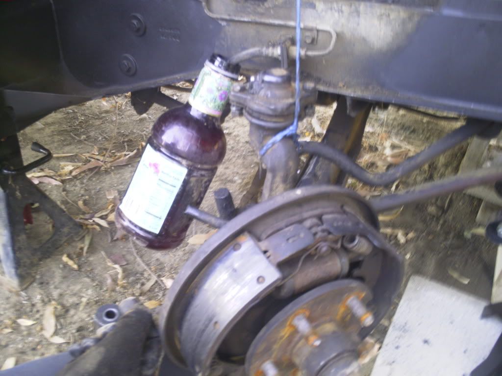

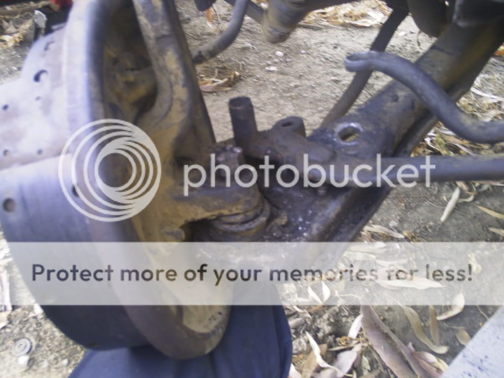

    lower control arm (i tied up the brakes to keep them from pulling on the line)

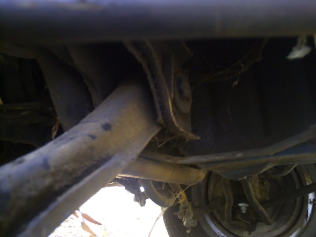

    remove your sway bar bolt
    then remove this bar (it goes to the front of the car)

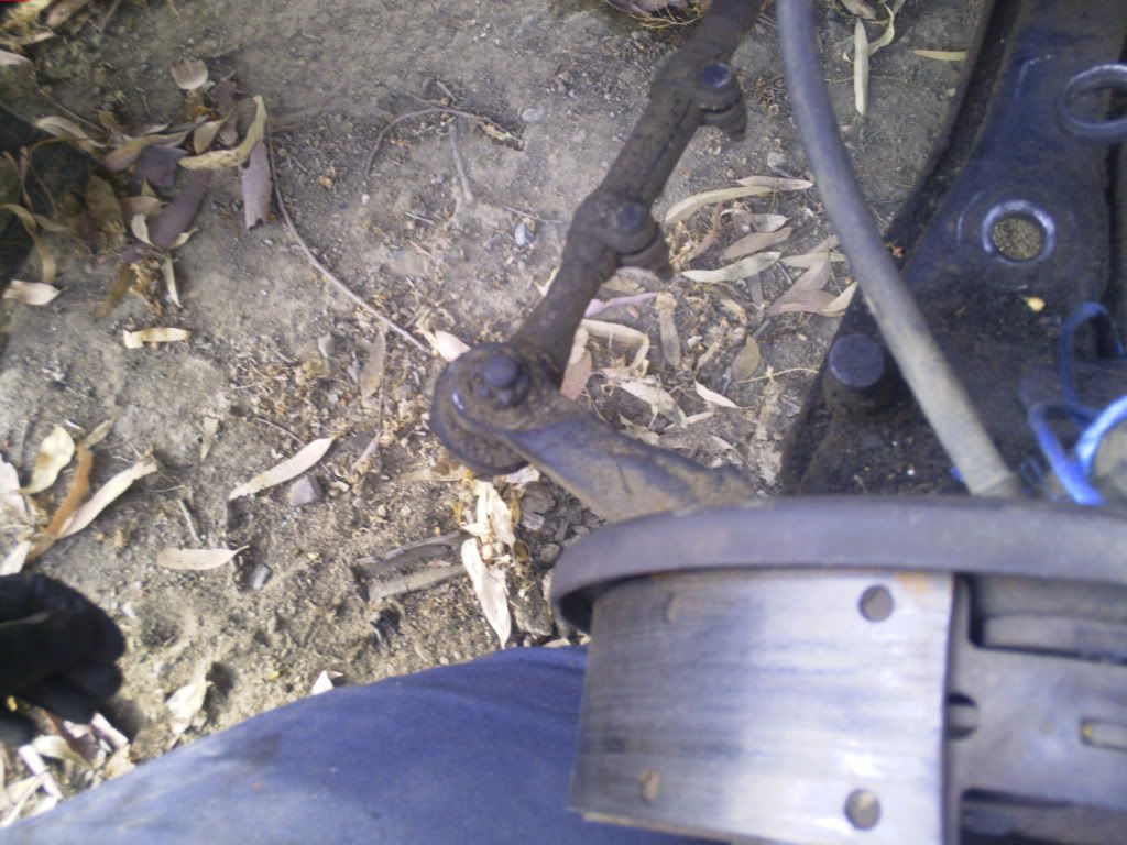

    first you have to remove the 2 cotter pins and loosen the nuts. this is hard to separate from the LCA(lower control arm) due to the fact that these bolts have teeth that grab the metal i managed to free by holding the bar and smacking the LCA with a hammer, rubber mallet recommended or any lighter means
    then remove the ball joint
    remove the cotter puns then remove the castle nut i threaded the castle nut back on and hammered on it till the ball joint came free. removed the nut and removed it the rest of the way.

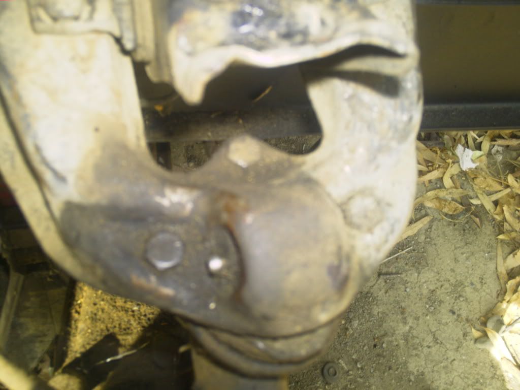

    next you can remove the brake from the LCA i was unable to and was also unable to free the brake lines from the fittings (i cut the line) NOT recommended I'm replacing the front drums with disk brakes off a 69 Thunderbird so i dint mind i was planing on replacing the lines anyway
    remove this bolt
    this is where i ended today as i was tired of getting bit by ants, and just flat out tired

    I am not sure where you used the torch, but those springs are done for. :huh:. One thing to do is find a repair manual somewhere. If your parts store doesn't have one, try the local library and take photocopies. It will make the job alot easier and safer. Remember, safety first!:tiphat:

    He was not planning on re-using the springs - his way is faster for garbage springs.
