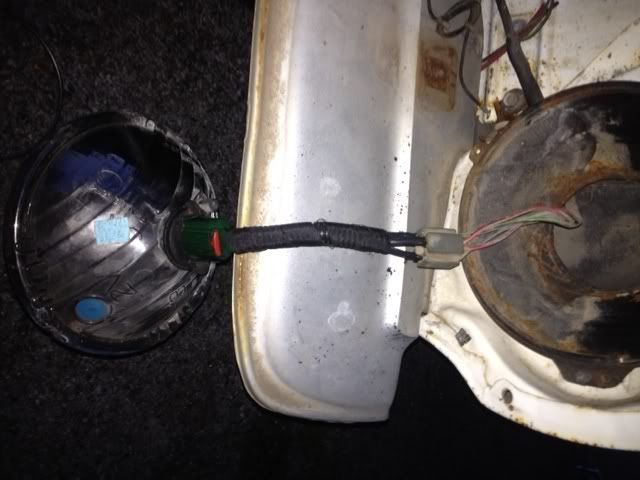

So, i've been keeping this to myself because my maverick wasnt going to be roadworthy for awhile. Sorry guys. Anyway, I work as a tech at our local Chrysler,Dodge,Jeep place and had my brain itching to try this out sooo.... I made it happen, turns out JK body wranglers 06 and up have something too offer us
short adapter harness from a mopar pigtail. A relay system is coming soon from all the spares I have from pt cruiser cooling fan failures
The bulbs in these are nice. These NEVER get moisture in them either.
All you have to do is make a pigtail to adapt the bulb then the thing bolts in like sealed beam YOU'RE WELCOME~!

The headlights with bulbs were 25 bucks on eBay, the pigtails were the most expensive at 15 a piece. Considering the huge improvement, Id say it's worth it. Still cheaper and much nicer than ANY aftermarket models

JK body is 06 and up. The bulbs are a 9008 I think but I will verify it tomorrow. The shape is neat too, it's a bit more round than typical stocks or replacements

No, composite rock resistant

They are factory pieces. I meant to get part numbers today but some stuff came up I wasn't expecting. I'll get them in the morning ASAP!
