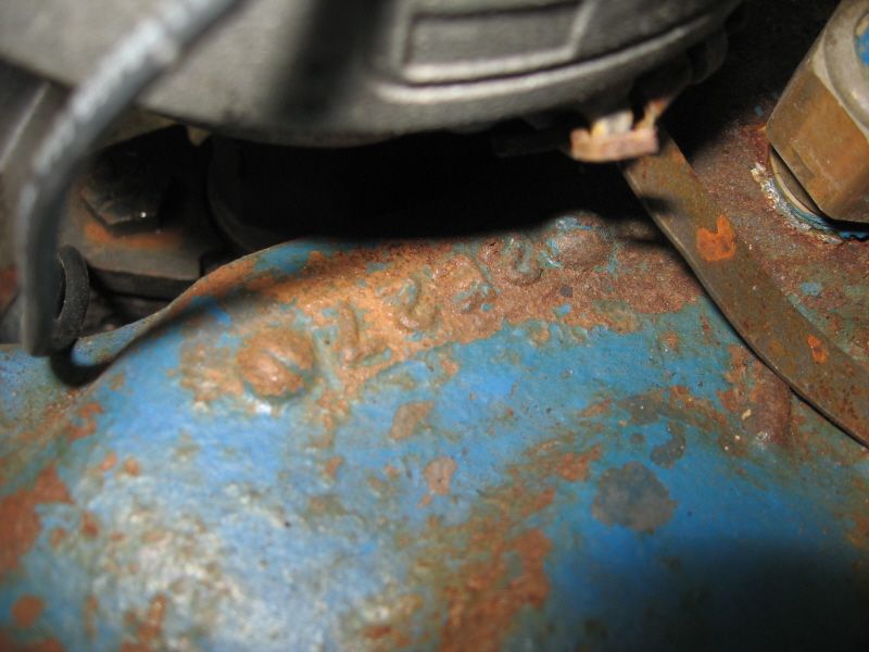

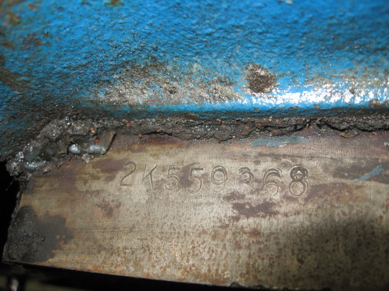

    First off, top of the block behind intake manifold, eight digit number that first two are year & assembly plant of vehicle, last six are consecutive unit(basically number sequence as orders are received at assembly plant)
    Note there may be a full VIN of 11 digits but in either case the original engine will match the vehicle VIN... Mine does match but looks like the stamper had the DTs...
    http://i1358.photobucket.com/albums/q765/xxAMxx/Comet/cometblockvin_zps7f4c2a8b.jpg
    At this point the block, heads, intake etc can be checked for proper date codes to check for their originality... Since correct VIN is on block, no doubts there, still finding casting dates can prove interesting...

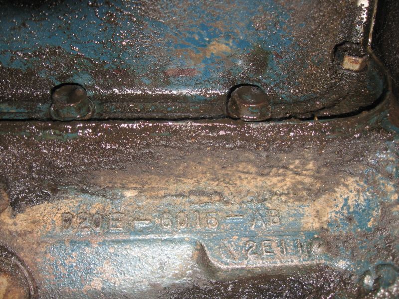

    First off block casting date is 2E11 or May 11 1972... Build date for my car is June 23 1972, cast date is approx six weeks prior...

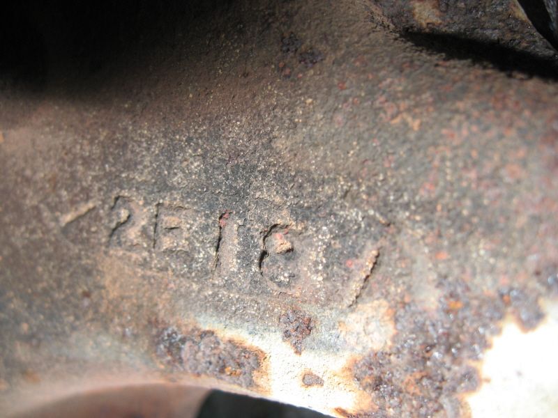

    Passenger side exhaust manifold cast 2E18 or May 18 1972
    http://i1358.photobucket.com/albums/q765/xxAMxx/Comet/cometmanifold_zps0a728b6b.jpg

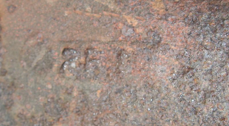

    Driver side date is pretty much illegible but it's 2E something, there is a large space between the E and last digit I suspect it's rusted away...
    http://i1358.photobucket.com/albums/q765/xxAMxx/Comet/cometmanifold2_zpsd3550ecd.jpg

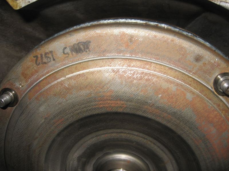

    Also found a date of June 5 1972 on the torque converter and I already knew the transmission ID stamp matched the one on engine so it's also original(I saw that stamp when Brian had the trans out for rebuild)
    http://i1358.photobucket.com/albums/q765/xxAMxx/Comet/cometconverter_zps6661beb8.jpg
