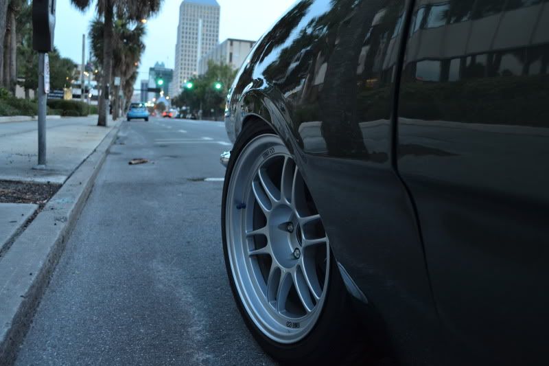

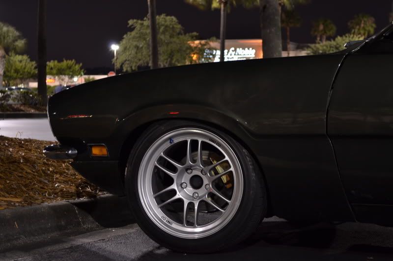

    something about the big hole in the center of the rim that doesn't do it for me...:disagree:

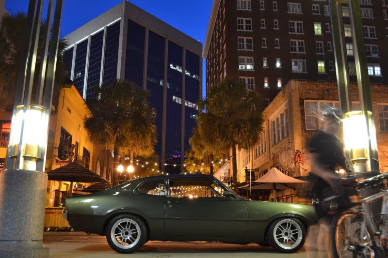

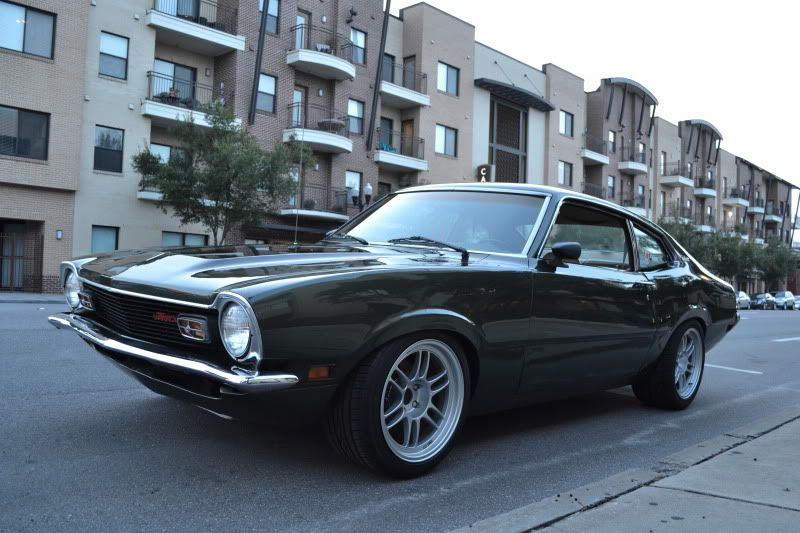

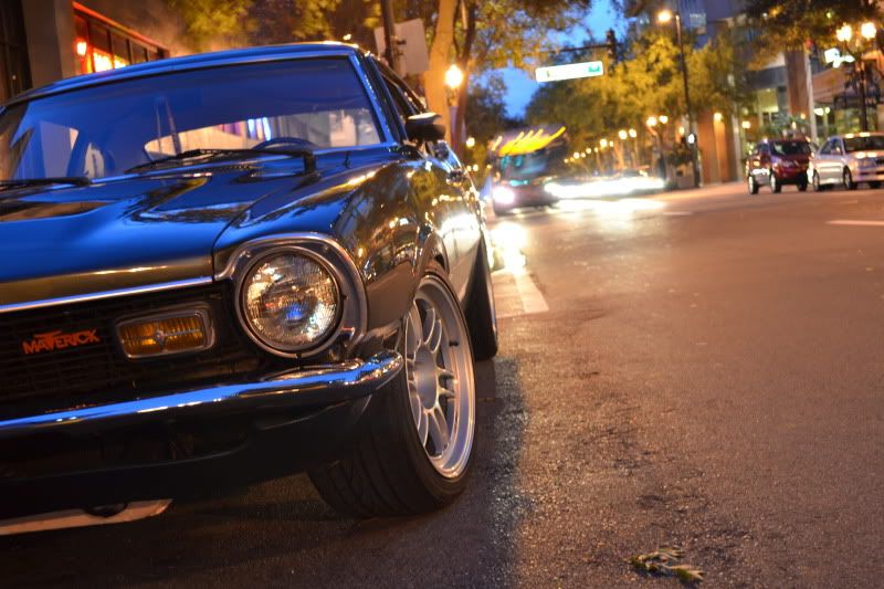

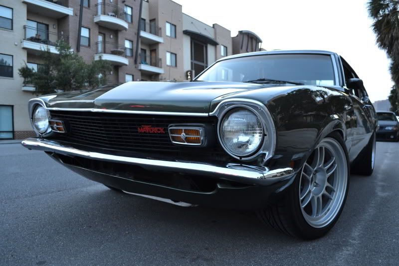

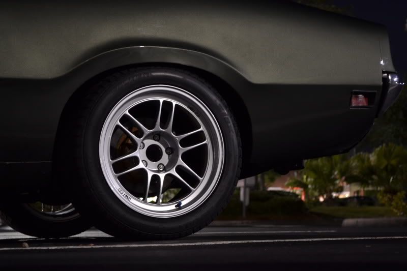

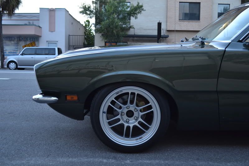

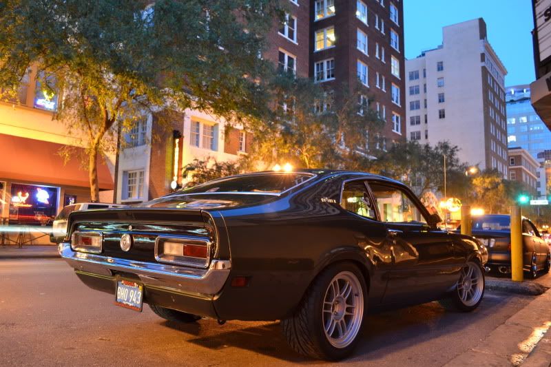

    Man, this is an awesome looking stance on this maverick, would like my comet one day to look like that, awesome!
