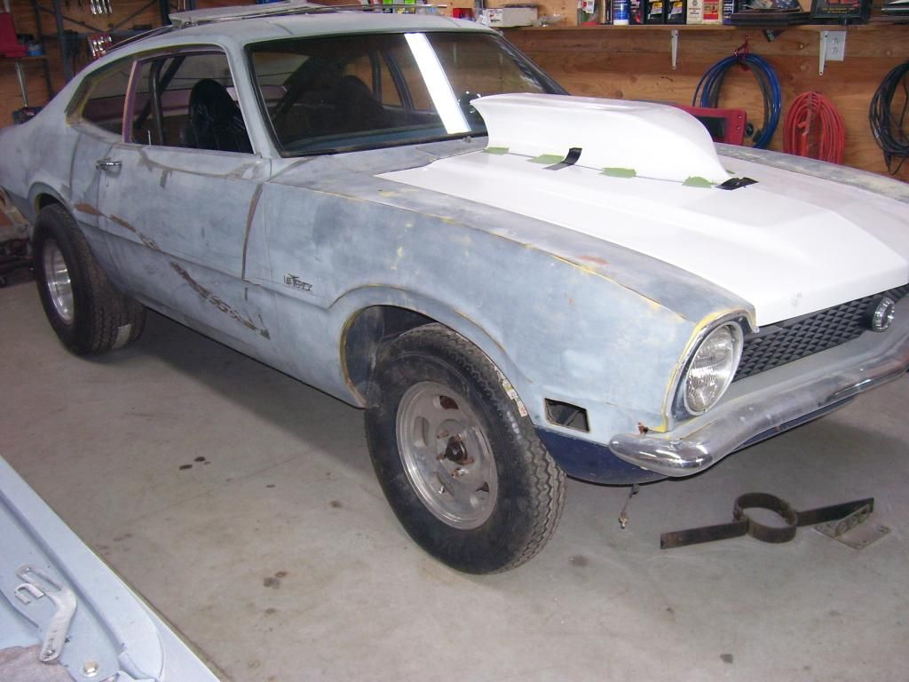

    Got it mounted this afternoon, will look better once it's moved out 3 inches or so with the tower narrowing project.

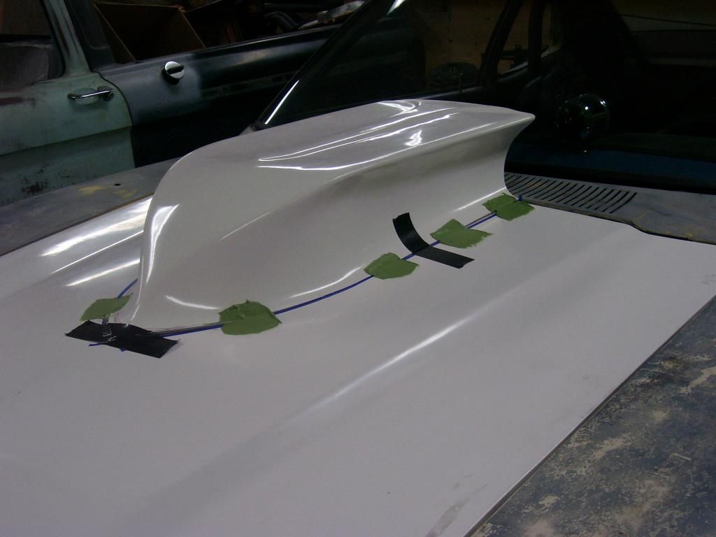

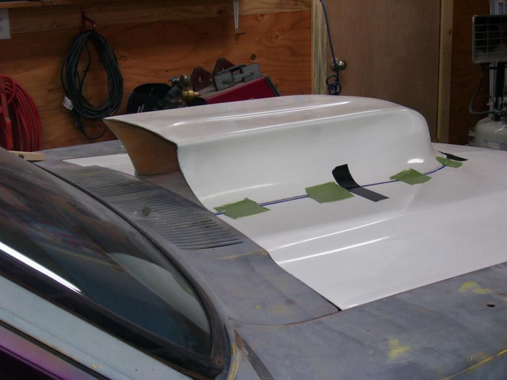

    Also got started on the fiberglass scoop mounted to the fiberglass hood. Got everything cut to shape, extra trimmed from the scoop and hole cut in the hood. This is the first phase, sticking the hood where I want it. The globs of putty will be chipped off after the scoop is glassed in from the inside.
    Tomorrow we glass the scoop to the hood and get ready for the outer bond and body work to blend it in.
