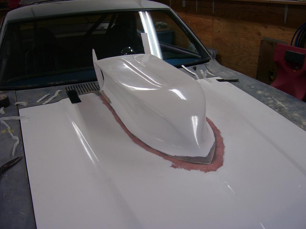

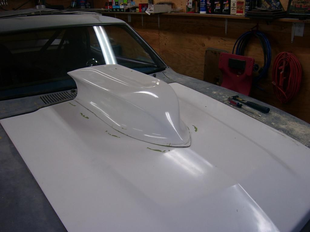

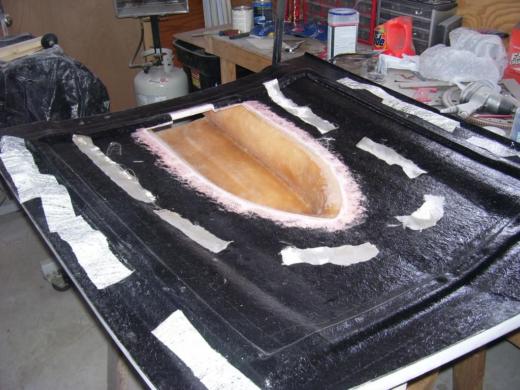

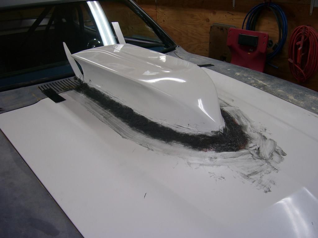

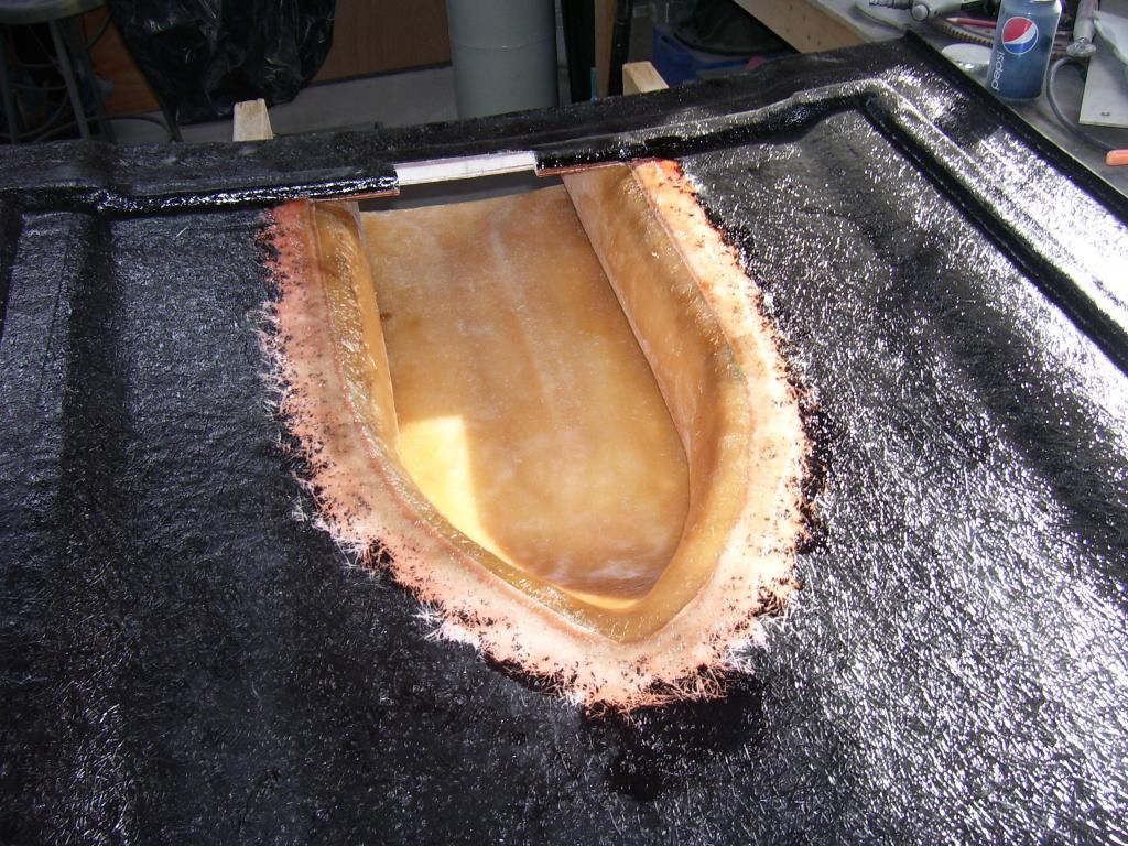

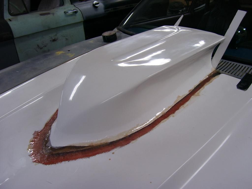

    Got the scoop glassed in place from the bottom. put it upside down on a pair of saw horses and ground the edge of the hole to an exact fit for the inside of the scoop. Then used 1 layer of woven glass and 1 layer of chopped mat to bond the scoop to the hood.
    Let it sit a couple days and flipped it over. Chipped off the putty holding it in place then ground down the edge of the scoop and roughed up the outside for a good bond.
    Used 2 layers of chopped glass mat on the outside so the hood matched the edge of the scoop better and started building the radius up.
    Next I used long strand fiberglass to further blend the scoop. This is where it will end until more body work is done. Hood and scoop are strong and solid. Was careful to keep the contour of the hood while doing the glass work so I didn't build any warps into it.
