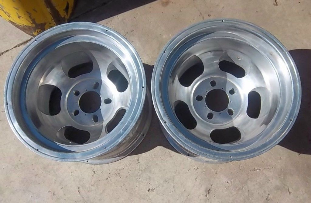

    Here's a few pics. The wheels currently on the car are just rollers, the new wheels are Fenton Gyro 15x11. If you have a set of 15x3.5 Fentons drilled in a Ford pattern, let me know because I'm shopping! The engine is a core 351W. The tranny tunnel has been enlarged to fit a C6 (car has a C4 in it right now). Not crazy about the Cougar taillights and considering replacing them with the stock tail panel and Mav lights.
    I'm probably going with a top loader. Researching a cable or hydraulic setup for the clutch. Either seem like less hassle than stock.
    Doing some measuring and research on the early Pro Stocks for tower modifications.
    Spent some time today going thru everything. Have all the trim and pieces needed. Now I need to get to work!
