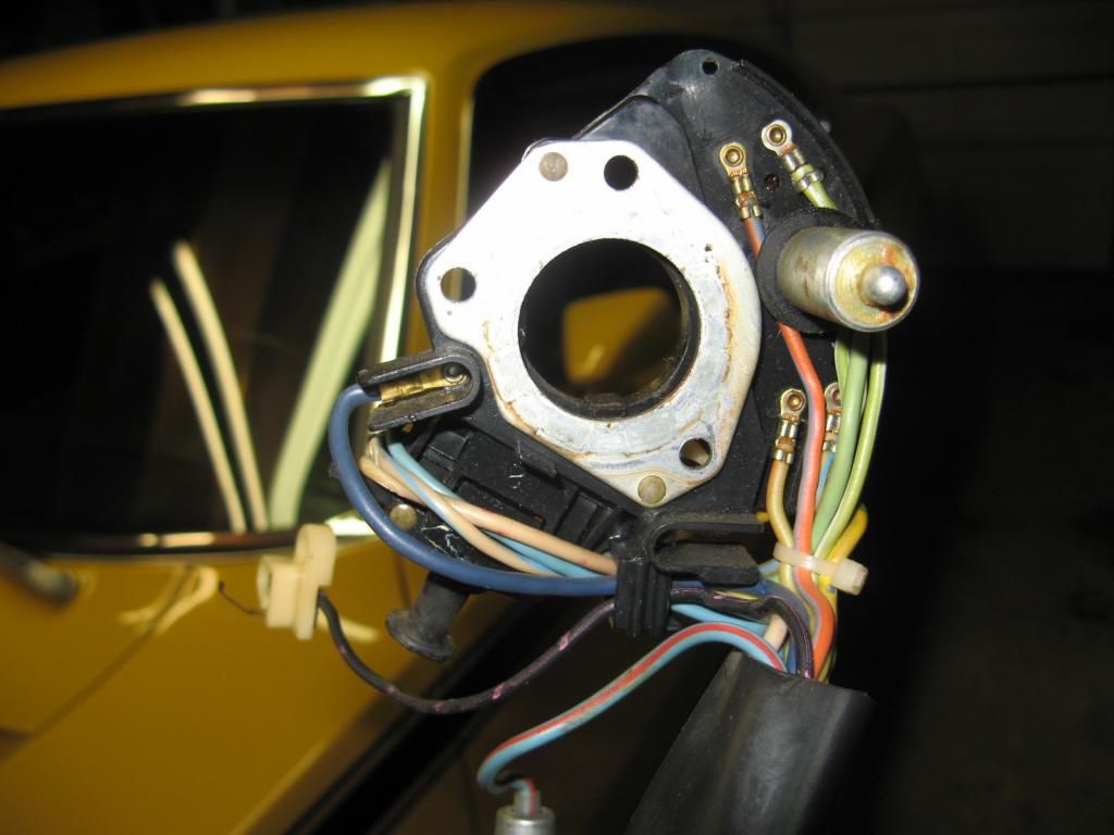

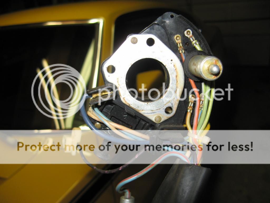

  3. jski
    jski Member
    Oct 14, 2012
    72
    Moyock, North Carolina
    1972
    image.jpg ThiS is where the turn sig bolts to. The shaft and bearing sit under this.

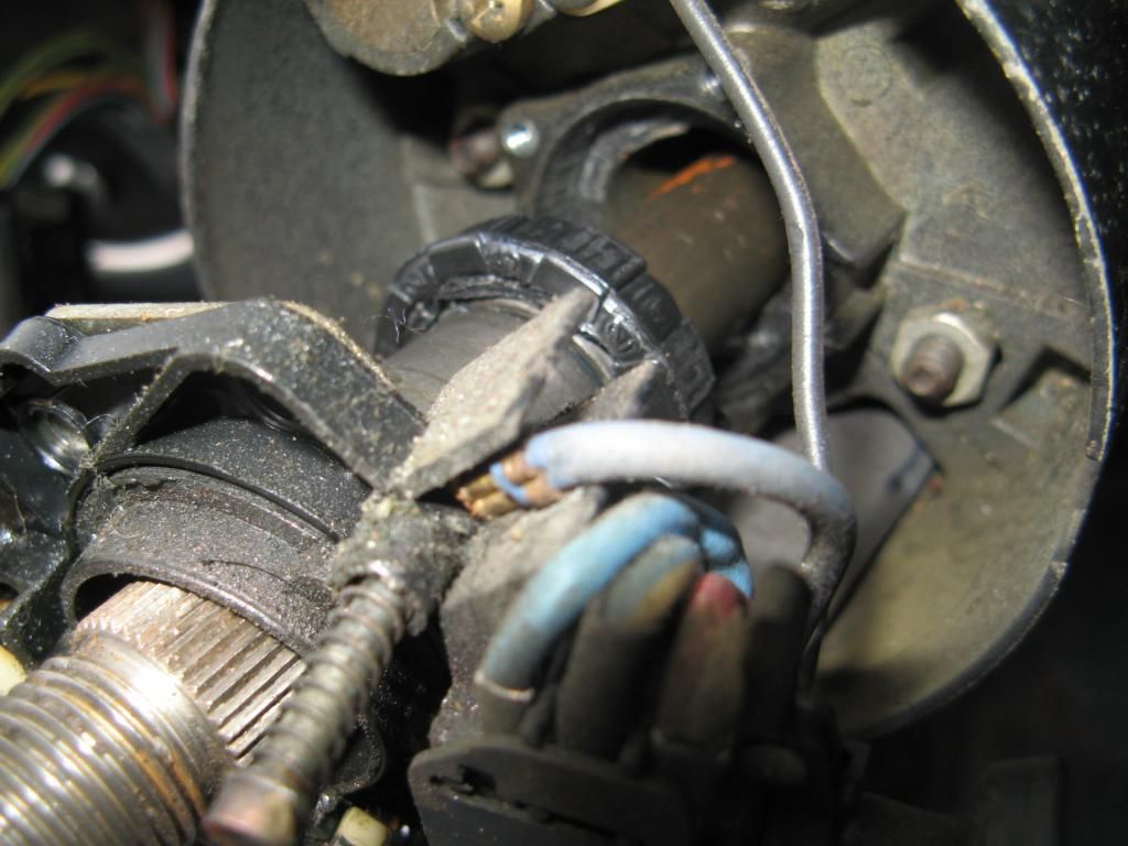

  4. jski
    jski Member
    Oct 14, 2012
    72
    1972
    This is the man shift collar that I cut the outer "nub" off.

  7. Krazy Comet
    7,797
    2,483
    That column is apparently different from the exploded view, it shows the bearing(3517) & sleeve(3518) in upper portion like the locking versions...
    EDIT
    I looked at the 68-69 Ford, Fairlane & Mustang columns, all are like the illustration, you're apparently assembling it wrong... Shaft with bearing goes in after the collar and upper is assembled, or is assembled with shaft but no bearing... Bearing must be on top side...

    There are two bolts that kind of resemble connecting rod bolts that go through metal collar that the turn signal assy bolts to. The heads of these bots are designed to grab the slots on the outer part of the column that is stationary. With these properly in place you can not pull the assembly out. Kraft Comet is correct the shaft slides in and makes contact with a second shaft deep inside the column. The metal collar that the turn signal assy is bolted to go on after the rod and bearing this keeps the rod and bearing in place.
    Thanks to all that responded and hail to POLAND!!!!
