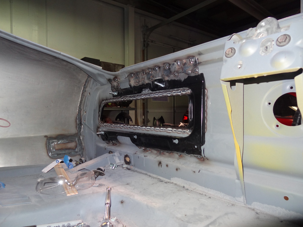

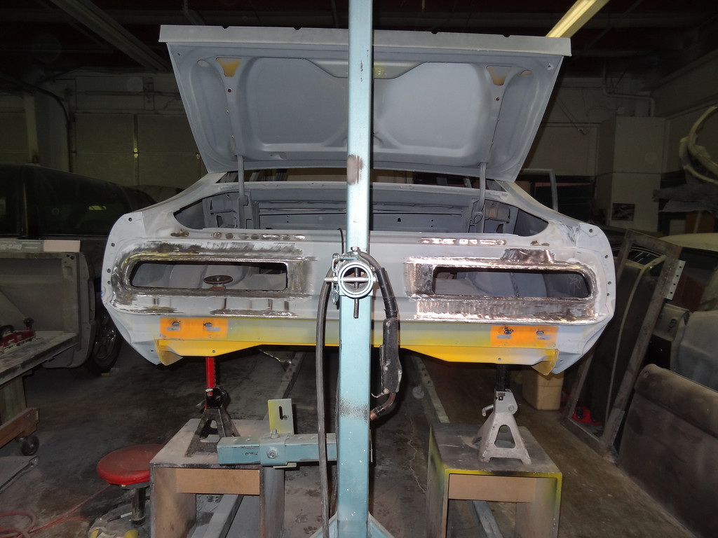

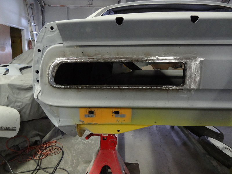

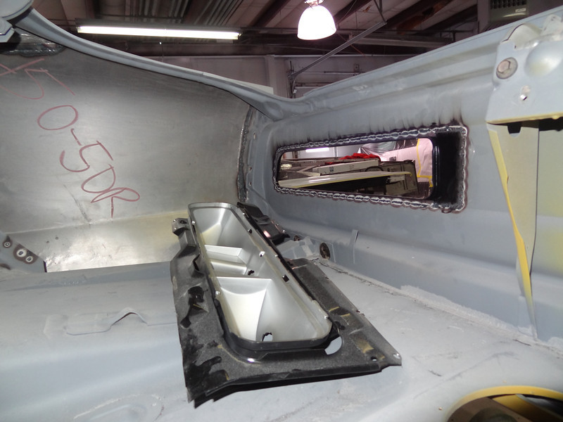

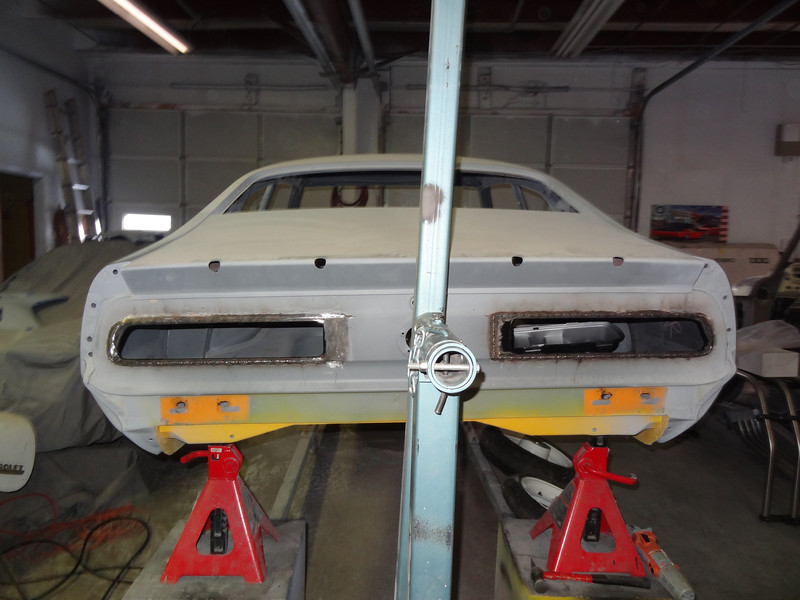

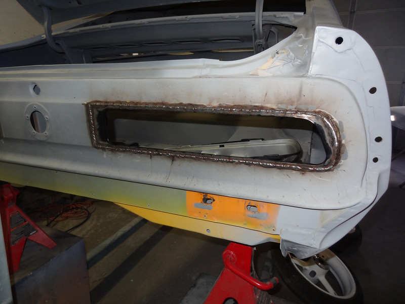

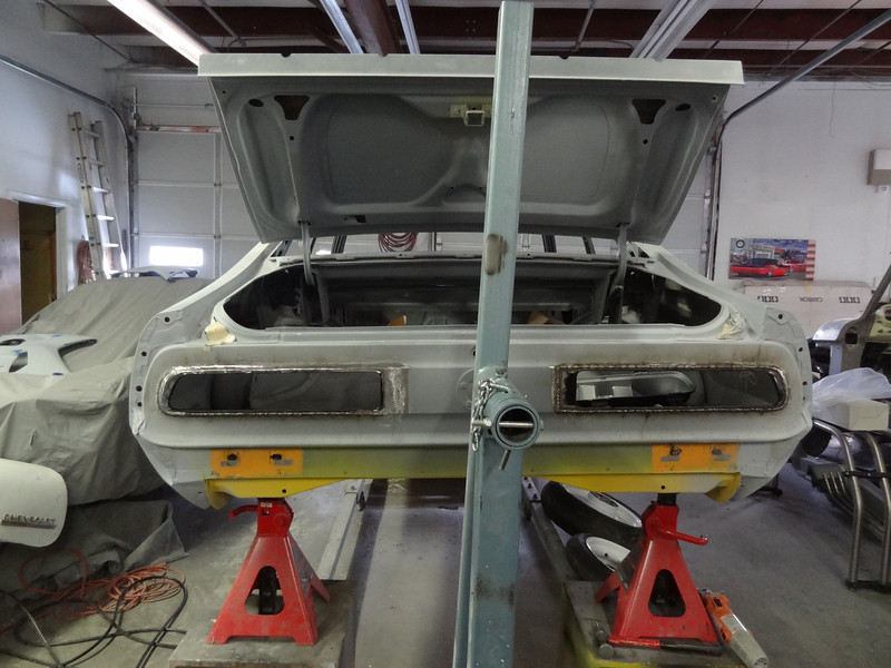

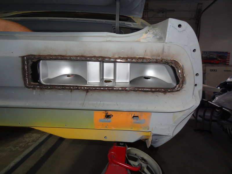

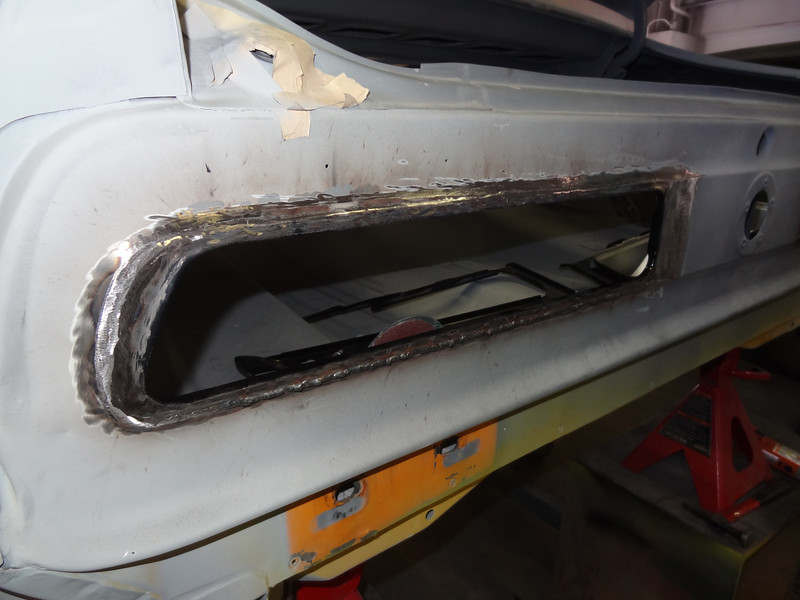

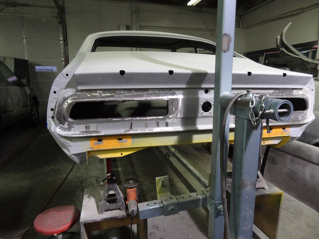

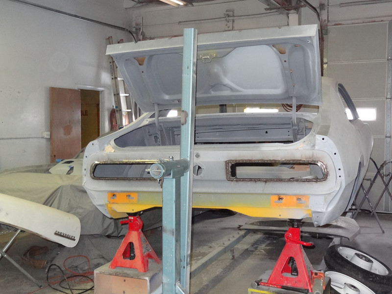

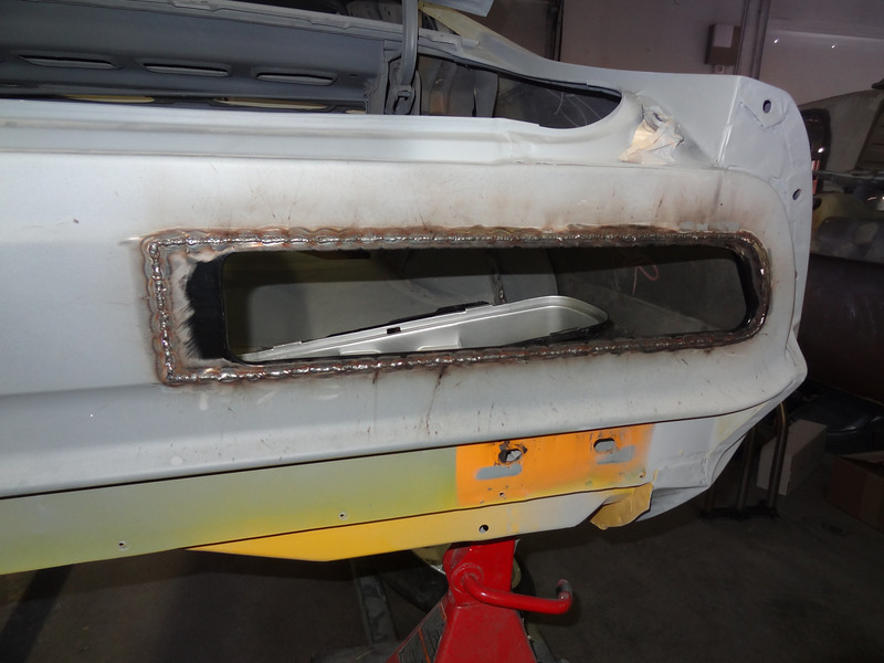

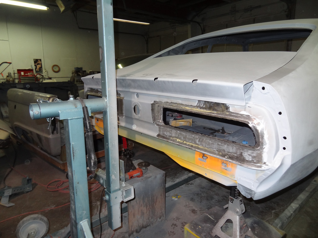

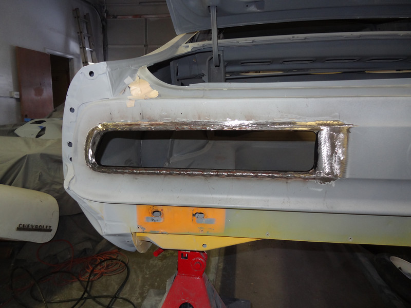

    The panels were trimmed up and fit in the cut outs on the rear tail light panel on the maverick.

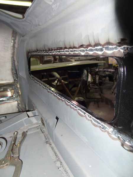

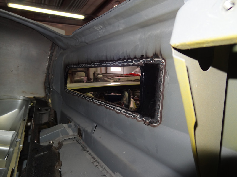

    The portions of the 69 camaro tail light panels were then welded in:
    Great penetration!!!

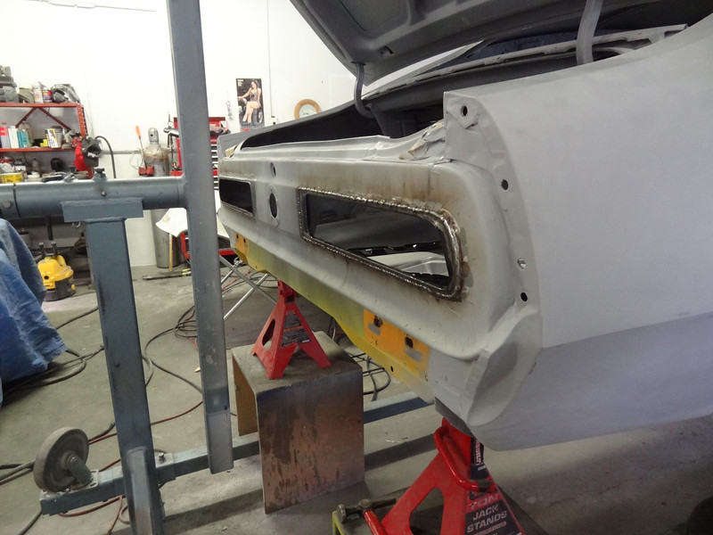

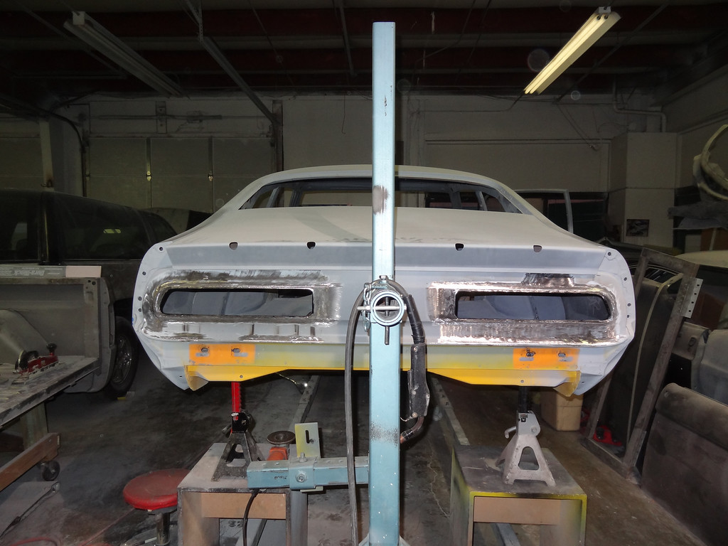

    Trunk closed:
    Tail light housing in place:

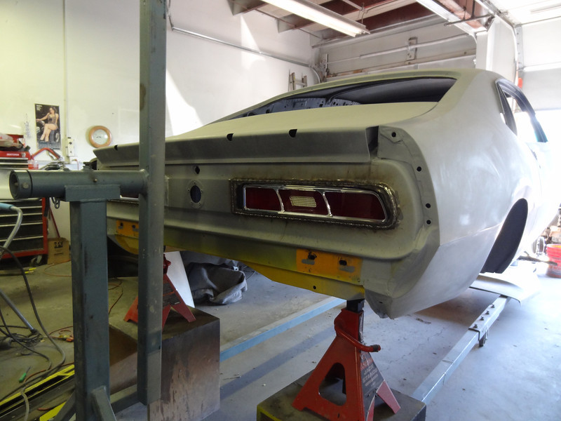

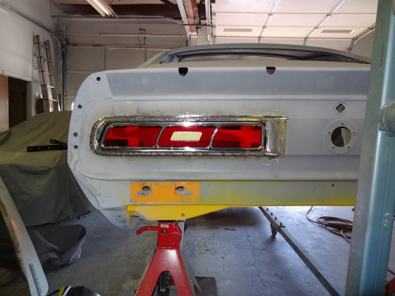

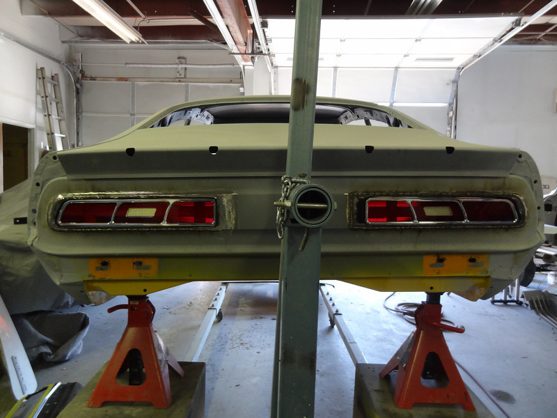

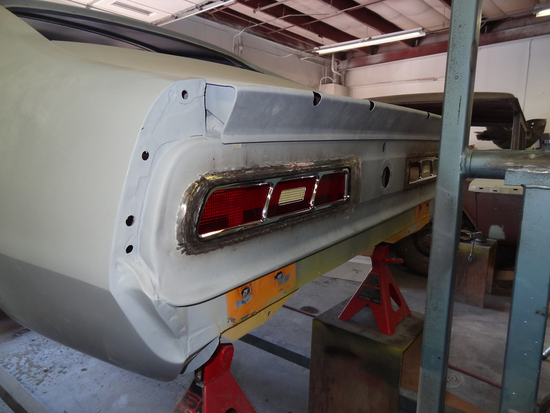

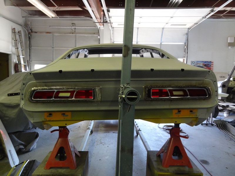

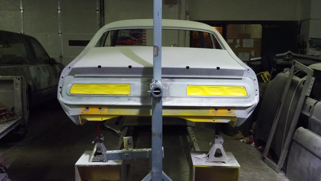

    I brought the tail lights down to the shop today and put them in place to see what they would look like when installed. Sorry for the tape that shows through the tail lights, but that is what I used to hold them in place.

    Sweet! they look like they belong, it's one of those modifications that just look natural.

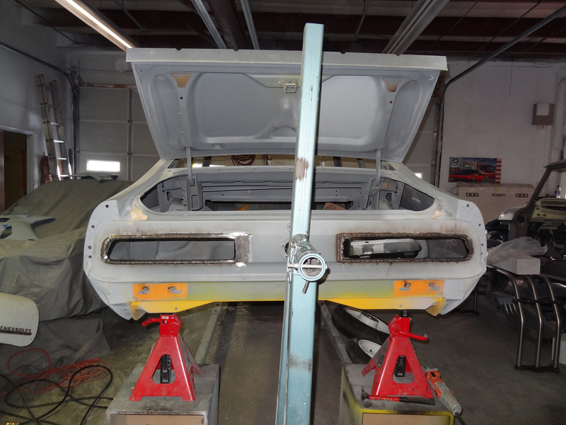

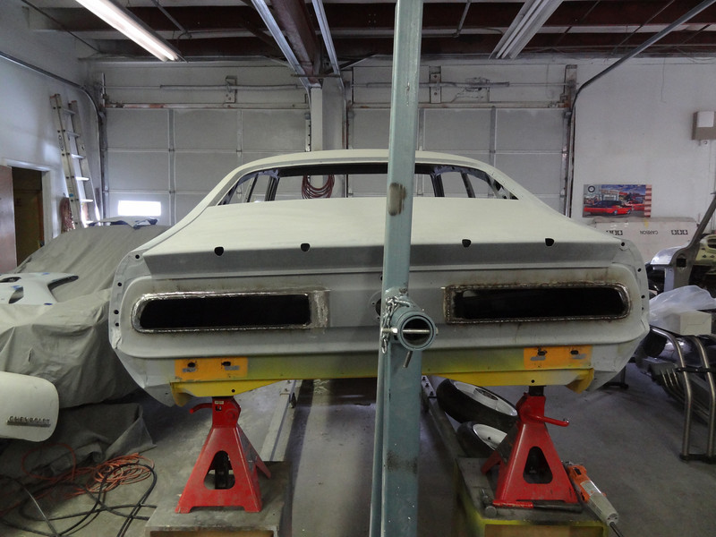

    I been out of town on business again and just got back. I am hoping that the maverick will be ready for paint in a couple of weeks.
    The goal is to get the body work on the hood finished up as well as the 3 valances and finish up the final blocking. Then get the seal coat shot.
    Then get the engine compartment and the bottom of the car painted. Once that is done we plan on getting suspension installed so we can roll it around.

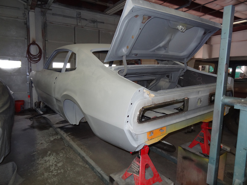

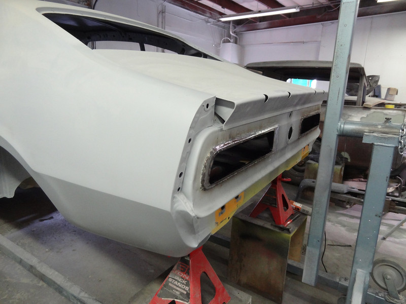

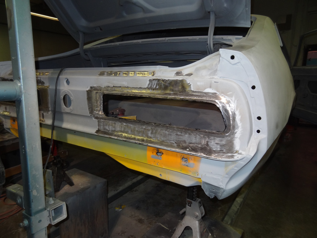

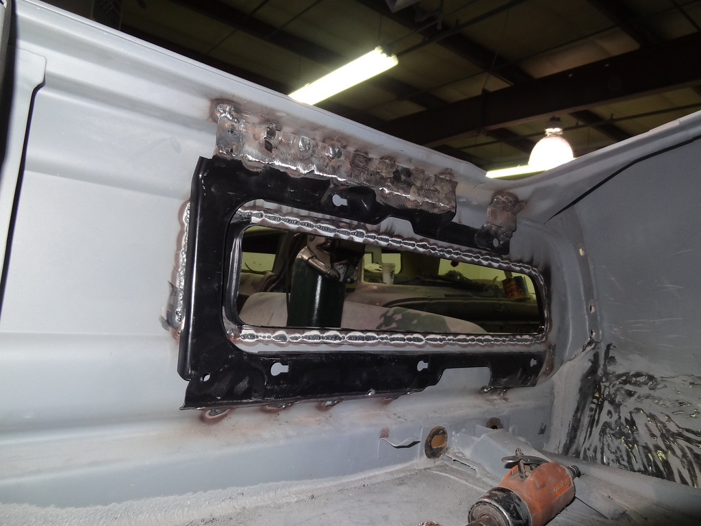

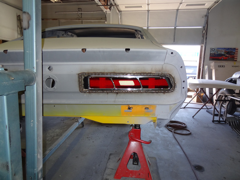

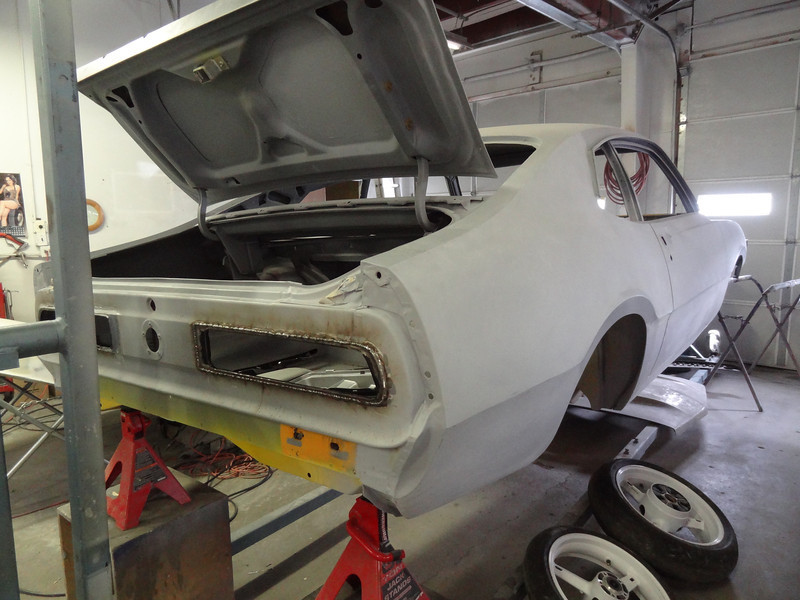

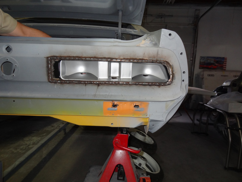

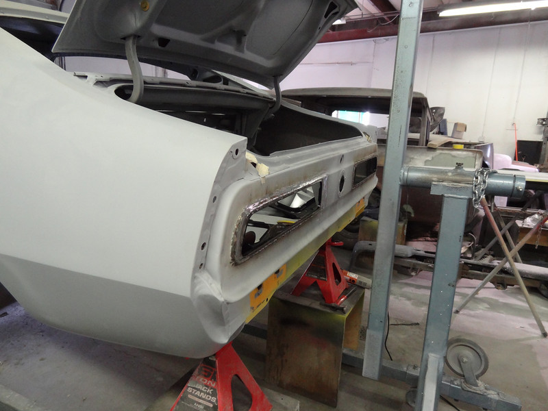

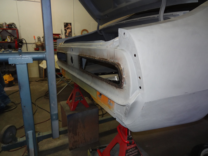

    The tail light panel is finally finished up. We took the brackets that was on the 1969 camaro tail panel and adapted them to work on the maverick so the tail lights will bolt in like they were stock.
    Here are a few pictures of the progress:
