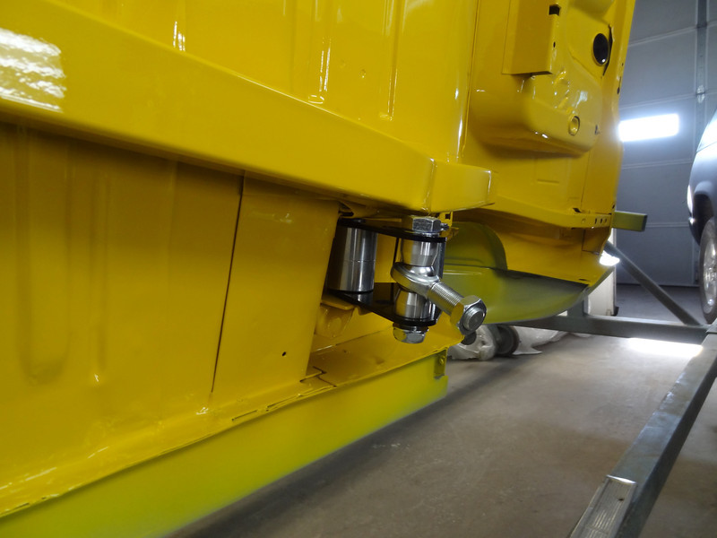

    Just wanted to let everyone know that it did fit and has enough clearance for the caltracs. You will need to mount it with the bolthead inboard but there is enough room for clearance. I will post pictures later tonight to show every how much room there is.

    Good news because all this talk had me worried.

    You and me both. Nothing like trying to make a decision whether to grind into fresh paint or not.

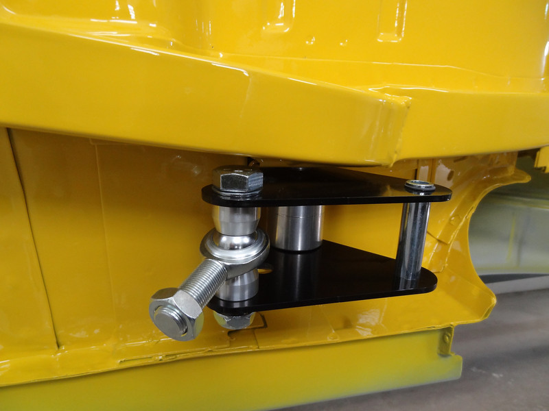

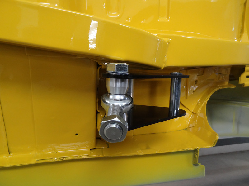

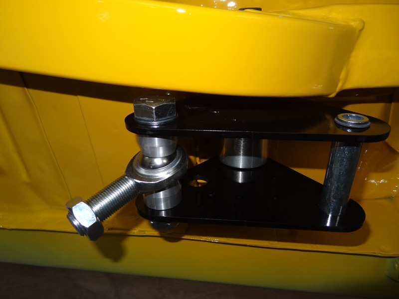

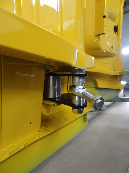

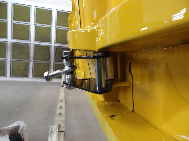

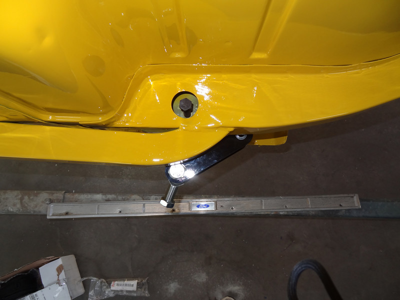

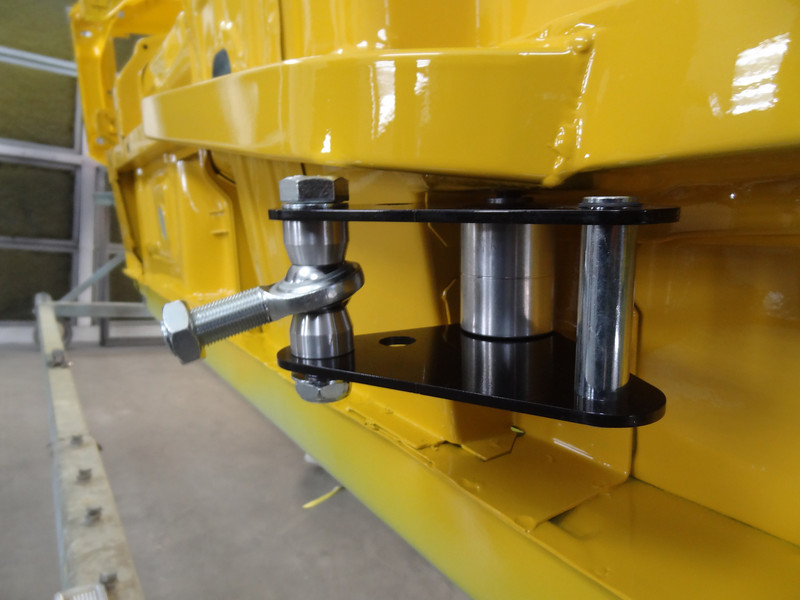

    Due to a potential issue that was brought up by a member about possible clearance issues with the caltracs traction system and the weld on subframe connectors, I went a did a trial fit and took some pictures.
    I was immediately concerned that I did not leave enough room by looking at the pictures I had taken of the bottom of the Maverick. From the feedback I received from other members that had installed the caltracs system we all figured it would be close.
    After taking the bracket portion of the set up and temporarily installing it, our hypothisis was correct and it was close but not as close as I thought. The good news was that if fit and it will work well. The only thing you will have to take into concideration is that you will more than likely have to install the lower traction arm heim at the lowest hole (Do not order the low profile plates, they will not work with this set up) and install the bolt with the bolt head from the inboard side of the bracket so it will clear the subframe connector.
    I also notice that there is enough space between the bracket and spacer to place a shim (washer) to move the assembled bracket inboard or outboard if needed.
    Here are some pictures of the bracket temporarily installed:
  13. mav1970
    Looks real sweet :yup:
  14. car-nut

  15. franktf
    franktf Member
    Nov 12, 2009
    4,119
    338
    206
    Pinellas Park, FL
    72 Mercury Comet
    Looks like it should work.....
