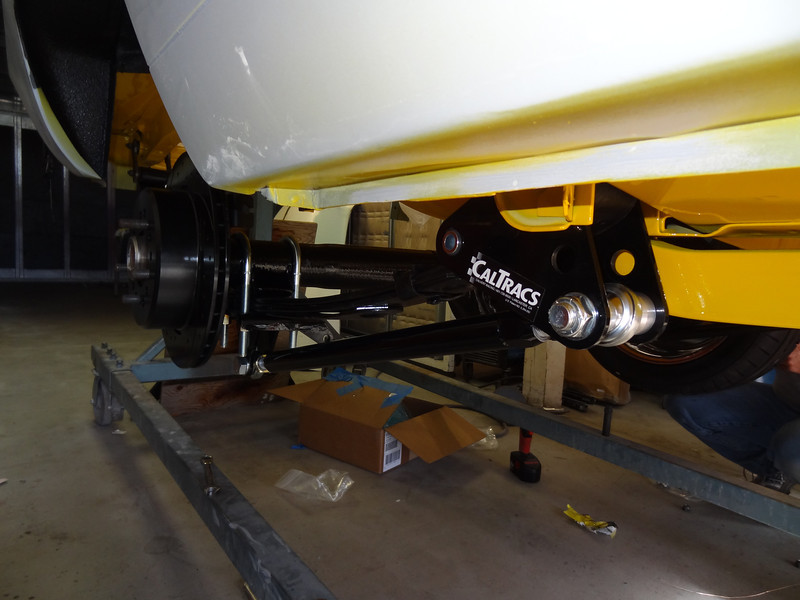

    I thought I would give everyone an update. I went to see the car today and there is now a very specific schedule in place. The car is going to be completed by the July 18th.
    Part of me is very excited and part of me is nervous because to me it seems like there is a lot of work to do in a short amount of time.
    I brought down the hardware for to install the fenders and hood, billet door strikers, and billet hood bumpers.
    The car is at the point were he is going to be wet sanded, sealed, and the final paint started.

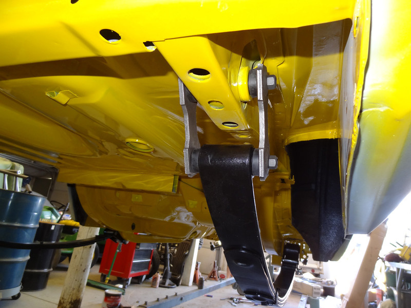

    I also want to post up the pictures of the installation of the suspension, brakes and the wheels.

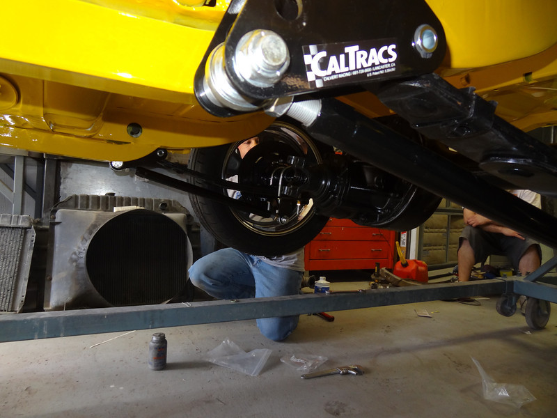

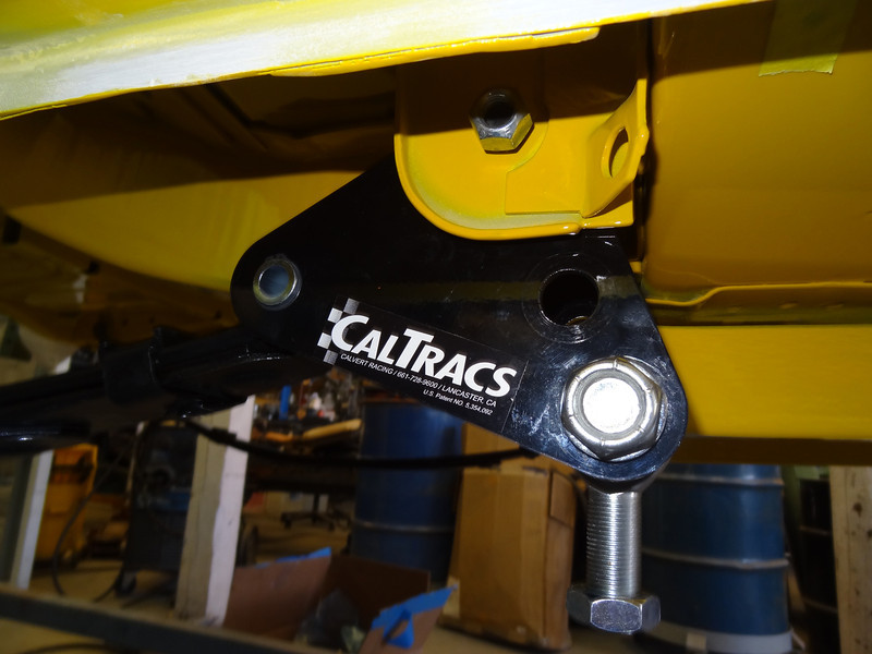

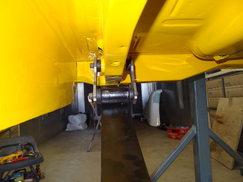

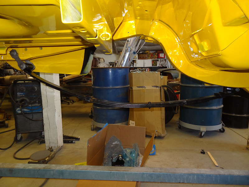

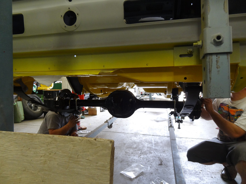

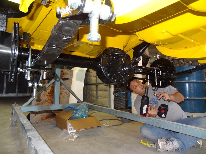

    First we started with the install of the rear suspension. I wanted to install the caltrac's set up at the same time as the rear leaf springs to assure that there is clearance with the welded in subframe connectors. The leaf springs were ordered from a company recommended from the site and I also ordered the 3 leaf set up versus the stiffer 4 leaf. The sad part is after installing them and sticking 200 lbs in the trunk and the height of the rear did not drop, I do not think I will be able to use them. The pictures that I will post up has a 245/45/17 tire and there is still 6 inches between the top of the tire and the bottom of the rear wheel well.
    The rearend is a narrowed 9 inch. It was narrowed to the same width as the stock 8 inch. The gear ratio in the positrac rearend is 3.89.

  12. Dave B
    Are the Cal Tracs loose? Or are they holding the rear up like that? I can't see how you could adjust them without the car being complete.
  13. Cruzin Illusion
    Cruzin Illusion Enigma
    Feb 3, 2008
    1,133
    Commerce City, Colorado
    1972 Grabber
    They are loose. That is why I think the leafs are wrong in some way. I will post up pictures shortly of the car on the ground.
  14. Dave B
    Take the bar out, and see if anything changes. They will actually hold the rear of the car up, in the instructions,they warn about this.
  15. mav1970
    I know all springs settle after a while of full weight sitting on them - do you think you might be OK after everything settles?
