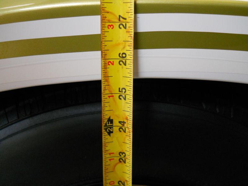

    Mine measures at 31 3/4 inches. My tire diameter is 25.68 inches. That leaves more than a 6 inch gap.

    There's something wrong with those springs, and they won't settle to a reasonable height.

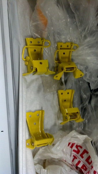

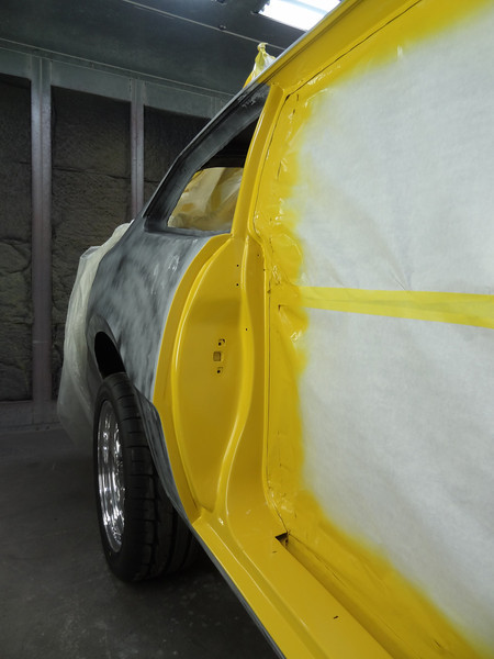

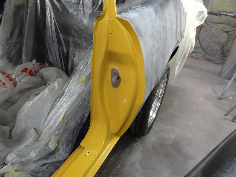

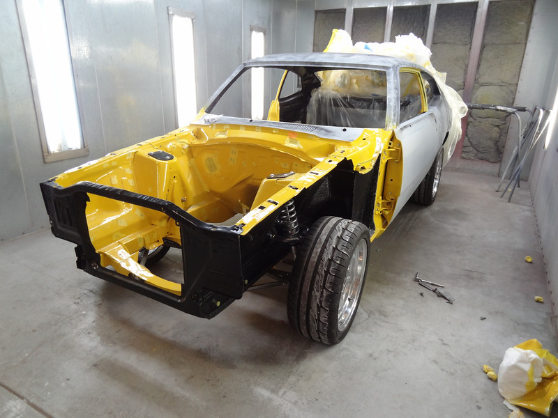

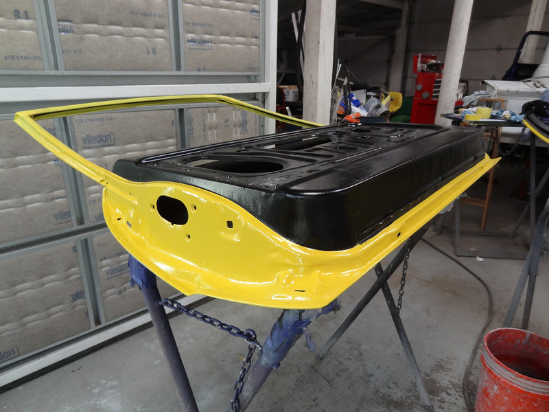

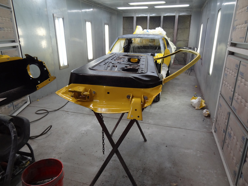

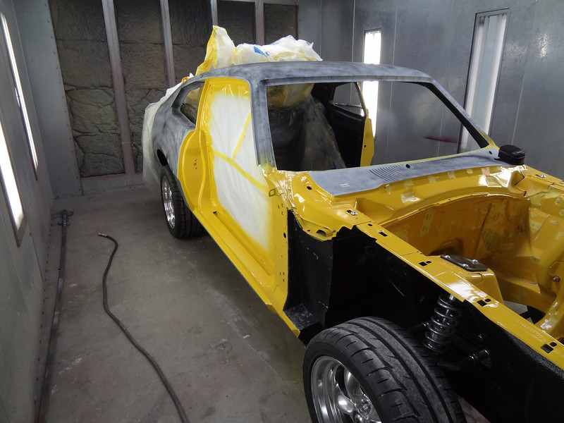

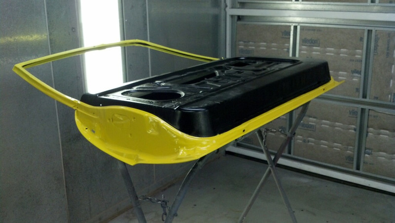

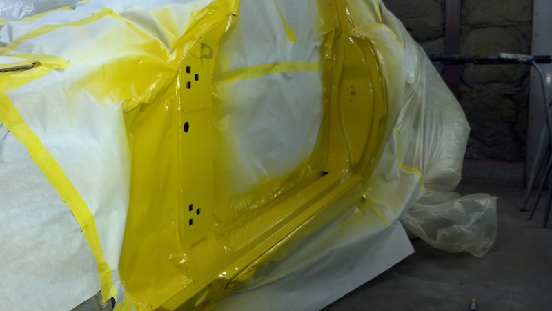

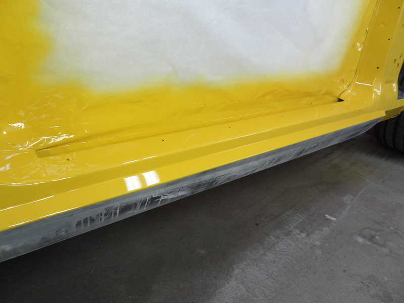

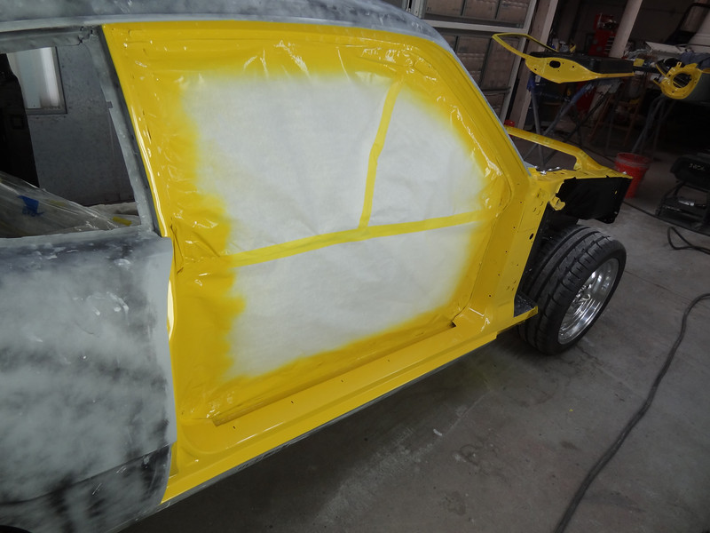

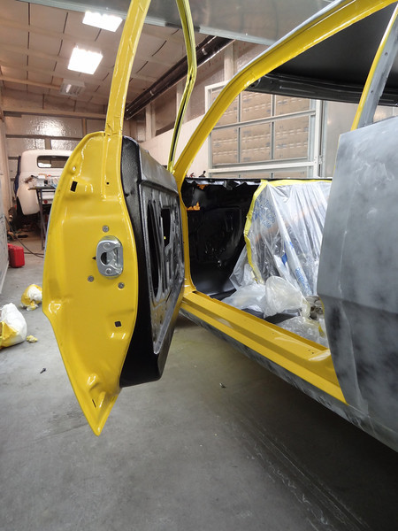

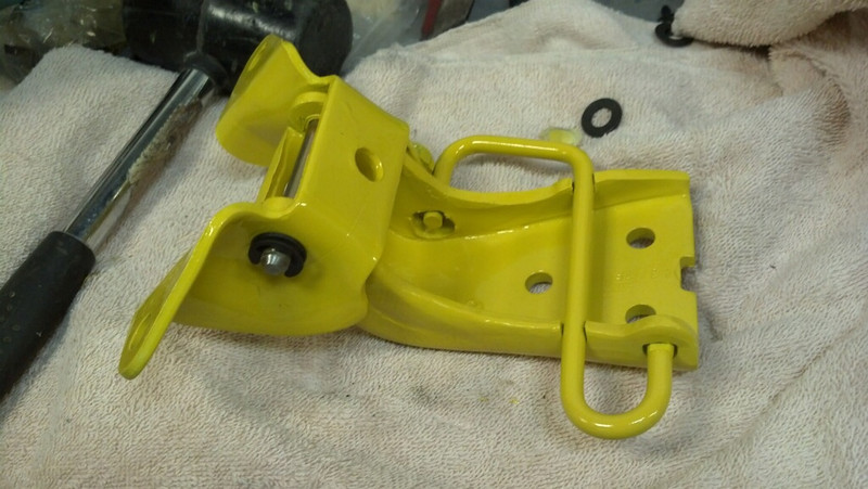

    [​IMG]I figured I would show you the pictures of were it stands until the first of September.
    The Doors jams have been painted, the hood hinges have been painted and assembled, the inner fenders have been painted as well as all the hidden areas, the doors and the fenders have been hung.

    Not the first car stuck in paint purgatory, and surely won't be the last. Looks great though. I hope he comes home and follows through for you.
  15. Dave B
    Looks amazing! I like how he finished the underside of the fenders, it's going to be a beautiful car.
