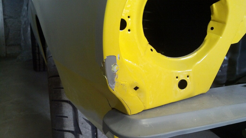

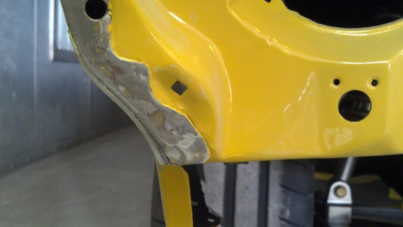

    Well we ran into a problem with the right front fender. We were try to final fit the headlight bezels on the right front did not fit at all. The fender that the previous painter put on the car was not the one that I had chose for the car. After further investigation we found that there was a large amount of filler in the lower portion of the fender around the head light area. The fender they put on the car was the original fender that was on the car and had been hit in that area.

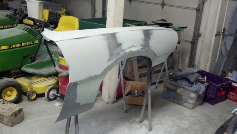

    This was the only part of the car the current painter did not take back down to ensure that the car was all metal. I immediately went to the parts warehouse in my basement and pulled the near perfect fender that was originally my chose for the car. The bad part of all of this is he would have to roll the fender and fill the antenna and side marker light hole.
    There was no chose and off he went to start the work on the fender. I was told by the first painter that this fender did not fit as well as the other. After 3 hours of work the fender was completed and fits way better than the one that was put on the car originally.
    The new fender

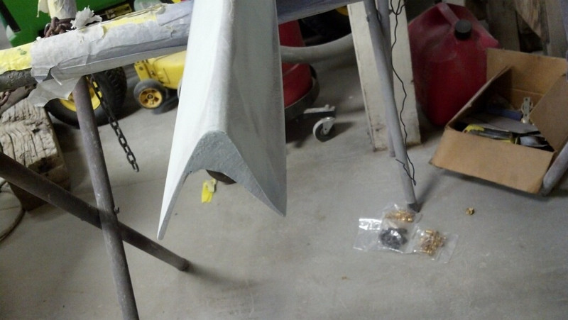

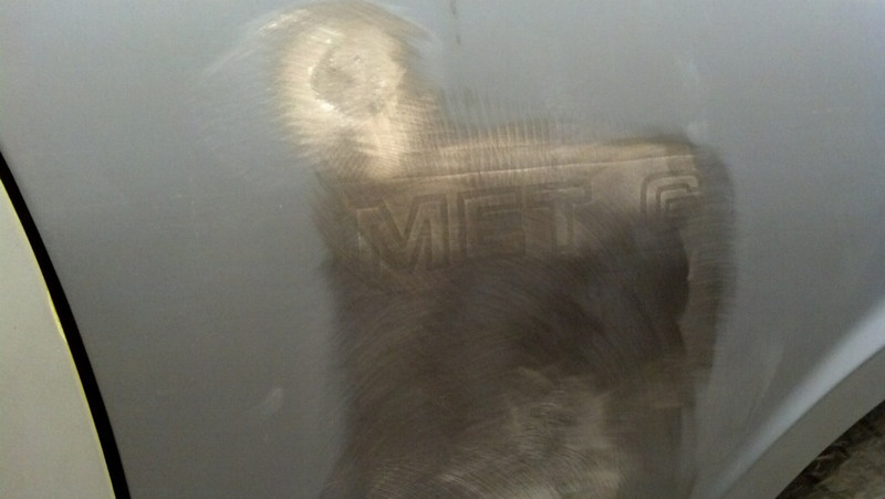

    For all the Comet guys out there, you will be happy to know that a Comet GT part was put on the Maverick.
    The final piece that needed some attention was the crack in the spoiler. Ground out the damage and glassed it back up so it should be good forever.

    Its amazing how you can have 2 fenders, one fits well, and the other is way off.
    You can see how pushed in, the first fender you had was. The square hole for the bezel screw retainer, is crooked.

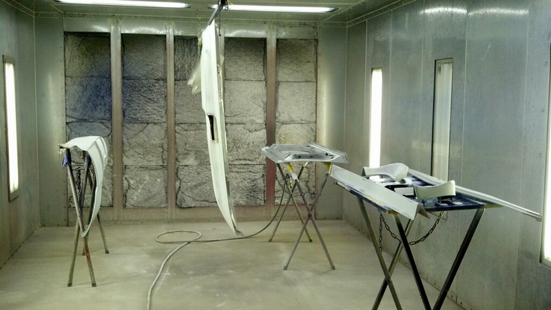

    Down to the final body work and off to primer:
    And now the final primer before wet sanding, sealing, and color!!!!!!!!!
