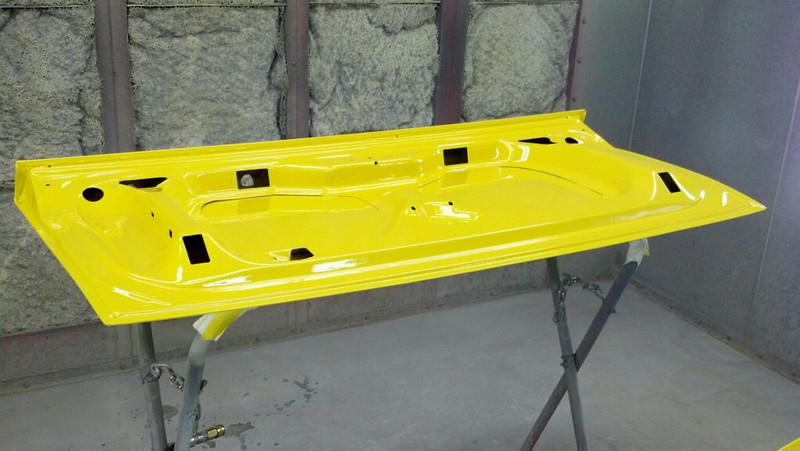

    Wet sanded, sealed, and painted all the undersides of the hood, trunk and fender jambs.

  13. mavgrab302
    It's looking great....

  15. mav1970
    It just keeps getting better and better :thumbs2:
