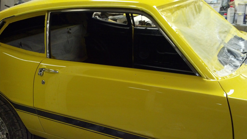

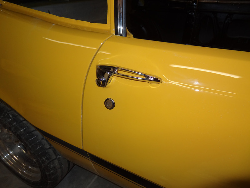

    Door handle is on as well as the polished trim around the door.
  9. Dave B
    Is the handle smaller than the raised section on the door? Or is that a reflection.
  10. Cruzin Illusion
    Cruzin Illusion Enigma
    Feb 3, 2008
    1,133
    Commerce City, Colorado
    1972 Grabber
    That is the reflection of the top of the handle. This car has a lot of reflection!

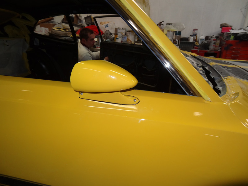

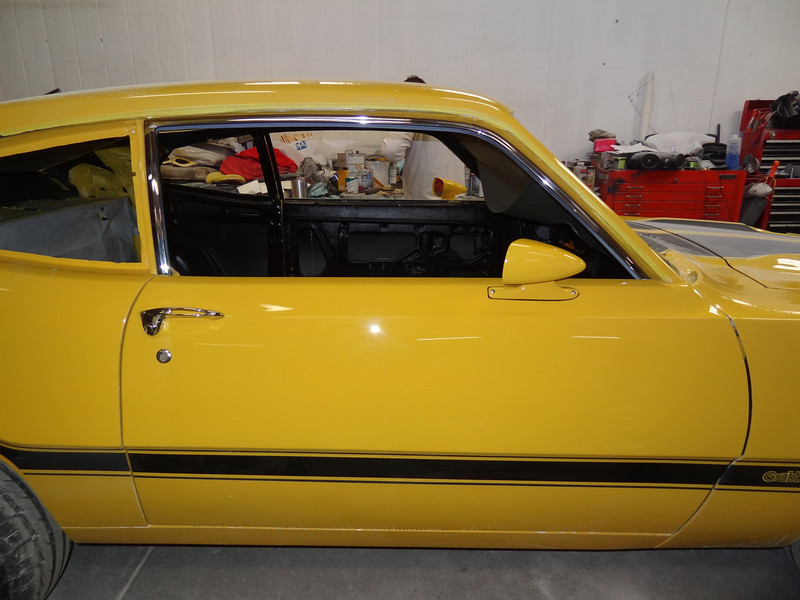

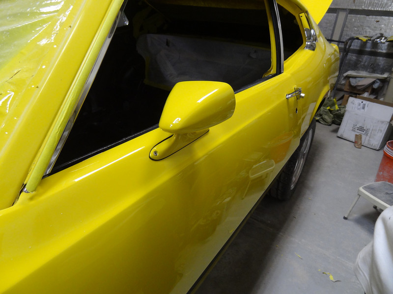

    Mirrors are on, the door trim is on, door handles are installed, and the locks are finished.
    I hate taking pictures of the car at night. It dilutes the color.
