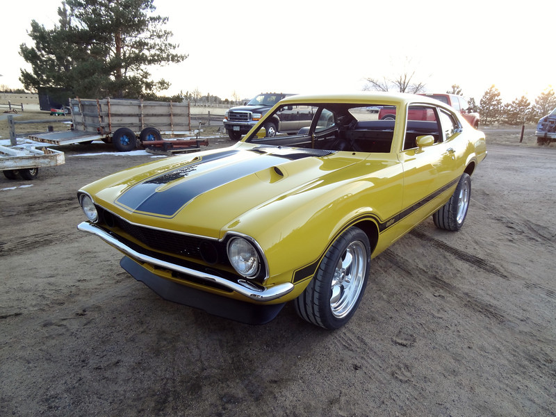

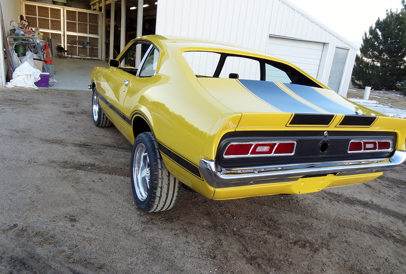

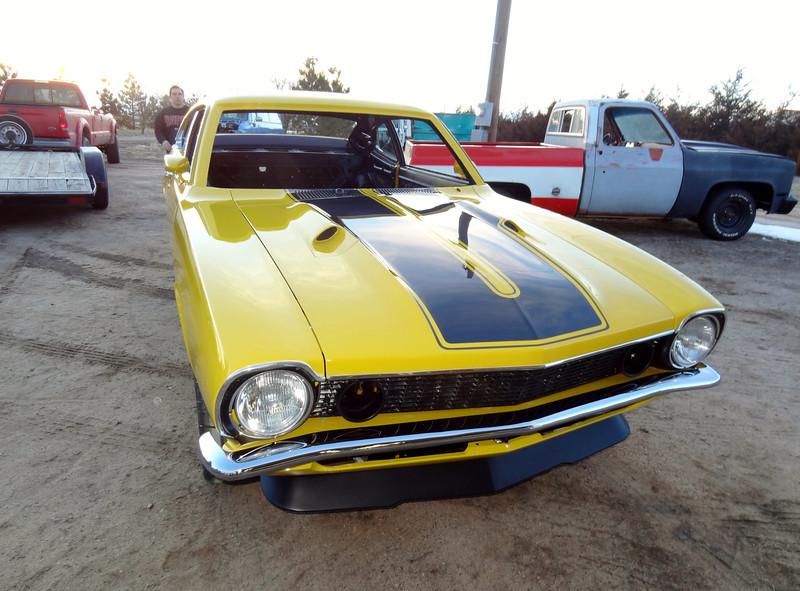

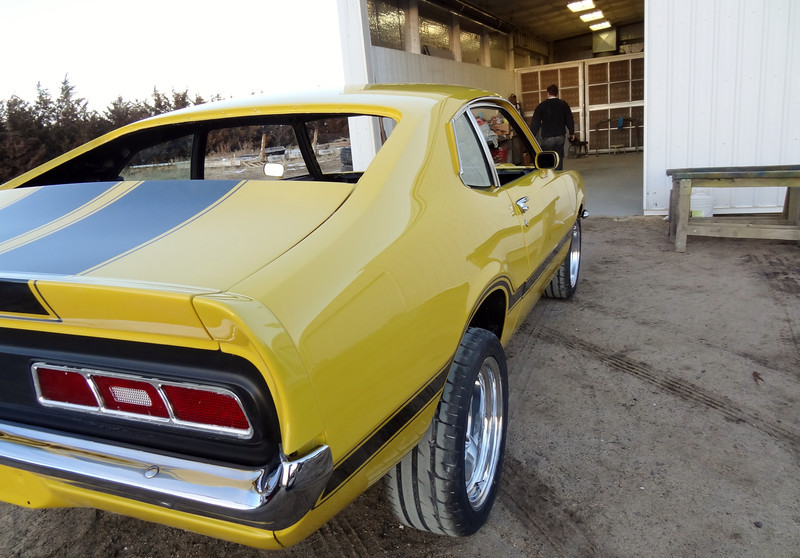

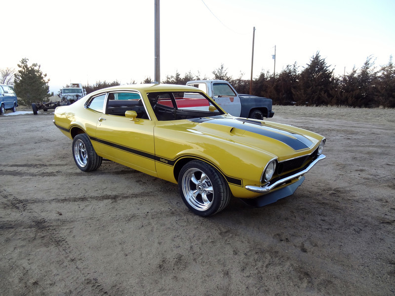

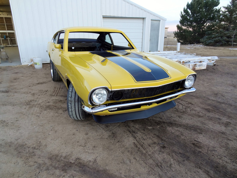

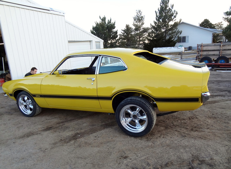

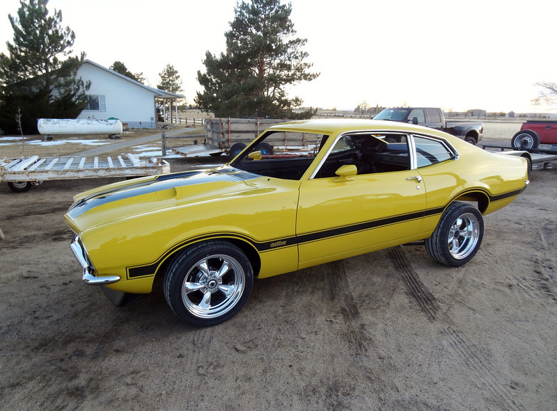

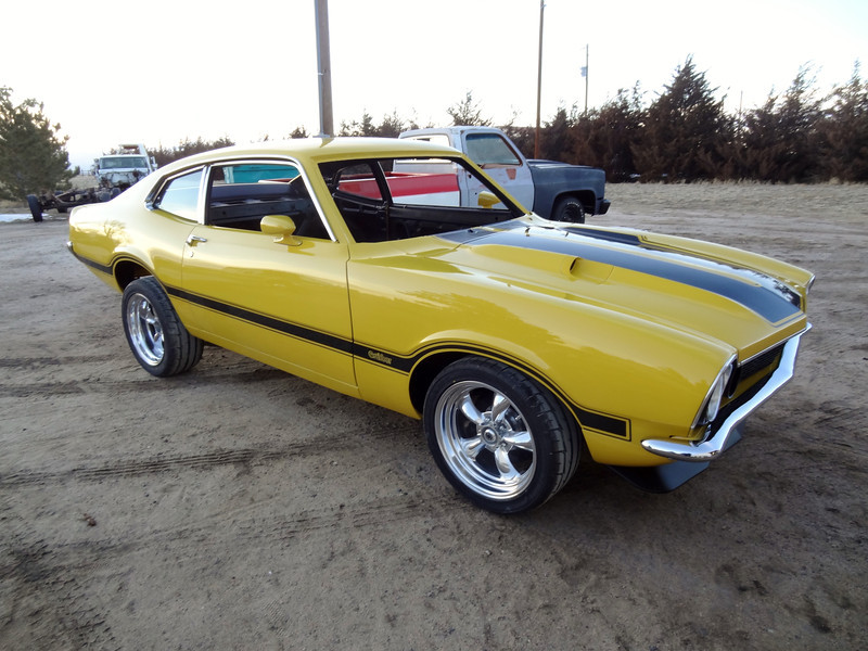

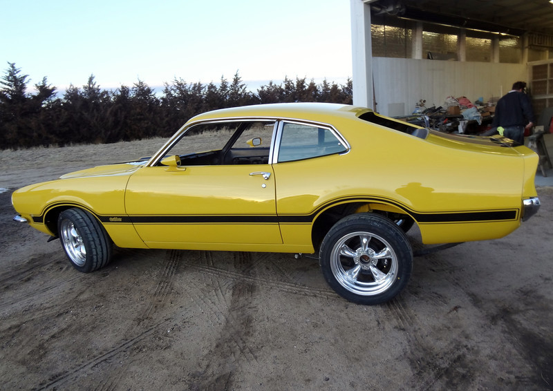

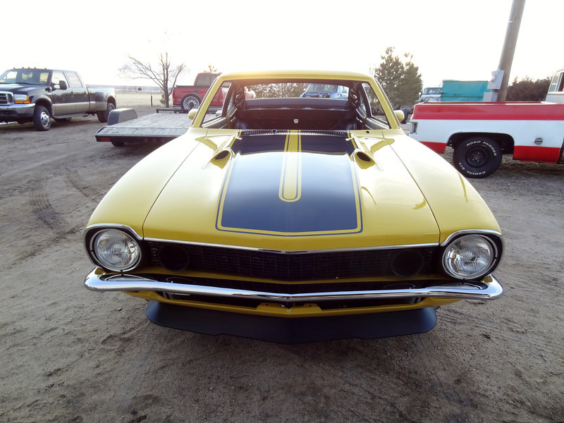

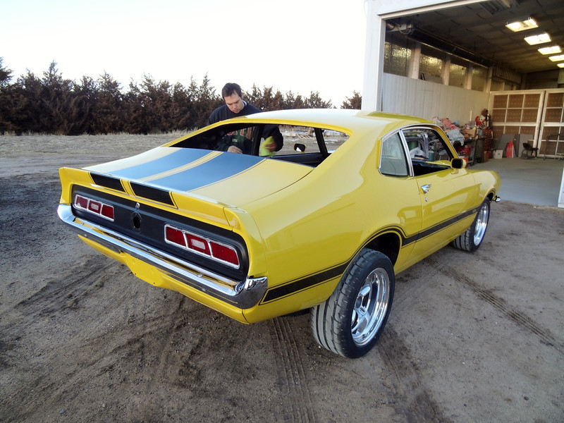

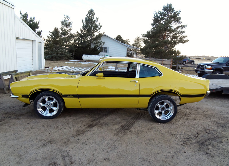

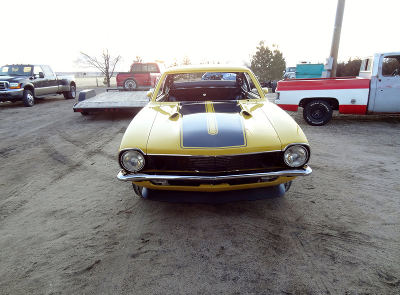

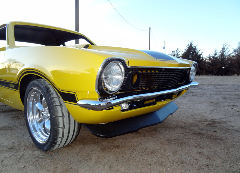

    It is back in my garage at home. Some outside pics but the sun was going down so they are not as good as I would have liked.

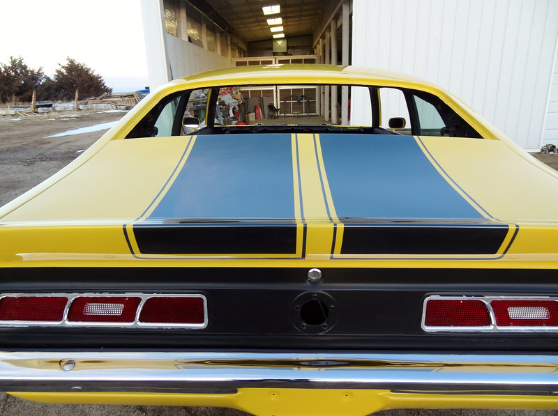

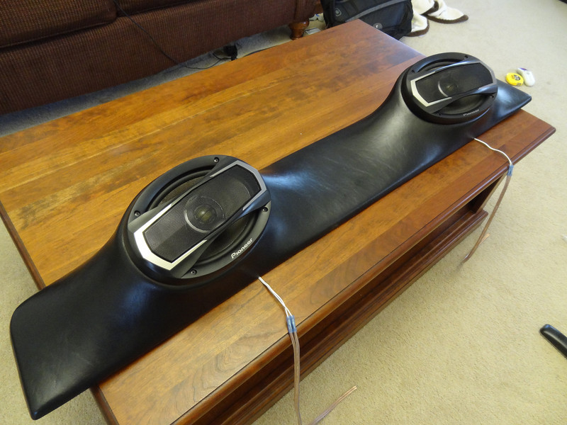

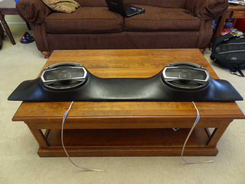

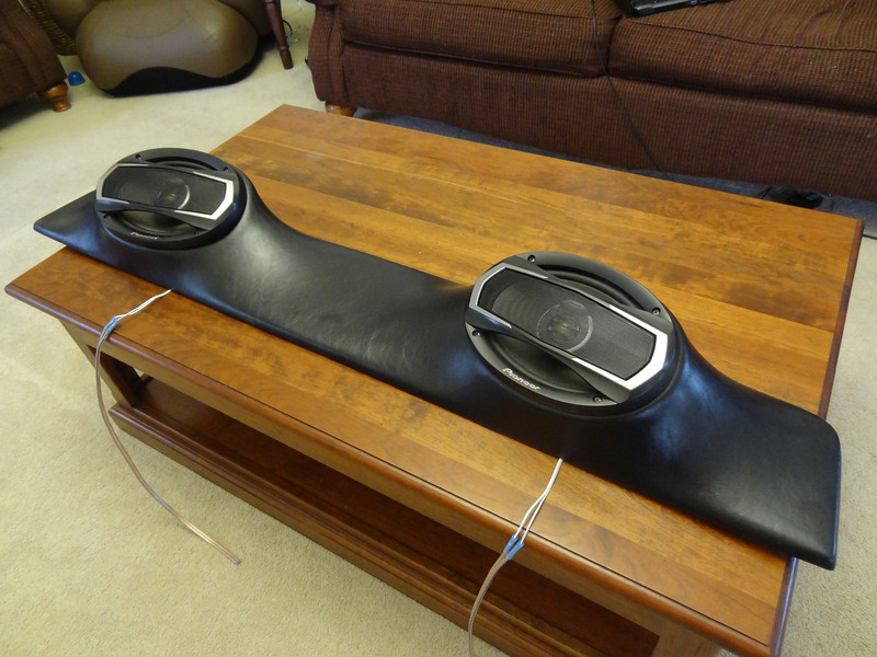

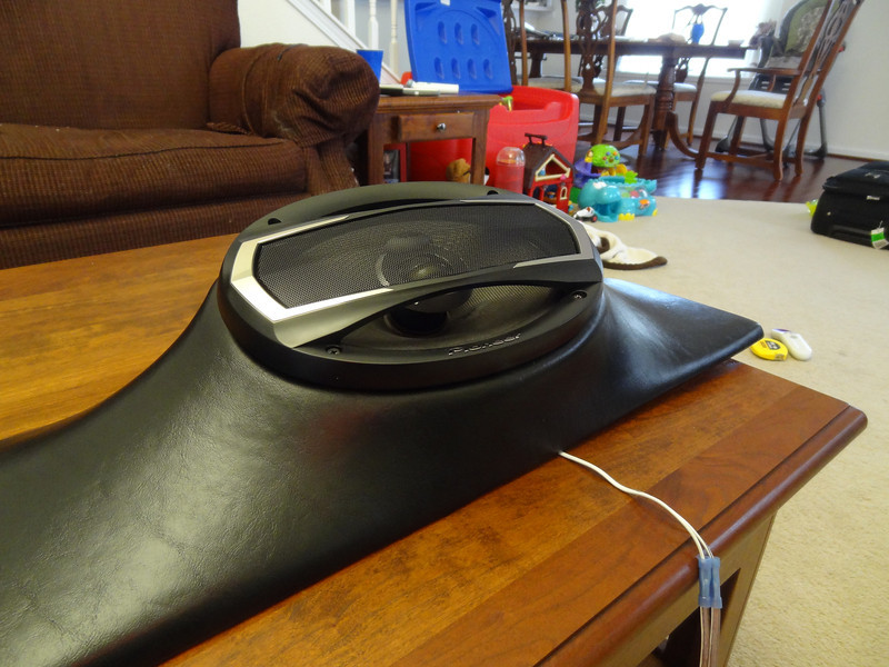

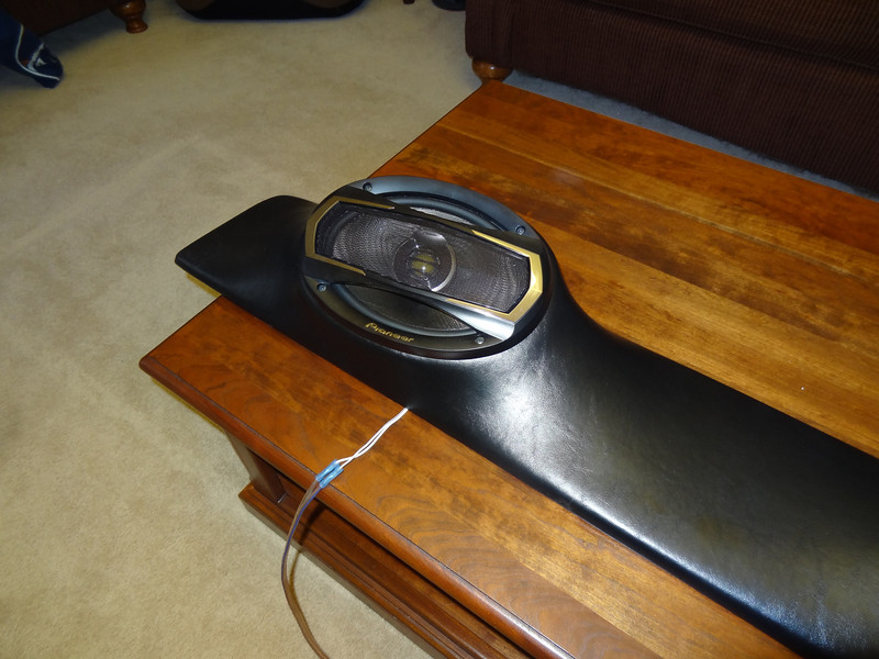

    The 6x9 speaker enclose for the back package tray is done.

  6. blugene
    10,775
    Stunning.. I like the way the speaker enclosure came out.
    For some reason the rear wheels look too far forward in the wheel well..
    No pics of the dash?
  7. Cruzin Illusion
    Cruzin Illusion Enigma
    Feb 3, 2008
    1,133
    Commerce City, Colorado
    1972 Grabber
    I took the advise of a few members and bought my leaf springs from a recommended vendor. They are obviously not right. Like I said before I will be changing the leaf springs out with a new tappered mono leaf springs from Calvert Racing. After comparing those with what is on the car right now it should lower it around 4 inches.
    The front will obviously drop down some once I place the motor in it but that won't be till May.
  8. TCP
    TCP Member
    May 6, 2013
    Sacramento CA
    Take Up A Lot Of Space At My House
    Looking good!
    Don't forget that the back is going to come down a lot once you get the interior, glass, and fuel tank in the car as well.
  9. kboldin
    Jun 10, 2012
    701
    93
    Santee, CA.
    A full tank of gas will be over 140lbs, plus you figure all the other stuff. I'd say another +350lbs total (including the full tank of gas) or so when completed. I think it's to early to tell. Get everything done, then see where she settles at.
  10. rthomas771
    8,091
    980
    Who was the recommended vendor? Here is where my new spring sit things. Only thing in the trunk is a spare tire, scissor jack and maybe half tank of gas.
  11. groberts101
    groberts101 Member
    Apr 22, 2007
    4,166
    535
    297
    Minneapolis, MN
    ok.. let's start the betting at a buck. :bouncy:
    Having the gas tank behind the axle will certainly help.. but I say there's no way that car is settling down enough after you add the rest of the weight back into the equation.
  12. car-nut
    car-nut Glenn
    Jul 2, 2006
    1,299
    conn.
    Did you guys miss where he has bought another new set of springs??
  13. mojo
    5,277
    835
    I do believe you are right. I think you wud have to add a lot more weight than what's been mentioned and still don't believe it would sit as desired. JMO

  15. Cruzin Illusion
    Feb 3, 2008
    1,133
    1972 Grabber
    I don't think they are understanding that I am using a different set of springs.
