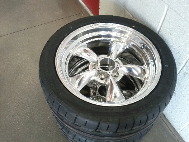

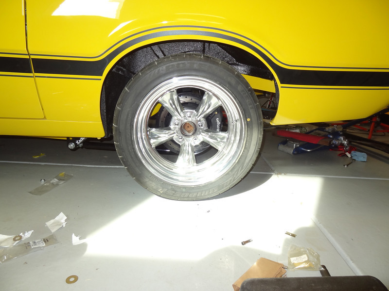

    From what was posted in the past, they are 17X8 with a 4.75" BS. I have the same wheels for my car, they look like they will clear just fine, I wonder if the rear disc's added some positive offset, I know the front wilwood I have, say they will add .75".

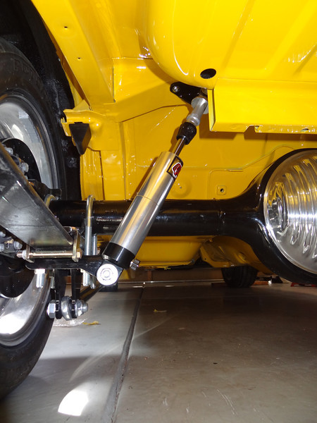

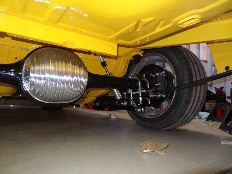

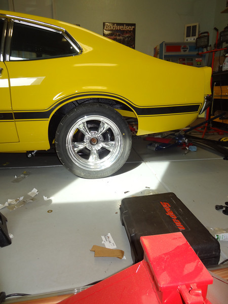

    The Caltrac's system should take car of any of the axle rap. I am only using 1/2" blocks so there is also not that much additional leverage. The springs are also the lowest the make. The -1" springs are the ones I am currently running.

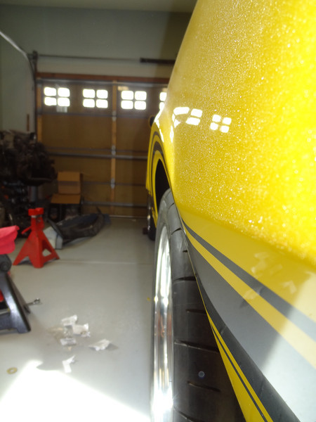

    Originally Posted by Cruzin Illusion [​IMG]
    We are installing Bridgestone Potenza RE11's 245/45/17's on the rear and 245/40/17's on the fronts.

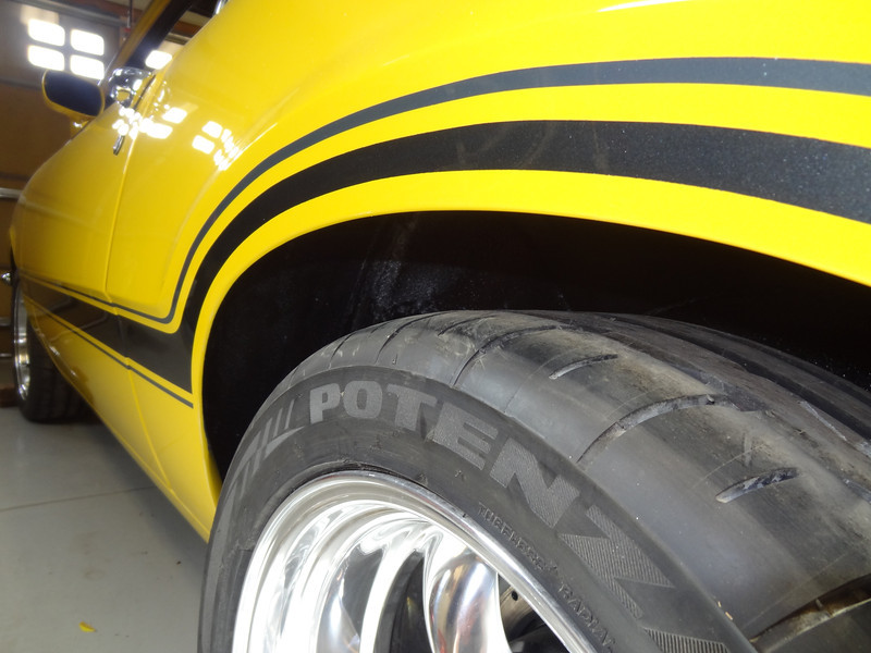

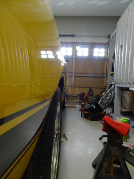

    We are using American Racing Torque Thrust II's. 17x8's with 3.5" back spacing on the rear and 17x8"s with 4.75 back spacing on the fronts.
    I purchased a second Maverick for a parts car and we test fit the tires and wheels and they fit perfect. With an 8 inch wide wheel on the front we were worried that we would have clearance issues. We originally wanted to go with a 4 inch back spacing wheel but it was to close to call. I didn't want to push my luck a damage both front fenders as soon as we finished the car so we opted for the 4.75 inch back spacing wheel.
    I went with 3.5" back spacing on the rear and it I have to reorder the rims I will go with 4.25". Thanks for letting me know that 4.75" will be close to the bump stops.

    There is plenty of room to go with 4.25" back spacing to instead of 3.5" like I went with. There was no reason to have to move the springs.

    Try the 4.75's on the back, and see it the thickness of the rotor, gives you any clearance to the bump stop.

    The front kit does add additional width but the rear kit I believe does not. I don't think the front kit adds 3/4". It is posted in the kit that it adds +.09.
    THIS BRAKE KIT HAS AN HUB OFFSET OF: +.09
    This Hub Offset will move the wheels inward or outward from the fenderby this amount on each side of the vehicle
    That totals .180" or less than 3/16" total.
