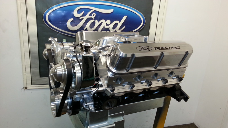

    Here is the motor for the most part completed. The distributor and EZ Efi 2.0 set up needs to be put on. I think it turned out nice.
    What are your thoughts?

    I think it's a perfect addition to a perfect car... Looking great...

    I think it's going to be too nice to drive!

    My thought is it looks too nice to use lol.. Then I also think that I want one. That is a very nice motor. (y)

    It's like a high water mark of achievement!

    Specs:
    363 Liberator Dart Longblock -
    Dart SHP Machined Block
    Scat 4340 Forged Steel 3.400 Crankshaft
    Scat 4340 Forged Steel H Beam Connecting Rods 5.400
    With ARP 2000 Rod Bolts
    Wiseco 2618 Forged Pistons (Flat, TFS) 4.125
    Wiseco GFX Ring Pacakge
    Clevite 77 H Main Bearings
    Clevite 77 H Rod Bearings
    Dart Coated Cam Bearings
    Screw in Oil Galley Plugs
    Fel Pro Rear Main Seal
    ARP Main Studs - WINDAGE TRAY
    Freeze Plugs
    FordStrokers Custom Cut HYD Roller Billet Camshaft
    ARP Cam Bolt
    Cam Retainer Plate
    SA Gear Billet Timing Chain w/Torrington Bearing
    Melling Oil Pump M68
    ARP Oil Pump Bolts
    MOROSO PICK UP 24523
    ARP Billet Oil Pumpshaft
    Fel Pro 1 Piece Pan Gasket
    MOROSO PAN 20535
    Mr. Gasket Oil Pan Bolts
    Moroso Braided Stainless Dipstick 25971
    MOROSO WINDAGE TRAY 22930
    TIMING COVER INCLUDED IN MARCH KIT
    Fel Pro Timing Chain Gasket Set
    Trick Flow Twisted Wedge 205 11R Cylinder Heads -
    Morel Hyd Roller Link Bar Lifters
    4130 Chromemoly .080 Wall 1 Piece Formed End Pushrods
    Comp Cams Ultra Gold Rocker Arms 1.6
    Fel Pro 1134 MLS Head Gaskets
    ARP Head Studs
    Edelbrock Polished Air Gap Intake Manifold 75211
    Fel Pro Intake Gaskets
    ARP Intake Bolts
    FAST Dual-Sync Billet Distributor 305007
    ProForm Ford Racing Aluminum Valve Covers 302-138
    Valve Cover Gaskets
    Valve Cover Bolts
    Powerbond SFI 28oz Balancer 1060-SS
    ARP Balancer Bolt
    Timing Pointer
    Ford Racing Spark Plug Wires
    Autolite 3924 Spark Plugs
    March Performance Style Track Serpentine System 30480
    WATER PUMP INCLUDED IN MARCH KIT
    Upgrade to 140 amp Alternator P556
    FAST EZ-EFI 2.0 Self-Tuning Fuel Injection System 30400
    Machine Block -
    -Cylinders bored on Kwik-Way Boring Bar and Table
    -Finish honed on Sunnen SV-616 Hone with BHJ
    Aluminum Torque Plates, Fel Pro Head Gaskets and ARP
    Hardware (.0001-0002 Taper MAX)
    -Plateau Brushed (Provides Instant Ring Seal)
    -Main Bearing Bores Align Honed on a Sunnen CH-100
    Hone
    -Deck surfaced on a Winona Van Norman CBN surfacer
    (Ra Finish compatible with MLS Gaskets)
    -Screw In Oil Galley Plugs
    -Lifter Valley Oil Drain Backs Chamfered
    -Oil Filter Inlet Chamfered
    -Threaded Holes Chased
    -Lifter Bores Honed
    -Crankshaft Balancing done on Hines Dominator XP Digital Balancer Balanced to 28oz
    Block Painted - BLACK

    Thanks for the great comments!!! A lot of thought went into the powerplant. I am happy with the looks of it. I wanted it to look awesome without the massive amounts of chrome. I think the polished look is a good compromise.
