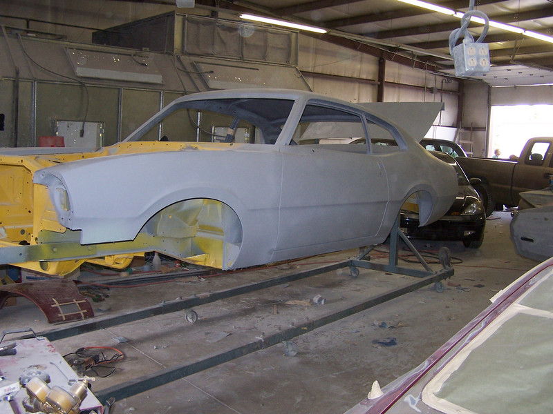

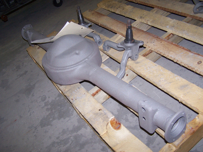

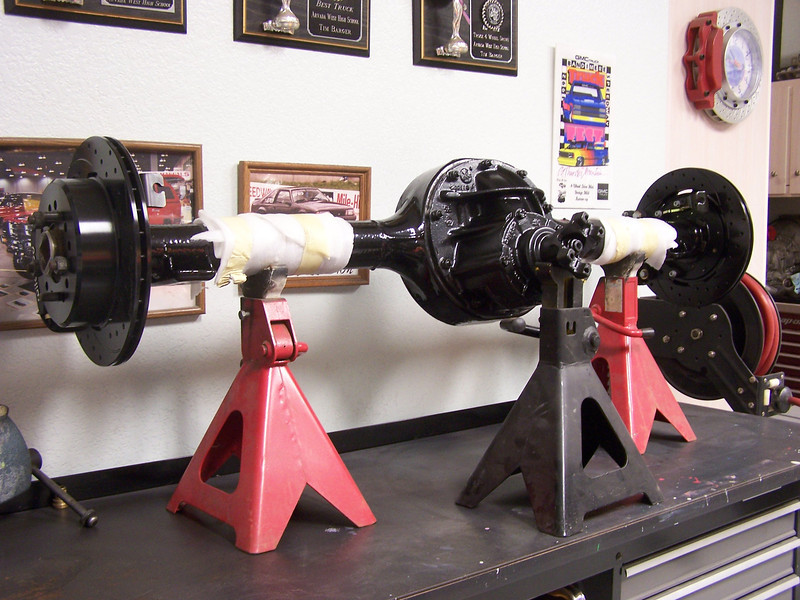

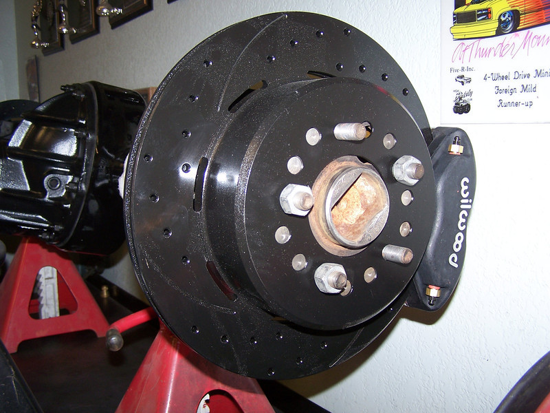

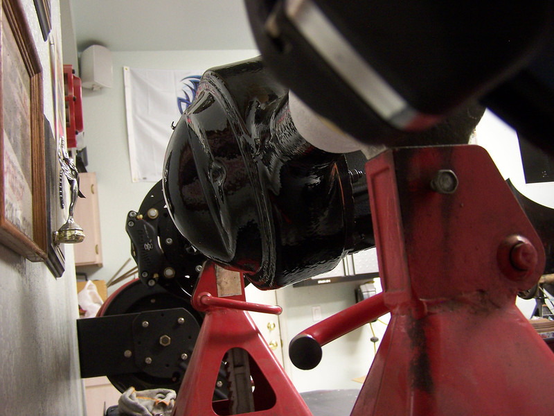

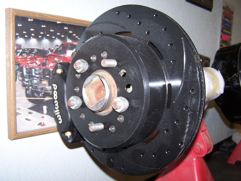

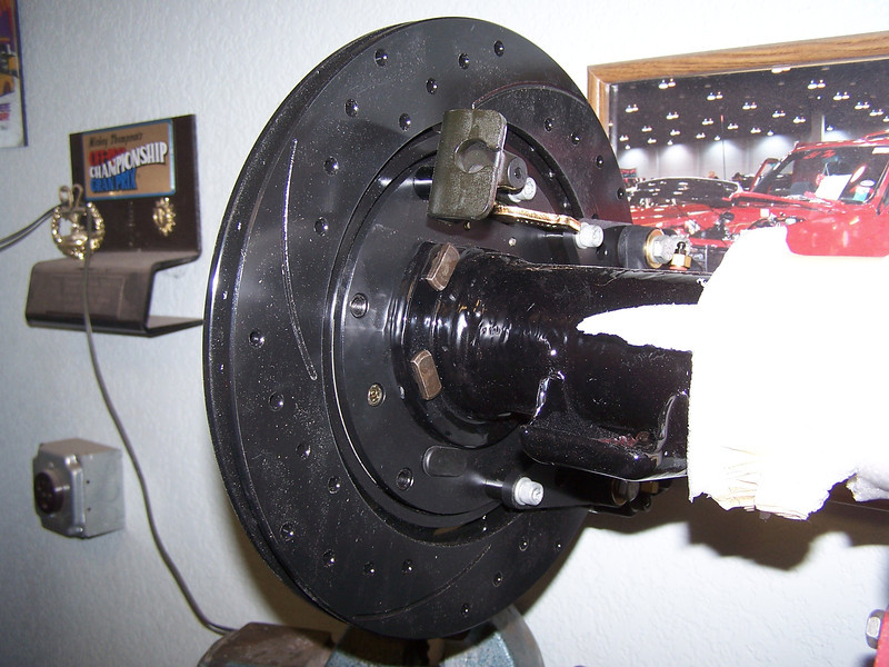

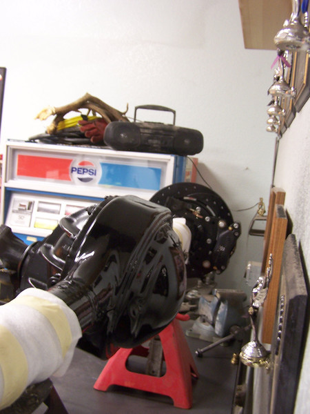

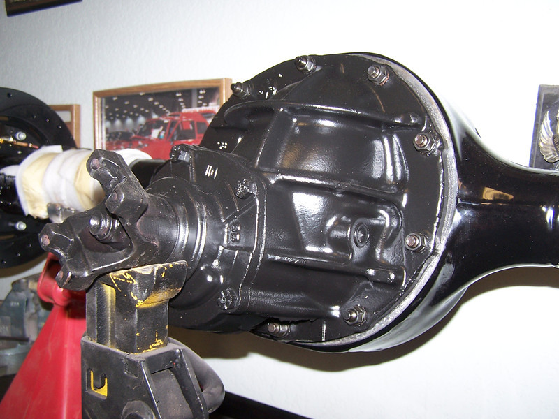

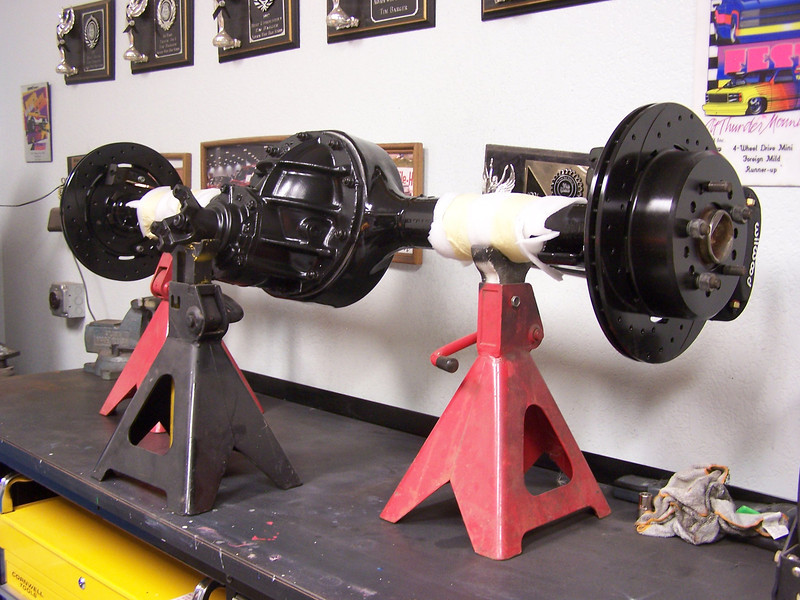

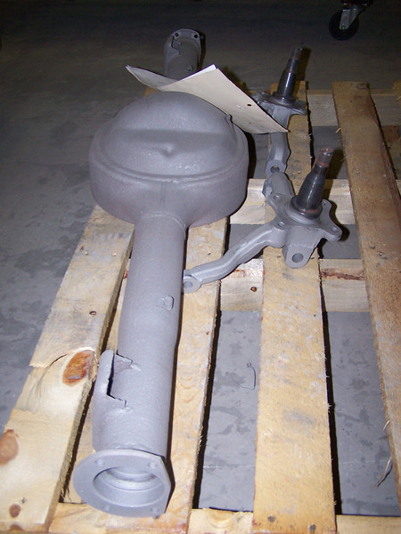

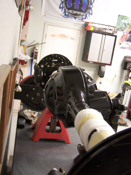

    [​IMG]The next thing I decided to work on is the 9 inch rearend. The rearend was shortened to the match the width of the stock 8 inch. The third member was built with a Trac loc and 3.89 gears. I decided to stick with the stock 28 splined shafts. I used Wilwood Dynalite Pro Series Rear Parking Brake Kit with 12.19" diameter vented and slotted rotors. P/N 140-9282-D
    Here is the rearend and the spindles after they were media blasted and prepped for powder coating.
    Here it is finished up
    Sorry for the dusty brakes in the next few pictures

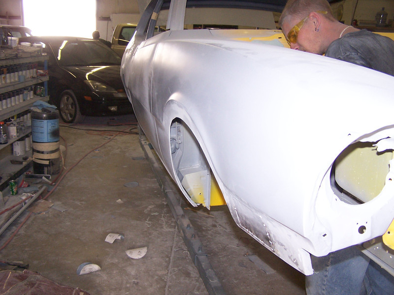

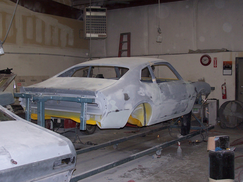

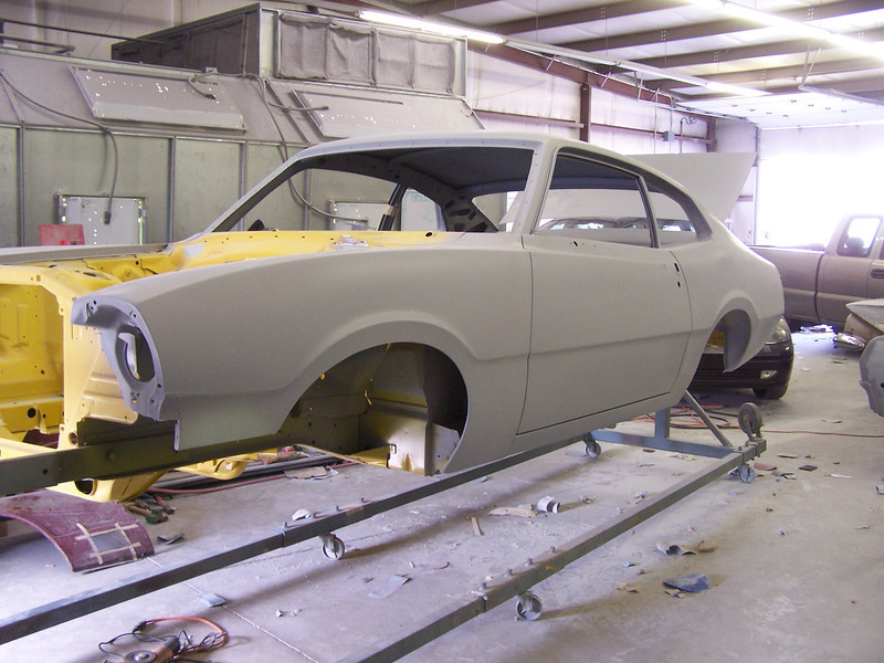

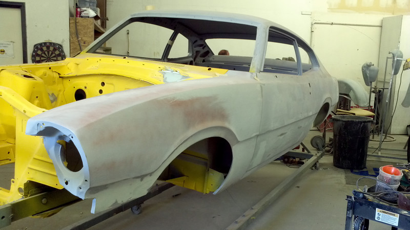

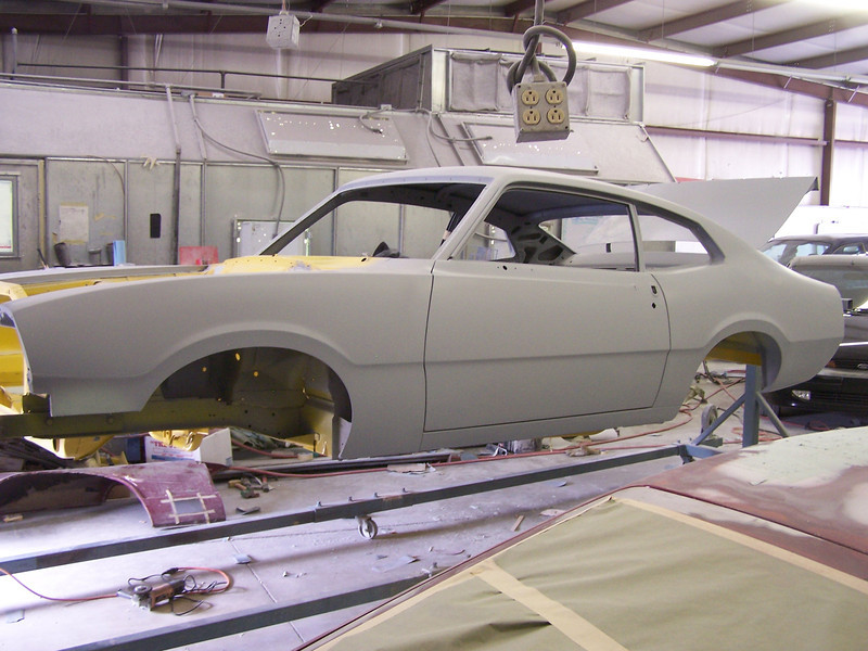

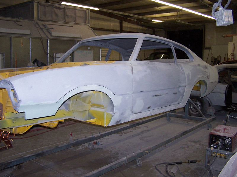

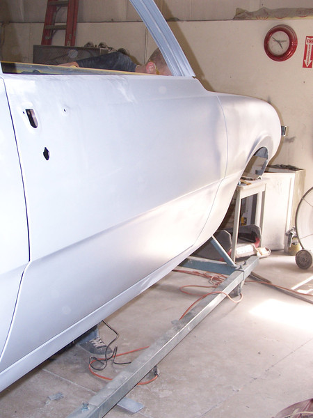

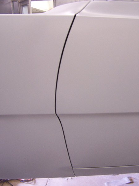

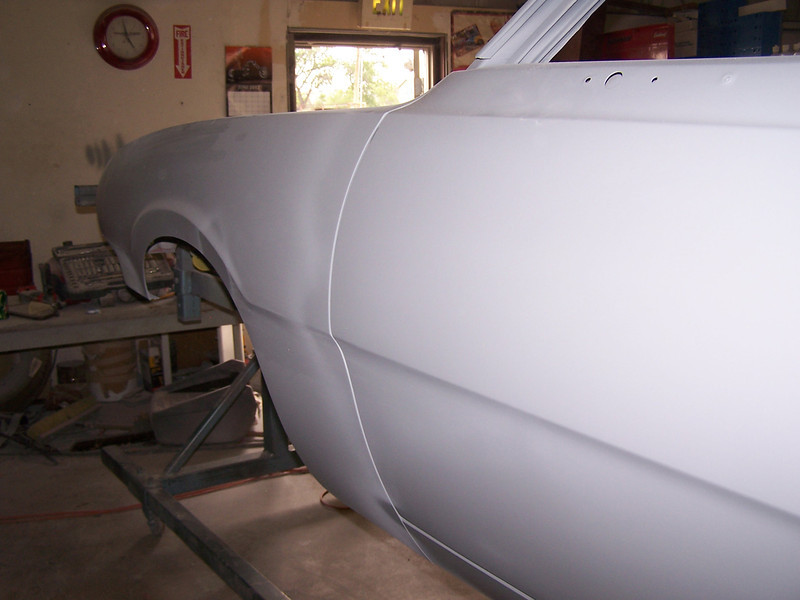

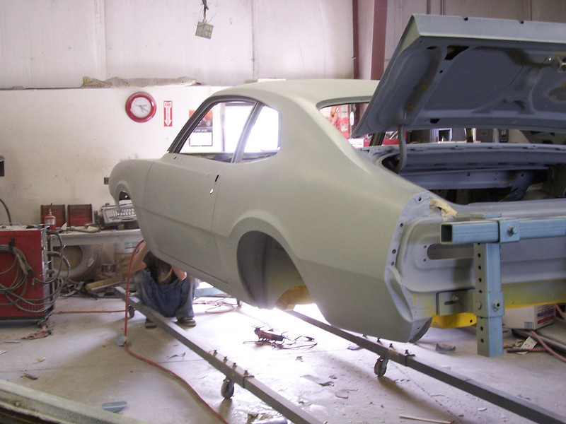

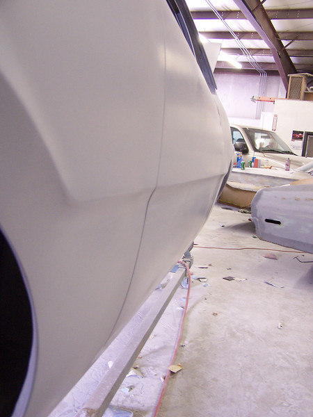

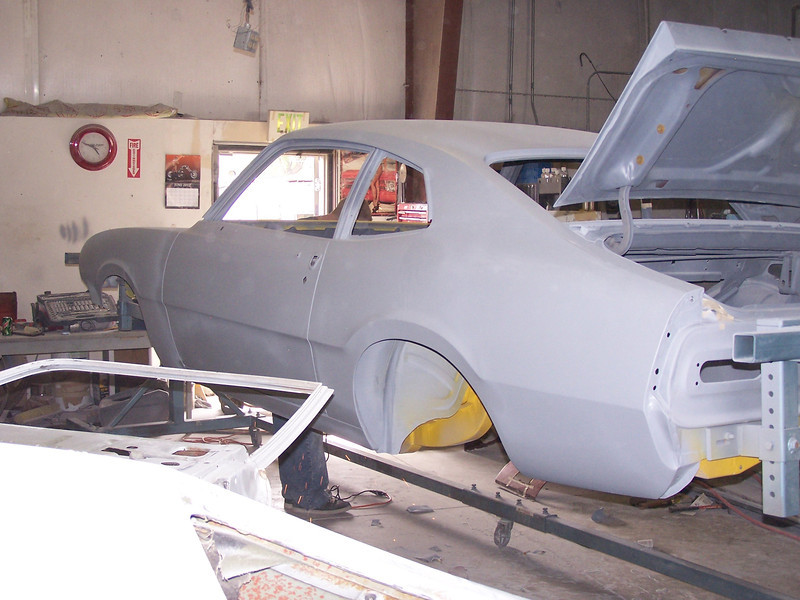

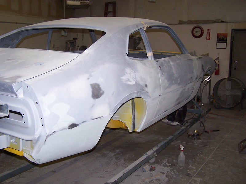

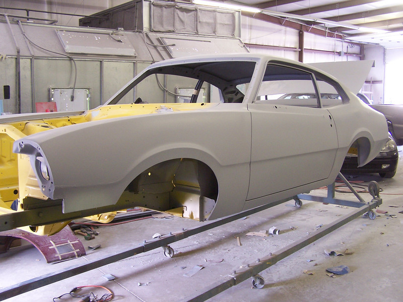

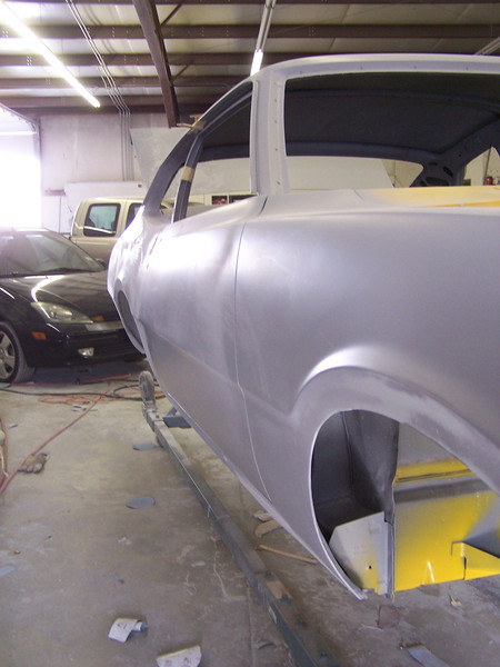

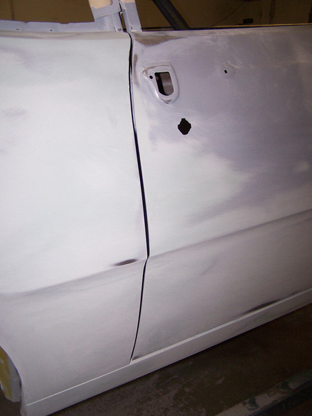

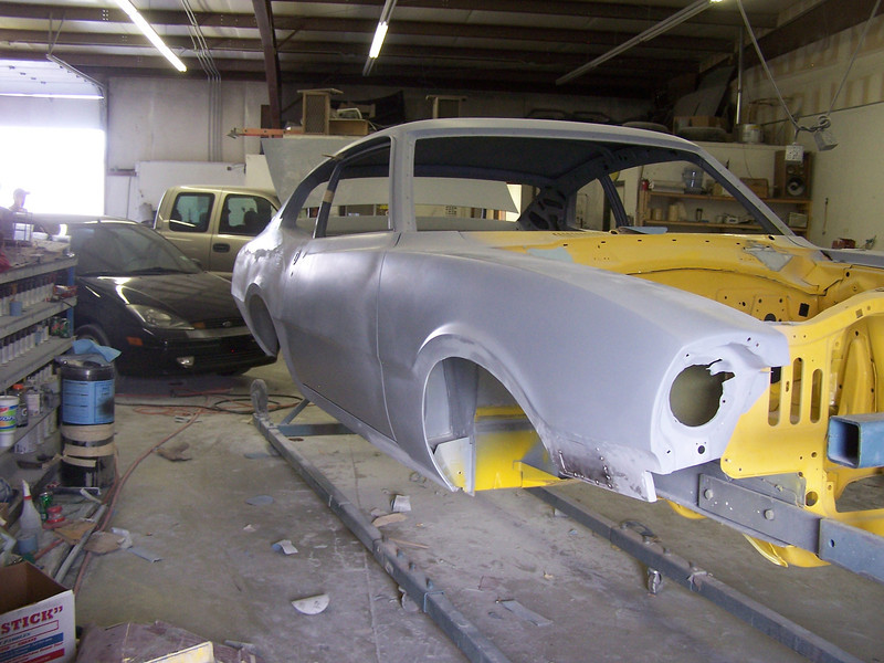

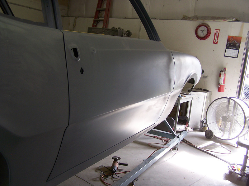

    Back to blocking the maverick out. I also got a little ahead of myself when painting the engine compartment and underside of the car. We are going to end up blocking the paint out again to get it to were it needs to be.

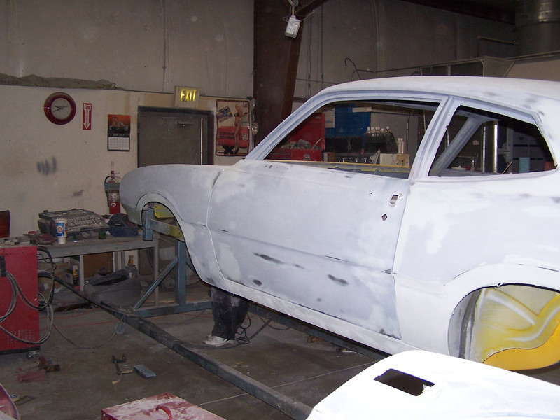

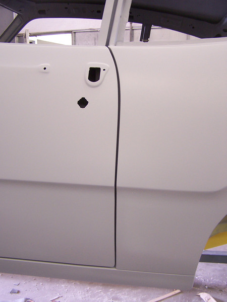

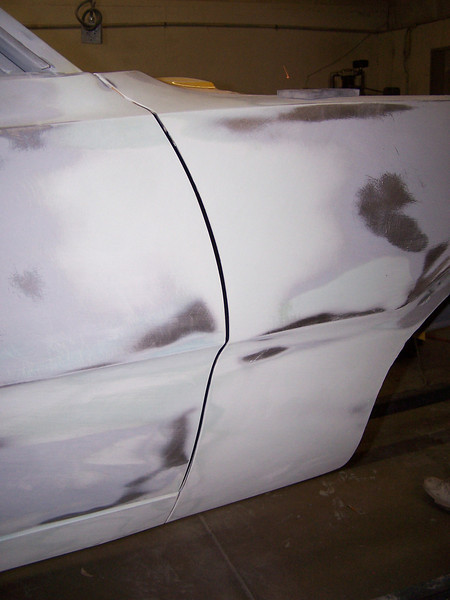

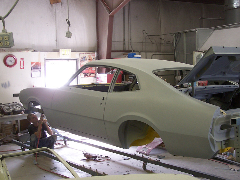

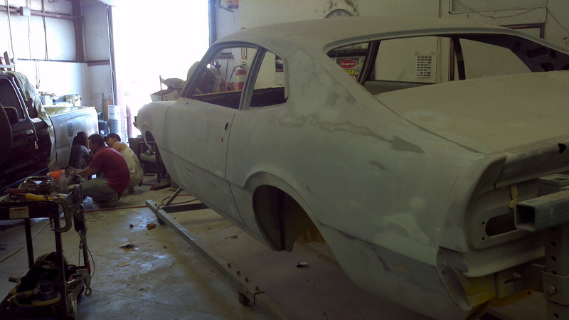

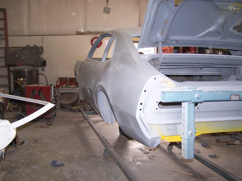

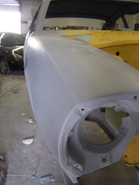

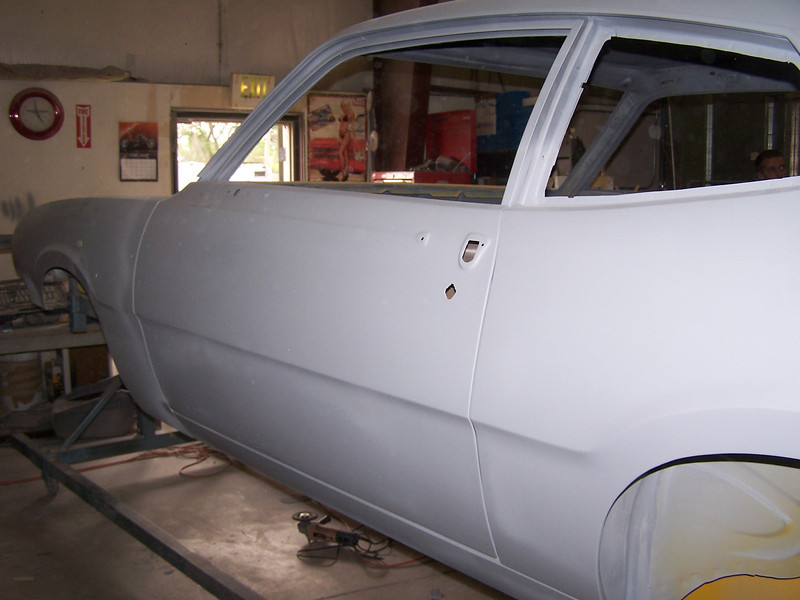

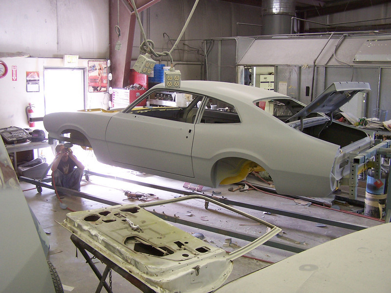

    [​IMG]It the maverick ready for another coat of primer and then we will start guide coating the car to make sure we get it perfectly straight.

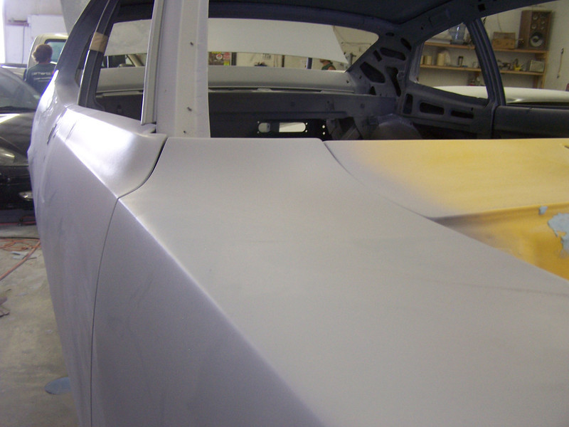

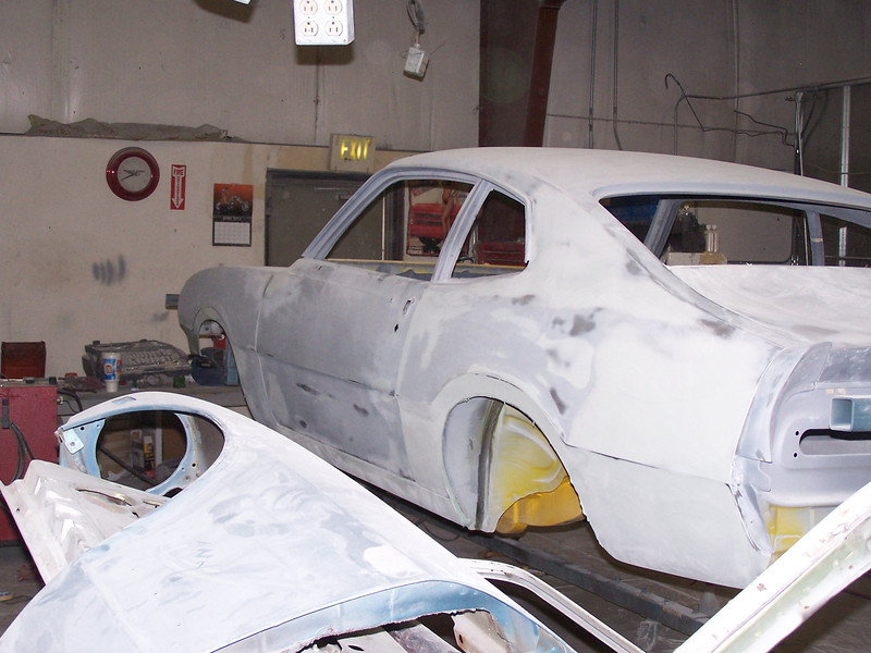

    No more Antenna

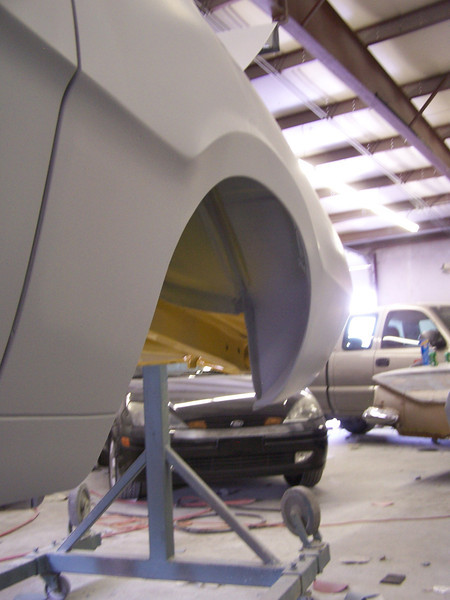

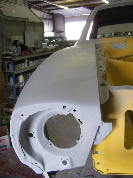

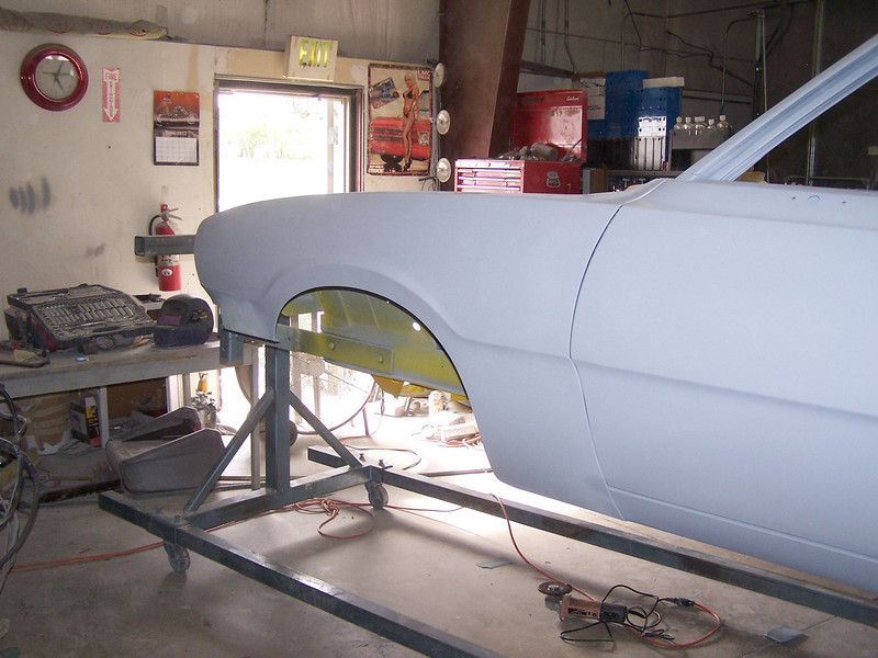

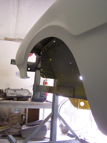

  8. don graham

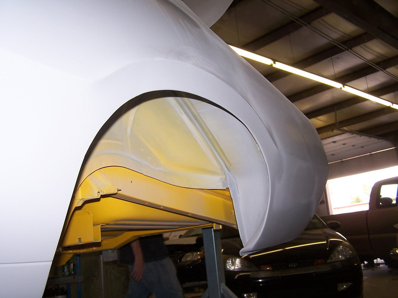

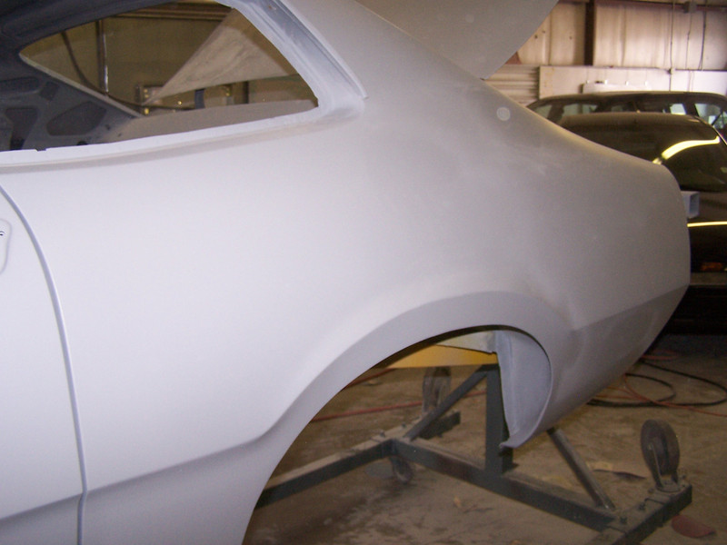

    What did you use to roll the fenders?:)
  9. Cruzin Illusion
    Cruzin Illusion Enigma
    Feb 3, 2008
    1,133
    Commerce City, Colorado
    1972 Grabber
    Hammer and Dollie. It was pretty tedious but it is well worth the added room for the wheels and tires. Definately not the same thickness of metal in a honda.:rofl2:
  10. don graham
    I've got the Eastwood tool for doing that, but I'm not sure it rolls it that far. Looks Killer.:)
