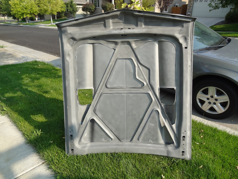

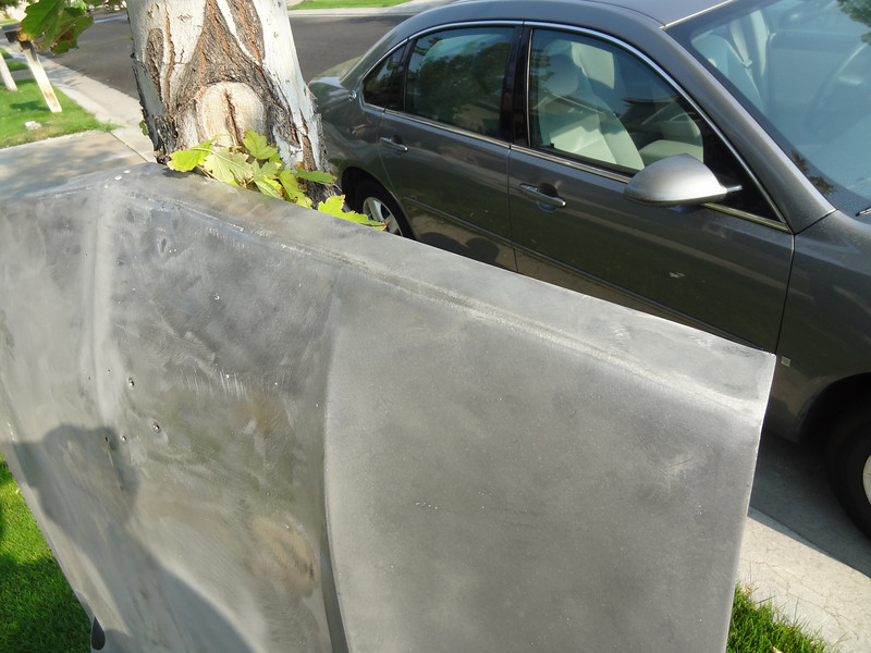

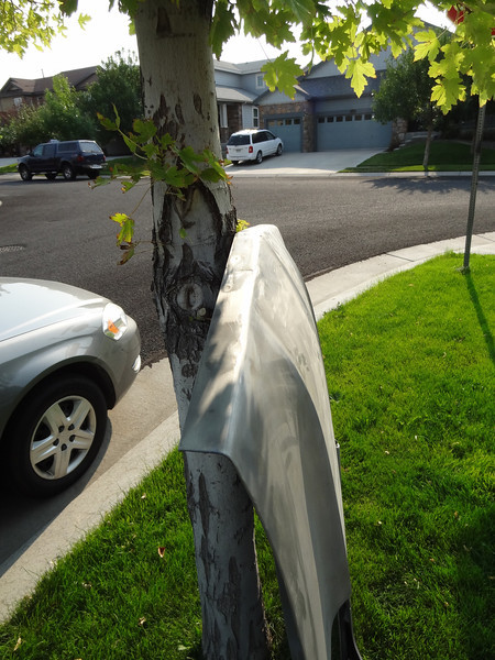

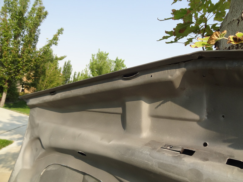

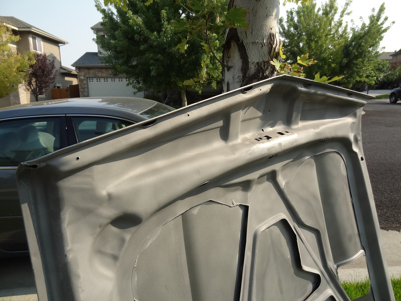

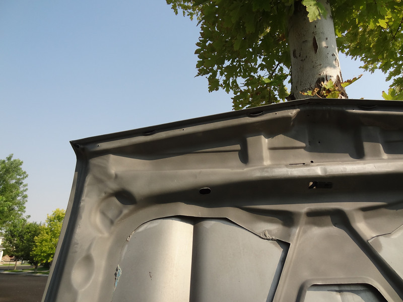

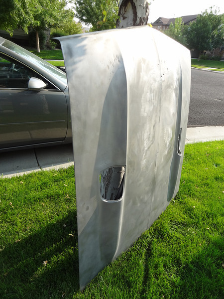

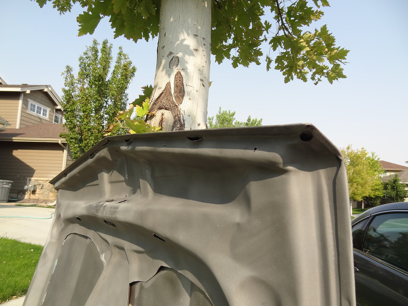

    I picked up the Grabber Hood and had a local media blast shop strip all the fancy metalic green paint off the hood to see what I truely have.
    Here are the results:

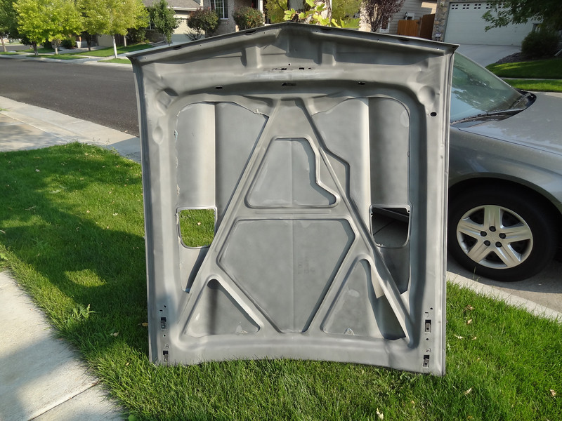

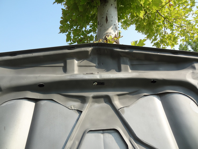

    The bottom side
    The front lip(y)
    The dark area is some type of sealant not rust. The front lip is solid!!!!!
  2. Dave B
    Looks like they blew most of the glue out of it, you might want to re-glue the subframe to the hood skin.
    Whats that writing say?

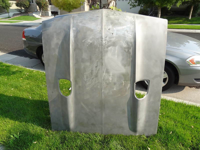

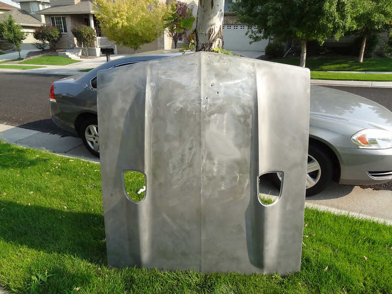

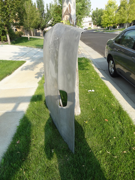

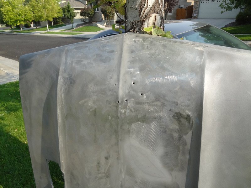

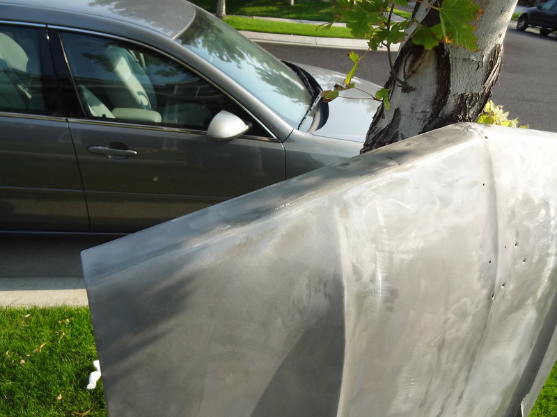

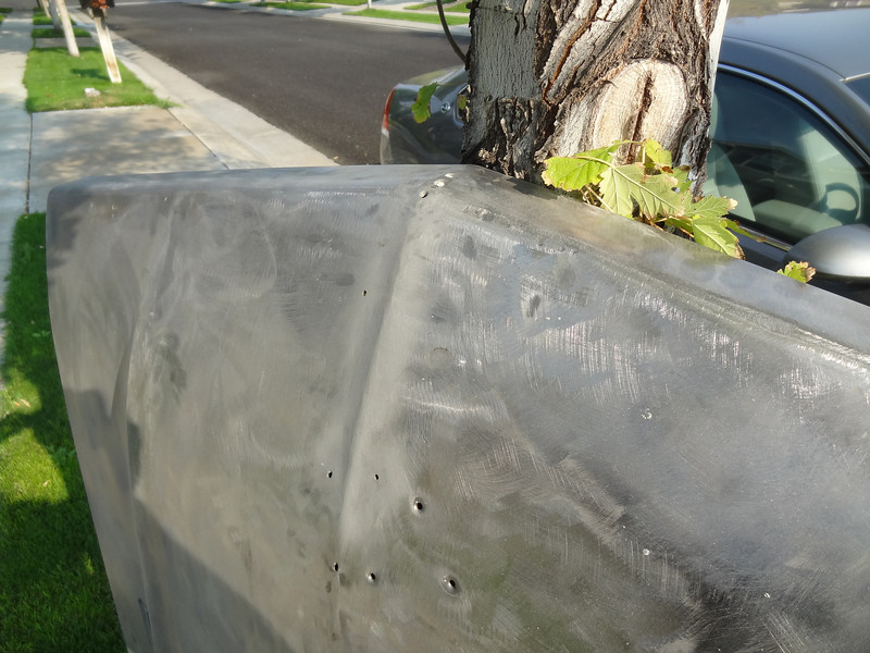

    The top side:
    It is not as nice as the bottom but I think it is definately workable.

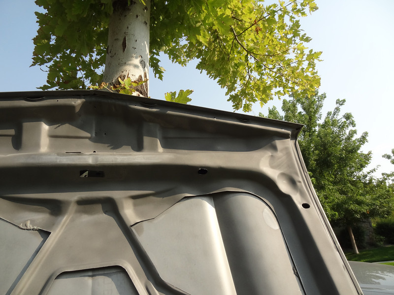

    The nose area:

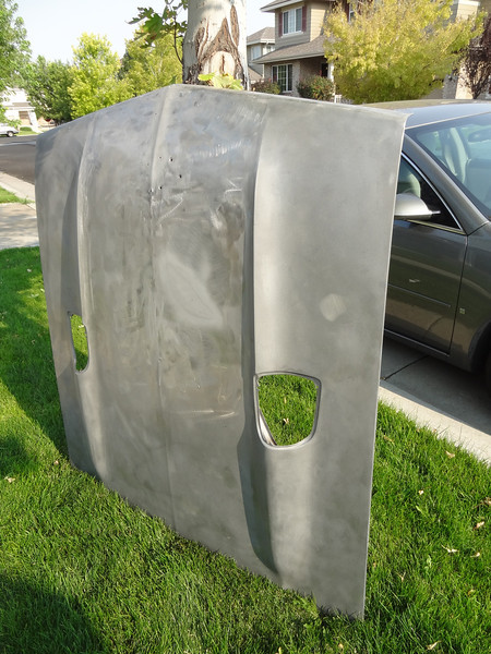

    The sides:

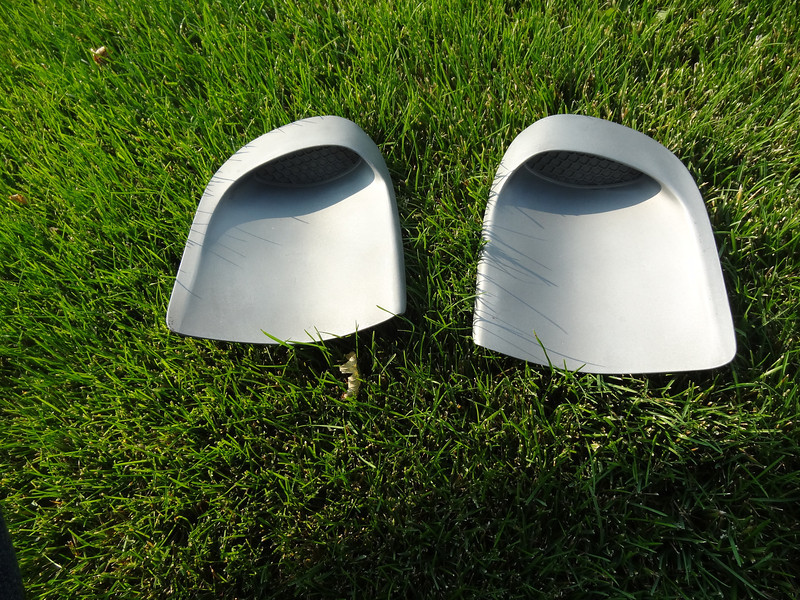

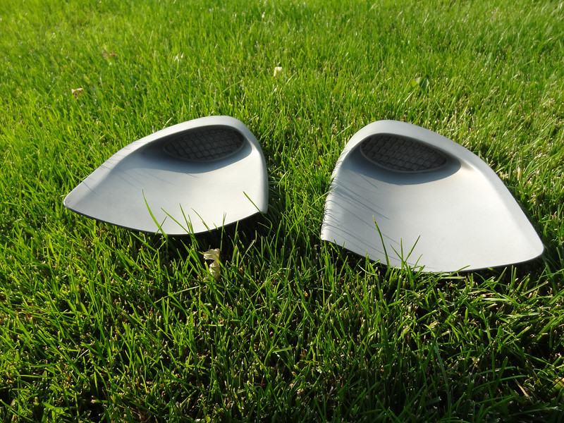

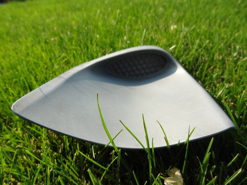

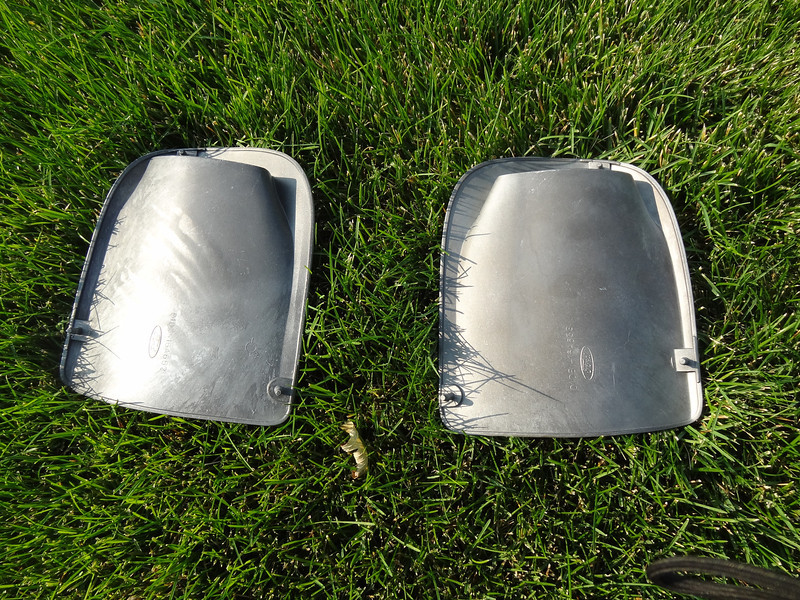

    The inserts:

    This is what I can make out on the bottom of the hood:
    IUSINOR
    44230
    DOE
    2091971
    I would think it was what was printed on the original metal they used to fabricate the hood.

    So what is the story behind the holes in the hood?

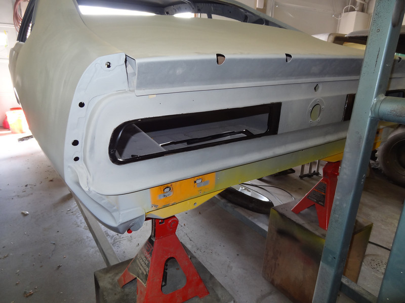

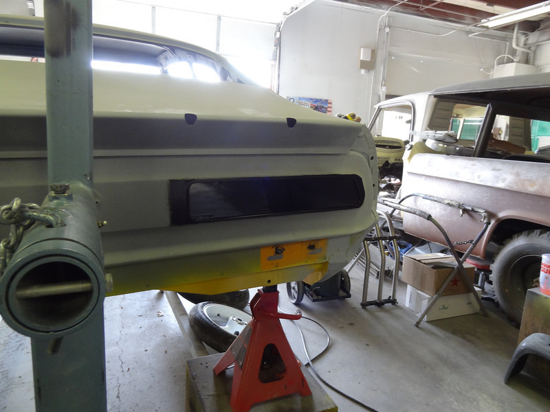

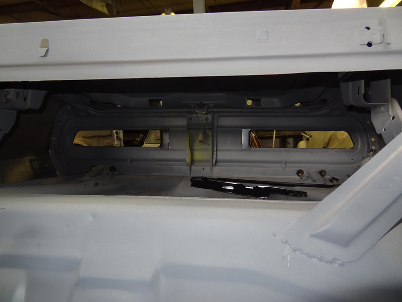

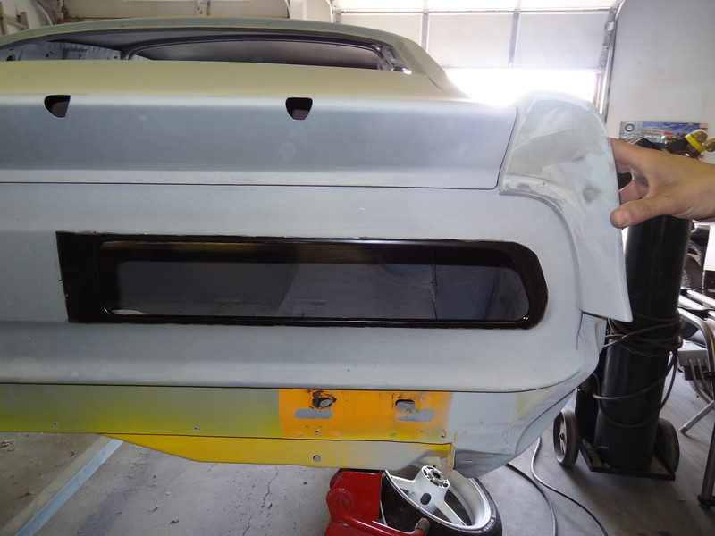

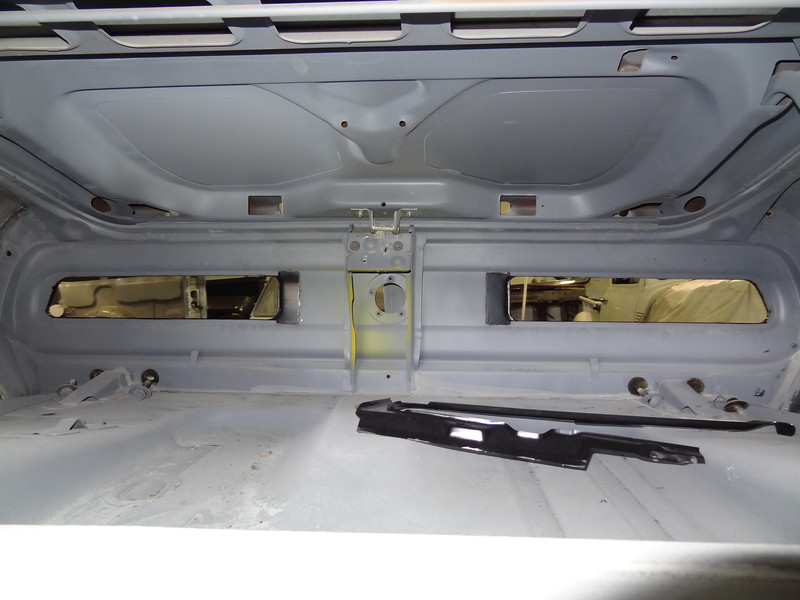

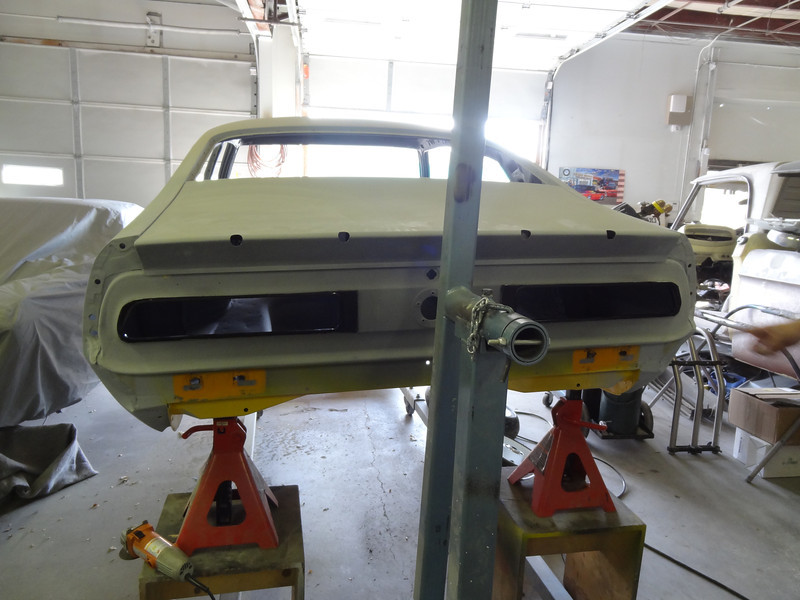

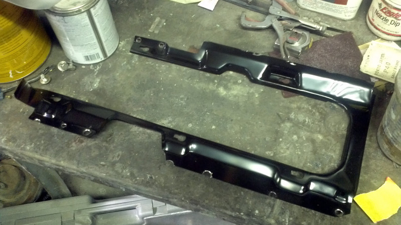

    Here goes the start of installing the 69 camaro tail lights. I have the tail light panel for a 1969 camaro that we will graph in the tail light portion and the modify the retaining brackets so it looks like it came out of the factory from Ford. It will also allow us to use all the stock replacable studs, seals, and the stock tail light housings. I decided to go with Marquez Designs Modern Billet tail lights with reverse lights. They are angled to to match the angle of the tail lights as well as the maverick tail panel.

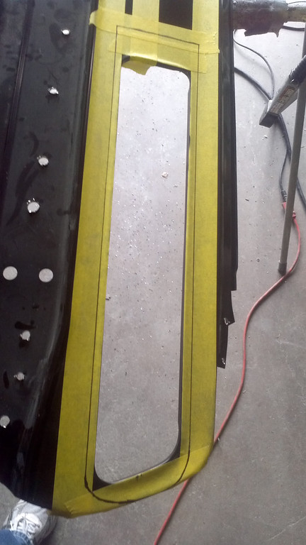

    Here is the tail light panel from the 69 camaro where the spot welds were drilled out to remove the retaining brackets that hold the studs to bolt the tail light housing too.
    You can also see that the portion of the tail lights area has been marked out were we are going to cut the parts out that we will use.
    One of the retaining brackets:
  14. Cruzin Illusion
    Cruzin Illusion Enigma
    Feb 3, 2008
    1,133
    Commerce City, Colorado
    1972 Grabber

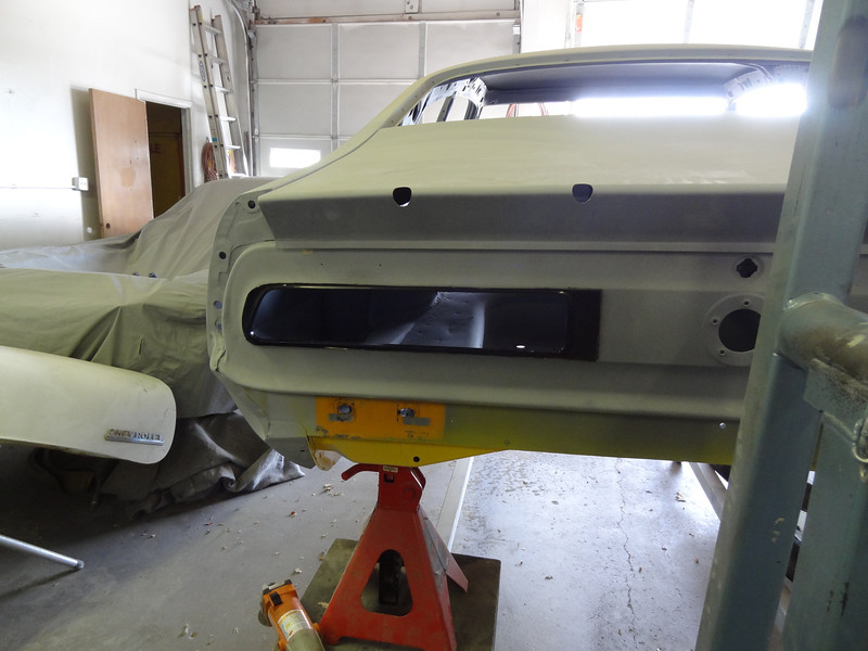

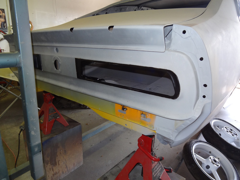

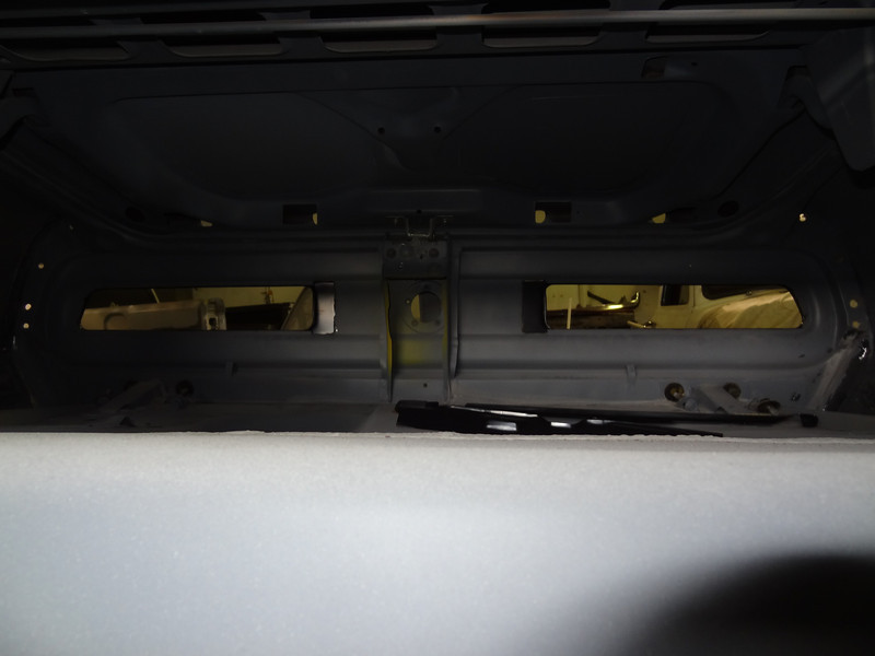

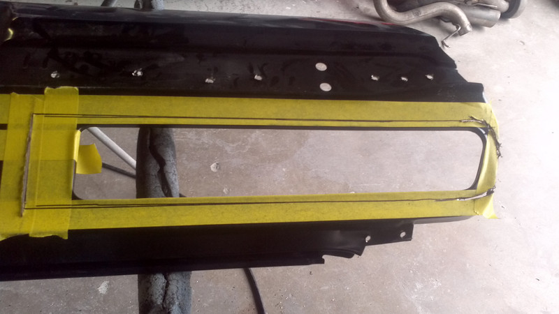

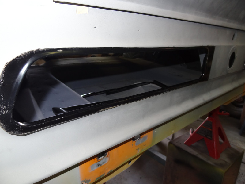

    Here are the pieces cut out and placed in the areas of the tail panel of the Maverick. The metal has been cut out in the Maverick tail panel and pieces are in place were they will soon be welded in and finished off.
    Holding the Grabber Spoiler end piece to show the curvature;
