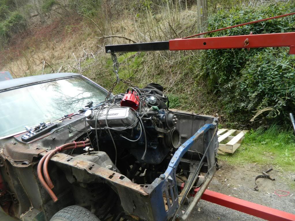

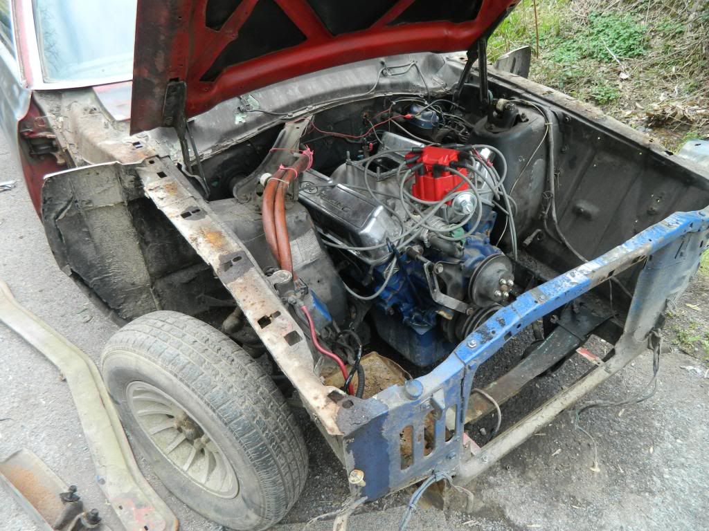

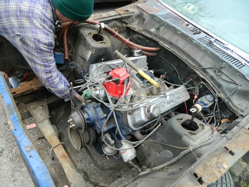

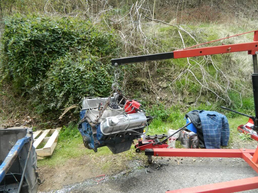

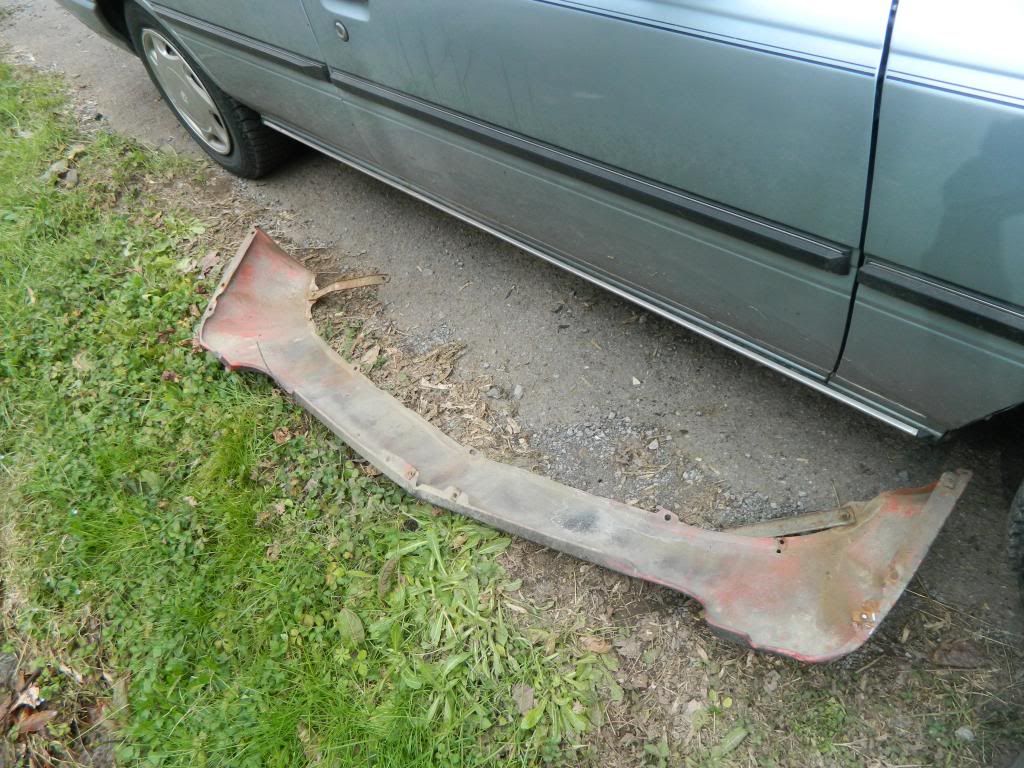

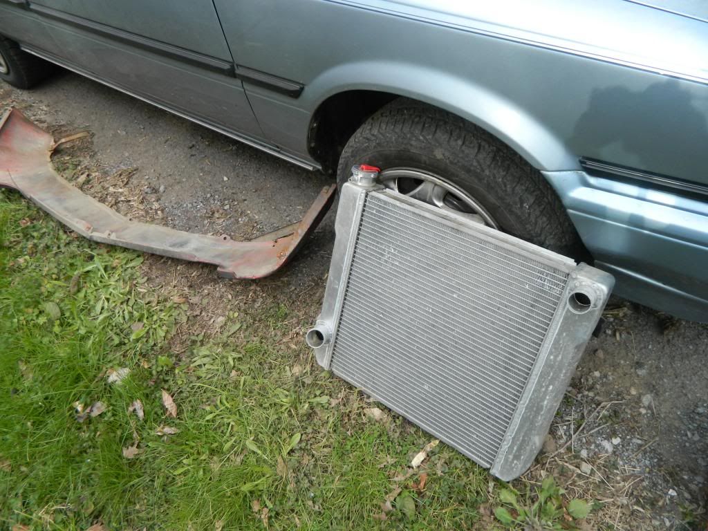

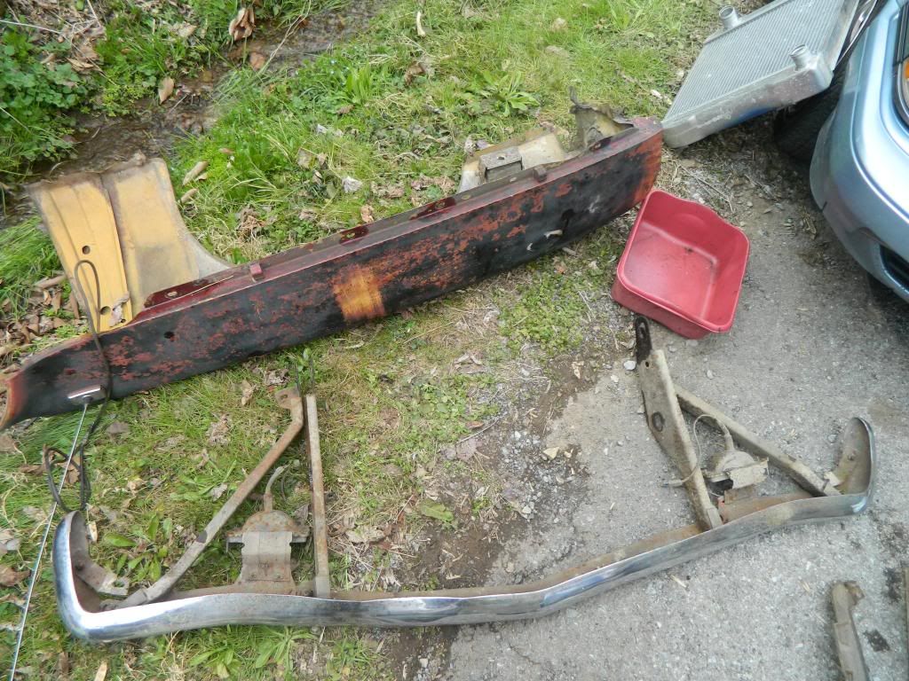

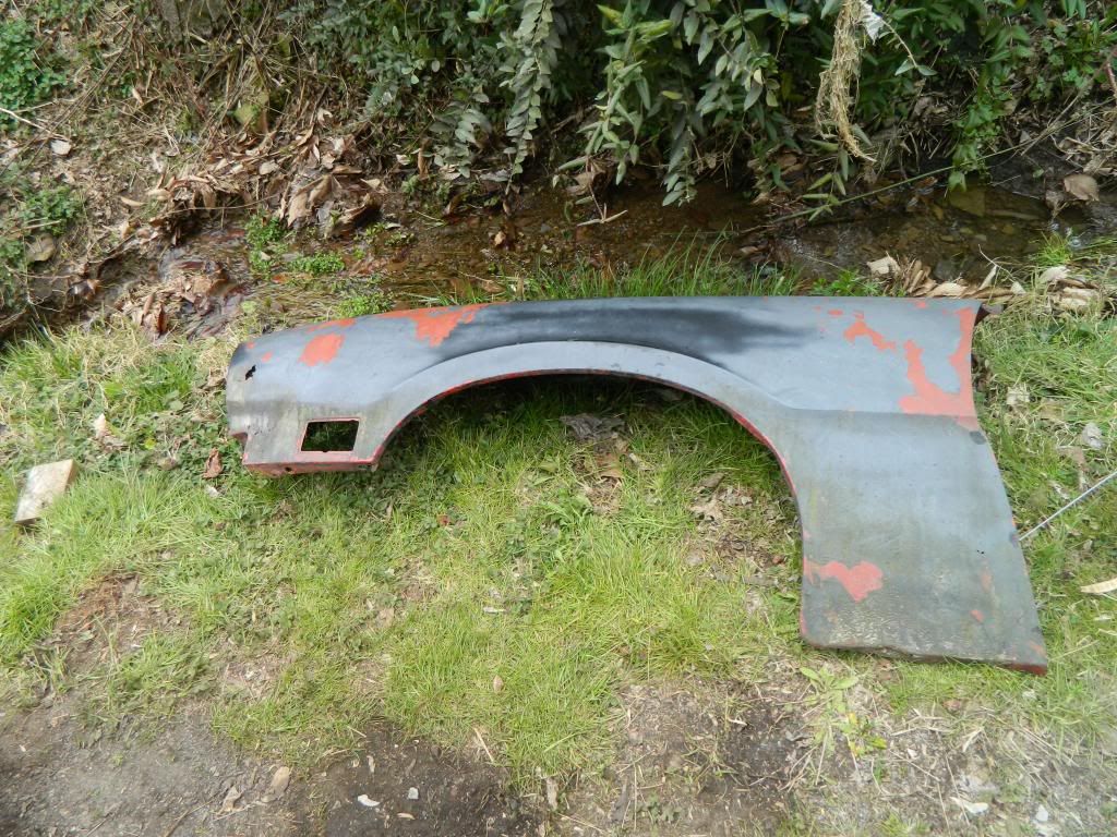

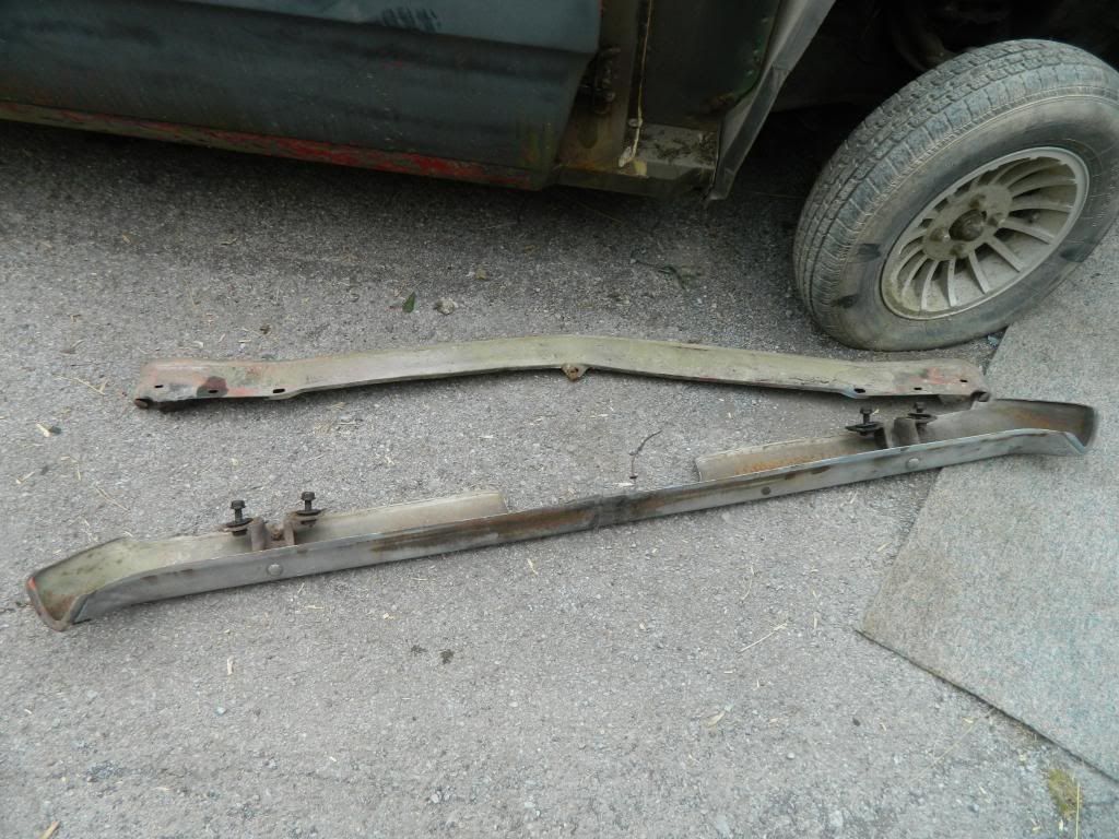

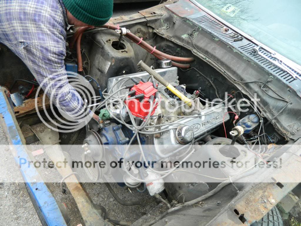

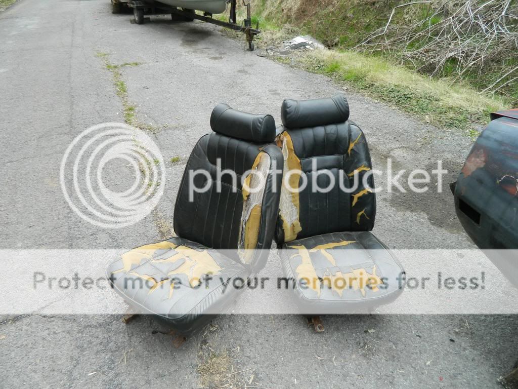

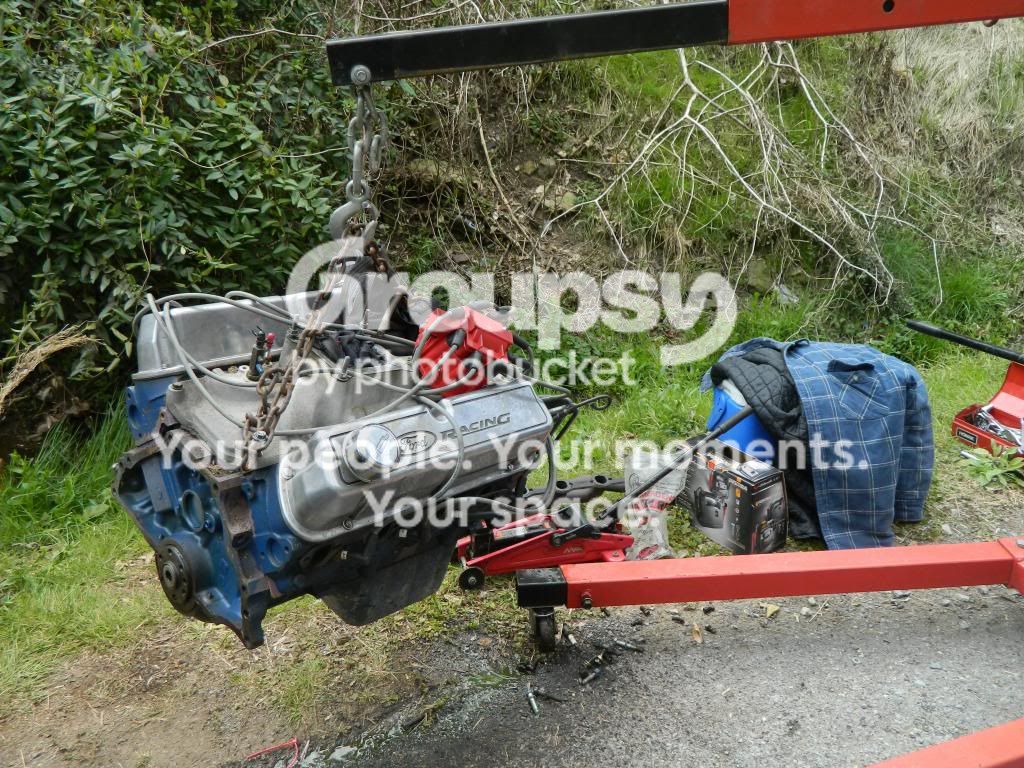

I came across a good deal on a parts car a few weeks ago. It's a 71, with a v8. Most of the front frame is gone, quarters, cowl, floor pans, etc. The main reason I traded for the car was the v8 they had in it. This past Sunday, we have just about stripped the vehicle of all the good parts. Here are a few pics highlighting what we accomplished on this project. "But your project is a '73?" you ask. Well, this v8 shown below will be going into my '73 within the next two weeks. All that is left on the engine is the transmission bolts, cross member, and headers. I got quite a few good parts from this deal. Small bumpers all the way around. Bucket seats, grille and round medallion, 3 core aluminum radiator, mag wheels, deluxe gas cap, front and rear valances, rock guard and so on and so forth.

Yes, someone did. From what I could tell, the radiator that was on it wasn't the one that should have been on it. All the hoses were spliced with couplings and crossed a bunch of ways. I'm guessing they made all those tabs to make up for it being the wrong-fitting radiator.

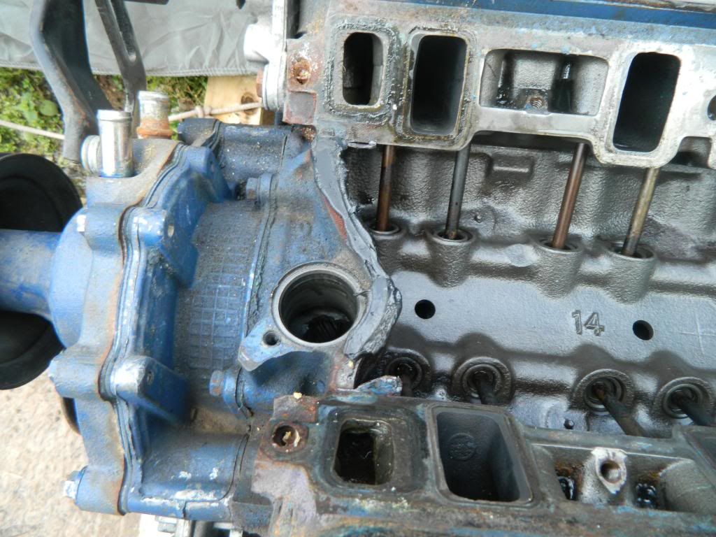

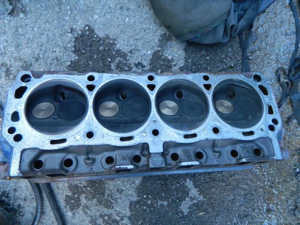

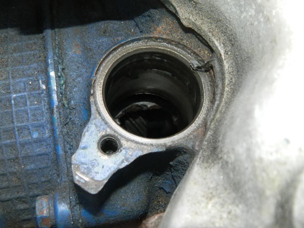

Got a few more things done today. Got most of the engine took apart. Good thing I did too. Something has happened down inside where the distributor goes. Lots of chewed up metal. The head gasket was blown. Found little pieces of metal in the heads as well. Also, they used caulking/silicone for an intake gasket. Here are some pics. Any ideas as to what happened where the metal is chewed up? Also, anybody recognize what pistons they used?
