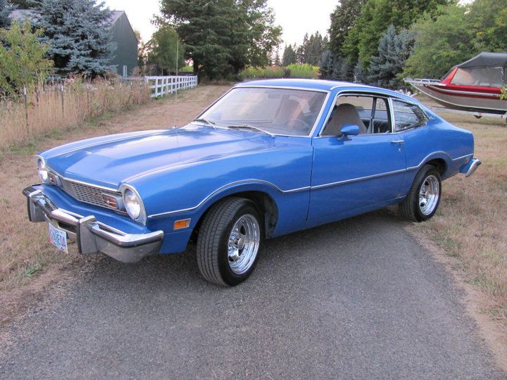

    A little bit of background: It's a 74 with the 250/C4 combo. Bought it with roughly 120,000 miles on it for $1500 running and driving when I was 17. Since then, I added 1994 Ford Windstar Minivan seats, a glasspack muffler, battery disconnect switch, 15" wheels and tires, and I replaced the distributor last winter. I've been steadily buying parts over the last year or so, having collected most of what I need for the build by now.
    Here she is after the new wheels and tires four years ago:

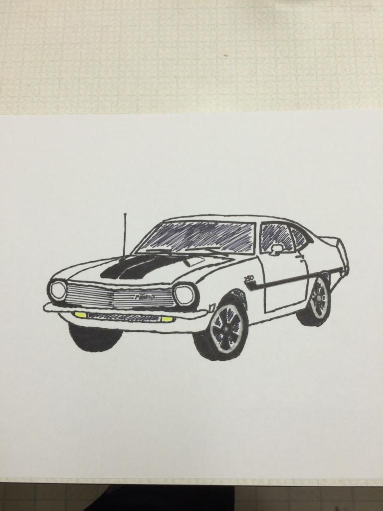

    Here's a rough idea of my end result:
    The plan is a white with black accent (or stormtrooper if you prefer) look with effectively zero chrome minus the lip on the wheels I'm looking at. The spoiler will be a custom taller grabber style (I've got a grabber spoiler to use as a base). 17x8 wheels, BilletArt's billet grille, small bumper swap, halo headlights, Corbeau GTS II seats, disk brakes, grabber hood, Sound Ordnance powered audio, power locks, AC to be converted from a different model car, T5 swap, and possibly the unisteer rack and pinion.
    The best part? I'M KEEPING THE 250.
    After extensive research, many personal debates on pros, cons, and cost, I've decided to keep it and build it. I'll be going all out with all of the Classic Inlines goodies, to include the aluminum head. "But you could get a 302 crate motor making 300hp for less than what it'll cost you in parts!" Yep, but like my motivations for many of my choices (the maverick in general, the paint scheme, bringing the modern touch to it, etc) I'm doing it because it's different. For a while I was just thinking of a grabber clone and keeping it stock looking, but that's by far the most common route in this community. Absolutely nothing wrong with it, but not really my style.

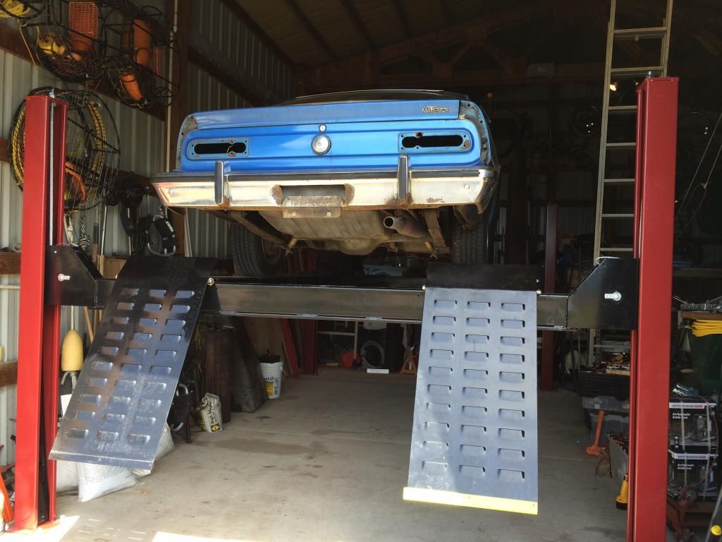

    I began by pulling the interior, removing lights and bezels, and pulling off a lot of the trim. Then I pulled onto the four post lift we just installed :thumbs2: and took the bumpers off. Here she is after I got her lifted up.

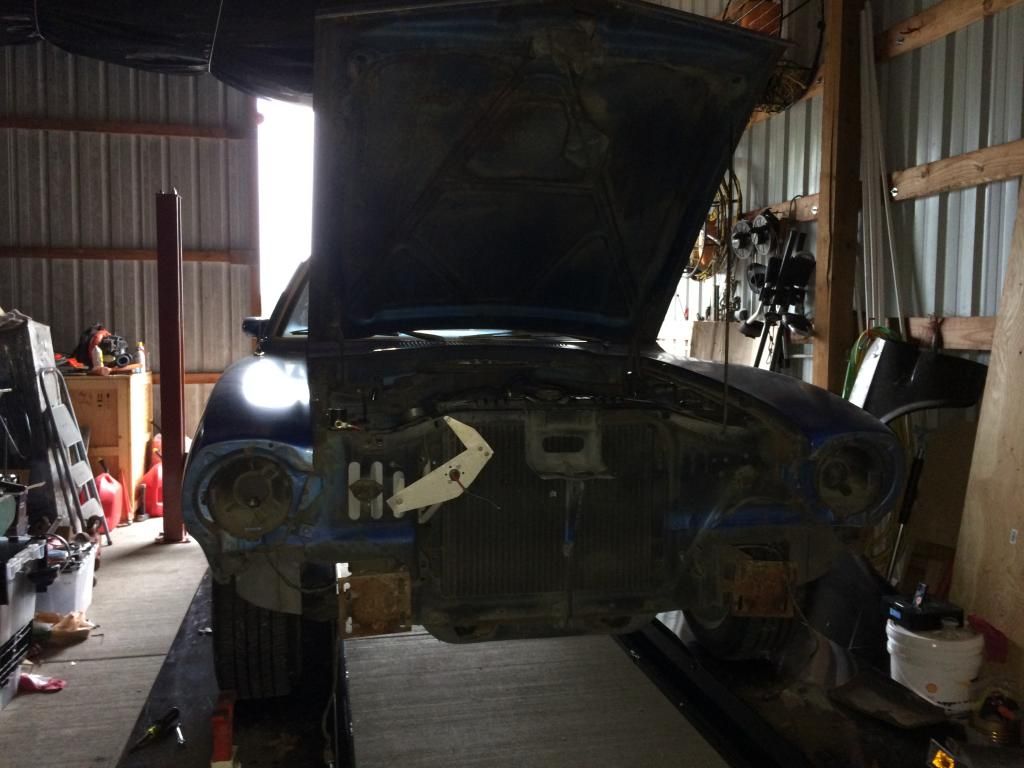

    And here she is as she sits now:

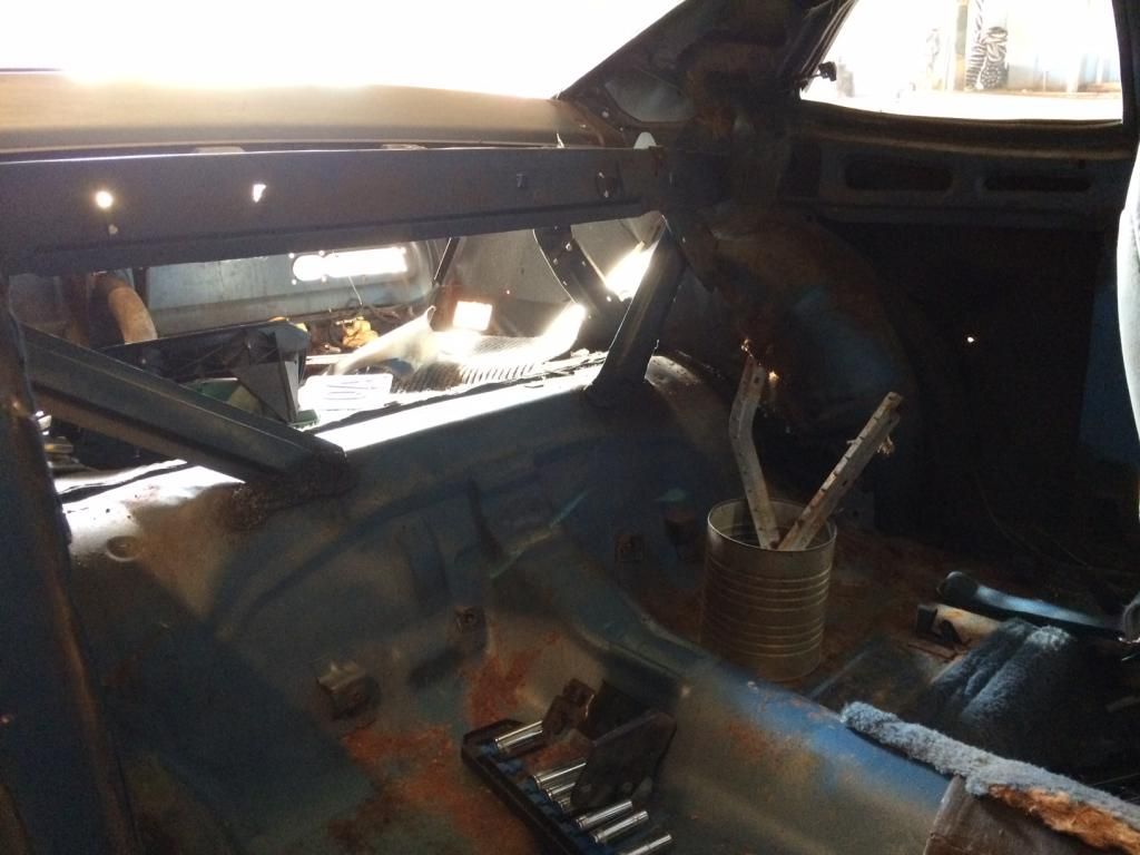

    Got more of the interior stripped out. Pretty tedious project for one person unscrewing all of the little odds and ends in there. Dash pad was especially fun, but I got that out plus the air ducting and the gauges. The old dash speaker was crumbled to bits and had no wires connected to it (I've always just been content listening to the car/my thoughts as I drive).
    If anyone wants my old gauge cluster, PM me.
    And then there's this in the passenger floor pan. Could be worse, but I'll likely replace both sides because while the driver's side doesn't have any holes, it doesn't look promising.

    are you going to go with repop mustang floor pans, or are you going to do little patches?
  9. 71gold
    26,464
    do you know why the floorpan rusted out?
  10. mav1970
    Pour a gallon of water into your cowl vents and see if it comes out under your dash and onto your floor - could be a leaking windshield gasket but worse case is rusted out cowl vents - find the source of why your floors rusted out before you put new ones in :cry:

    I'll test for the leak source today. My interior had some bad moisture damage, the carpet pretty much rotted out in some places, there's surface rust under the dash, etc. I'll probably have to do mustang pans.
