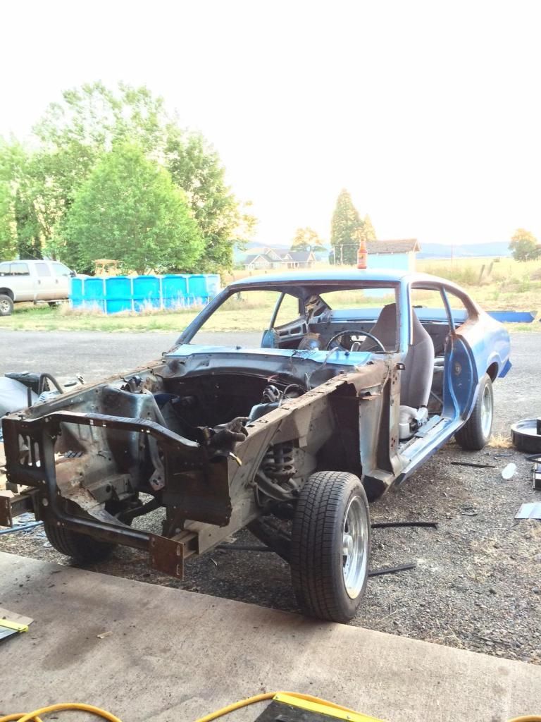

    Progress!
    Picture speaks for itself, car is now almost completely disassembled while still able to roll. More rust in some places I hoped not to find it, but oh well. Underneath the chrome trim by my driver's side quarter window is bad and had bondo over it from the looks of things. One bolt at the bottom of the driver's front fender ripped through, as did most of the bolts in the trunk holding on the rear bumper filler. The trunk is in bad shape from appearances, but once it's blasted then I'll know for sure.
