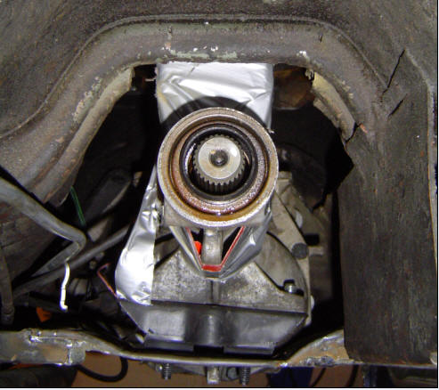

    Is it just me, or does it look like the transmission is "twisted" and the tranny cross member has been cut/welded to contribute to this "twist"?

  2. Bryant
    it does look twisted.
    i know chevys twisted the t5s in the camaros. i wonder if thats a camaro t5

    I went back and looked at the pictures and I agree something does not look right with transmission. It does look like crossmember has been modified to correct something that is out of spec.

    Looks like my original cross member from my 69.5

  6. Bryant
    the second pic is a camaro t5 in a datsun.
    the angle looks right but the tail shaft housing has torque arm mounting bosses on it that the one it braess does not.

  8. braess
    braess Member
    Mar 27, 2013
    270
    173
    Buchs Switzerland
    Ford Maverick GT 1974
    yes, the crossmember was adjusted by the shop. maybe you remember previous post, where i showed how the engine was in with wrong motor mounts and twisted. so the t5 was twisted at the beginning as well.
    then they adjusted it a little, but still with the wrong mounts.
    i am now with the right mounts and will adjust the right pinion angle where the engine will stay.
    so ill need to adjust the crossmember to be perfect to that.
    but it will always hav an angle as the suport of the T5 is at an angle, even if the shifter is perfectly straight up.
    check this image as example, in mine its not as visble.
    (c) http://www.schwallers.com/images/T5Swap7.jpg
    my T5 is just like that, even if its straight in. (its a 96 T5 out of a v6 mustang)
