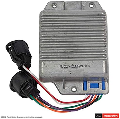

    Did you get the correct ignition module? Did it have the same color connector as the previous one? The one below is blue. There are about 7 different colors and some are not interchangeable, though they can be plugged in. My 75 had a green module and blue would plug into the harness but it would not work.

    we got the right ignition module. we will get a multimeter. distributor should be good because it started when we first got it by putting gas in the carb.
