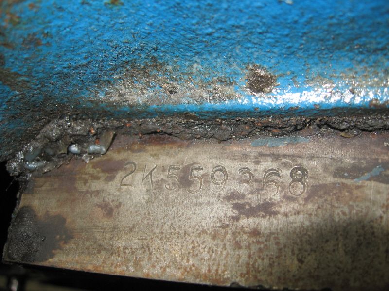

    Nick, post the partial vin number on top of block, behind intake & I'll tell you year and what it came out of... This is stamp on my Comet, later engines use two letters and six numbers...
  12. Mr Nick
    Mr Nick One with many questions
    Mar 3, 2013
    294
    52
    Grapevine, Texas
    1971 Four-Door Maverick, 1962 Cadillac Sedan deVille (soon)
  13. Mr Nick

    That's an exploder motor with gt40p heads, notice the 4 bars on the heads. Headers will be an issue with those heads.
