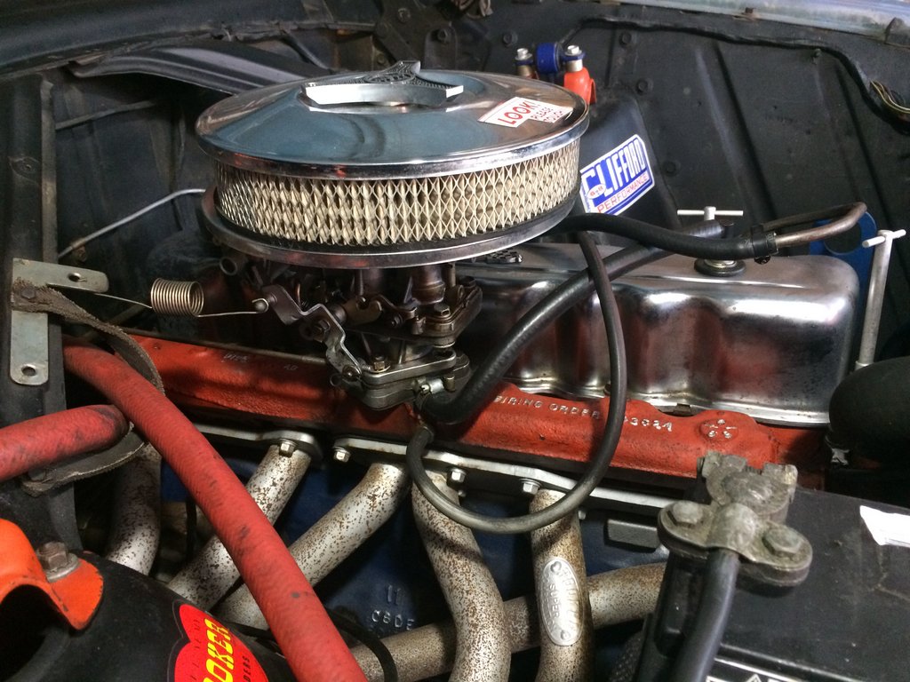

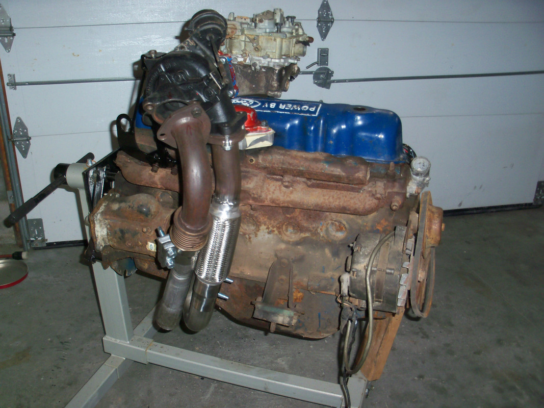

    C8DE w/High mount starter is definitely 200 or 170. Under the Exhaust , 5 Freeze plugs is a 200 and 3 Freeze Plugs is definitely a 170...
    D5DE ('75 series) head is nice later head -w/ larger valves used on all the later Small Block Sixes 200/250 -
    ( 200 likely, don't think any 170's by '75 ??)
    3 Frz Plugs on this C8DE 170 from a '71 Maverick in '63 Falcon Wagon
    5 Frz plugs on 200
    later Fairmont application 200 inline six Diaphragm clutch set is a great upgrade - just needs to use original type Throwout Bearing with it.
