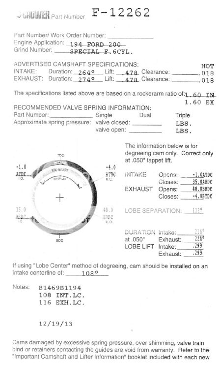

    When I was originally doing my homework I wanted a solid lifter set up with a mid-range cam. After researching different vendors I never really came up with a solution.
    From Classic Inlines, I went to each of the vendors, Crane, Clifford, Comp Cams, Isky , Schneder and a few others. I didn’t really see what I was looking for and as stated above, one of my main requirements was “solid lifter”.
    Of what I found, the ones that do make a solid lifter start at the high end 278/278 and above, so that’s why I ended up buying the 278/278.
    So I called around a few places to see about getting it reground and decided to go with Crower about 45 minutes away. I have to say, awesome service! They had me taken care of within 24 hours. I fully expected two weeks! To top it off, it came with a cam card, a big tube of assembly grease, stickers and packaged up just like brand new. If you’re in the area, Ramiro at the front desk on the shop floor will treat you right!
    I’ve included a scan of the cam card for your perusal. I went with a dual pattern as advertised 264/274 @ 112⁰. *Note to self, next time buy a custom grind from the beginning, save yourself time and money….. Crower had blanks too, Ramiro knew what I had within a nanosecond of opening the box and knew just about what I was looking for right off the bat.

    still a healthy cam for that little motor but the shorter overlap/wider LSA will help you build cylinder pressure down low and into the midrange quite nicely. Should idle nice and smooth with a small hint of "healthy".. and make excellent vacuum too.
    Have any other build spec's to share with us?

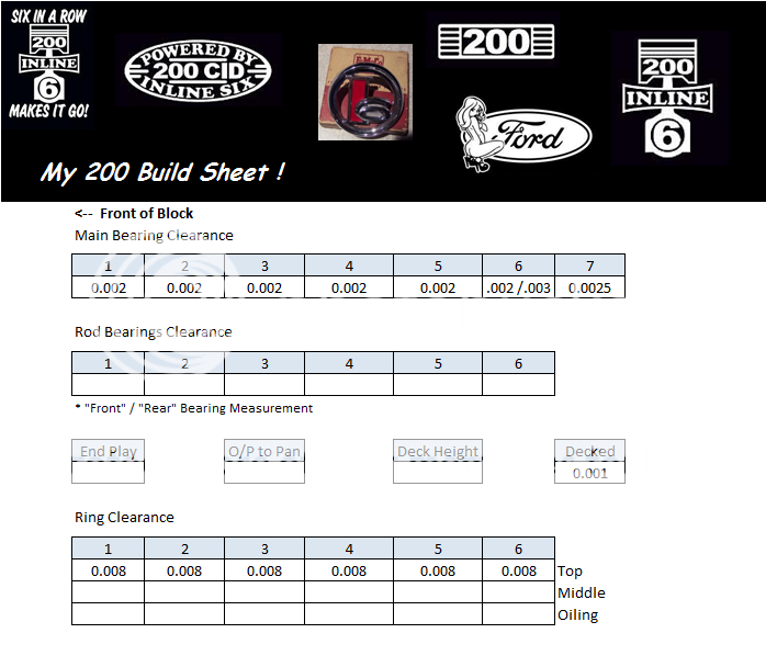

    I've been playing around with a build sheet, my notes and junk.

    ok.. attention caught! lol
    And hopefully those figures for the top ring end gaps are just a randomly inputed number or you'll butt the ends when that thing warms up real good. ;)

    Everything on my sheet so far is actual, I put the top ring in each cylinder and squared them up by pressing them in about an inch with a piston. After that, I measured each gap with a feeler gauge. Classic Inlines specifications calls for a Compression Ring Gap of .015 + .005 and an Oil Ring Gap of .020 + .030. I was hoping to get all the rod bearing clearances and ring gaps measured today. I’ll post up my results later today.

    Got my measurements done today, I did however come up with a different result on the top rings than the initial measurement. What’s the old saying measure three times and cut once? We’ll this time I triple checked all the rings and even moved them around between cylinders until I got the same results all the way across. Got them all bagged up per each cylinder. Not sure why I got what I got the other day except that I was in the middle of some honey dues. I had a few minutes between projects.... Focus grasshopper, focus..!!!
    Any suggestions on clocking the rings? My initial thought was to make a star (five sided), separate out the top and middle rings as far apart as I could get them. See crude graphic below.
    For the graph below, front of the engine is ---->
