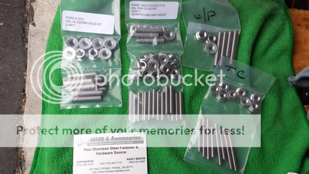

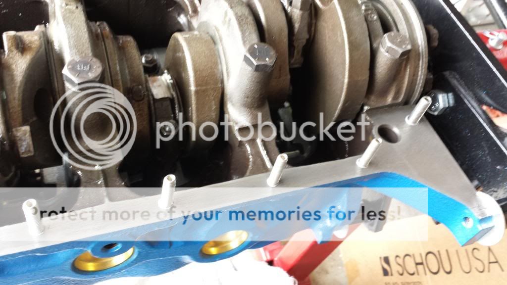

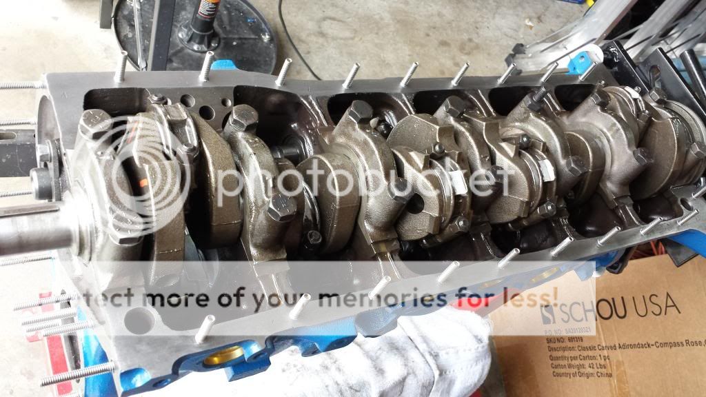

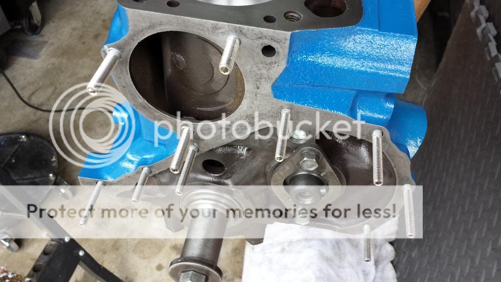

    Made some more progress today, got the flanges cleaned up and installed all of the studs minus the timing cover studs (that’s next). Used a dab of anti-seize on each one and popped them in. Pretty fun job!!
    And, if anybody has any interest, I got the kits from the below company. They didn't sell the timing cover and water pump kits on there site for the 200, so I had them make me up a set. Easy folks to work with, turn around was quick to, good vendor.

    nice! how much did the stud kit cost you?

    Just under $60.US including shipping. I did'nt think that was to bad and the quality appears really good. They all have a allen/hex key at the head for easy install and adjustment once the parts in place. I'm happy!

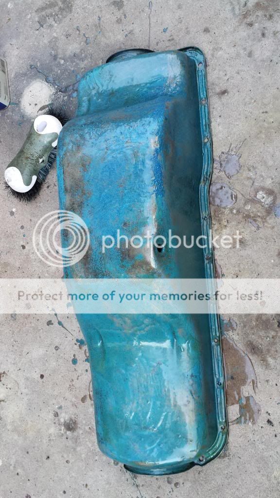

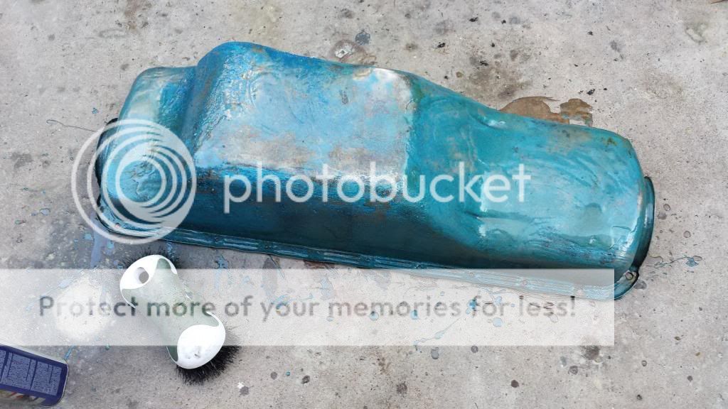

    Sourced a pan, dip stick, dipstick tube and pick up. I just started on the pan this morning, currently stripping it (many thanks goes out to doncomfort!) and the team of strippers doing their magical dance.

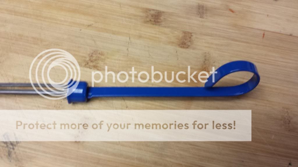

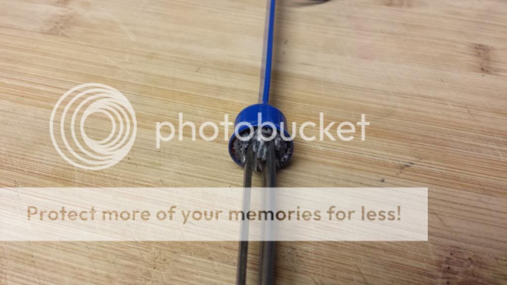

    Finished the dip stick and installed a makeshift dipstick cap seal. Also been busy on the consolette and ordering parts for the suspension rebuild. That and last week a rear wheel cylinder went out. I replaced the driver’s side just to get up and running but I have the parts for the passenger side and all new brake hoses. Oh and replaced the master cylinder just for good measure. Lots of irons in the fire! My goal is to get the suspension done in time for the show, it would be nice to drive up with all the work done!
