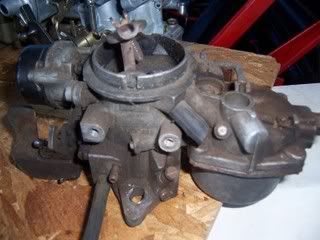

    The RBS carb used on the 250's is really a pre-emissions carb slapped on so the 250 could clear the Maverick low hood line. Not a bad performer when in good tune.
    As mentioned, if idle mx screw makes no changes, disconnect all vac sources and test. If still no effect, carb is likely issue since there is no possible intake manifold leak without a head casting crack.
    Loose worn throttle shafts, warped carb surfaces and internally crusty old carbs are best (sometimes only) tested with a carb swap even if temporarily to localize problems.
    I keep a nice clean reliable response Maverick 170 Carter YF carb around for inital startups, and test swaps... .
    A favorite swap for 250 is a commonly available/inexpensive Holley 2300 series 2Bbl though a simple 2 X 1 adapter and with good tune can be a performance upgrade as well. The 2300 is available as 350 peak CFM and 500CFM for modified engines.
