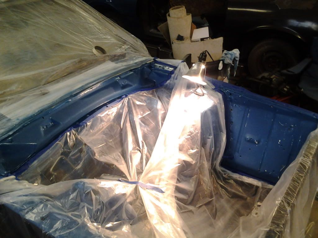

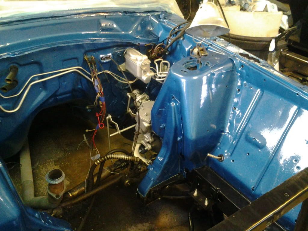

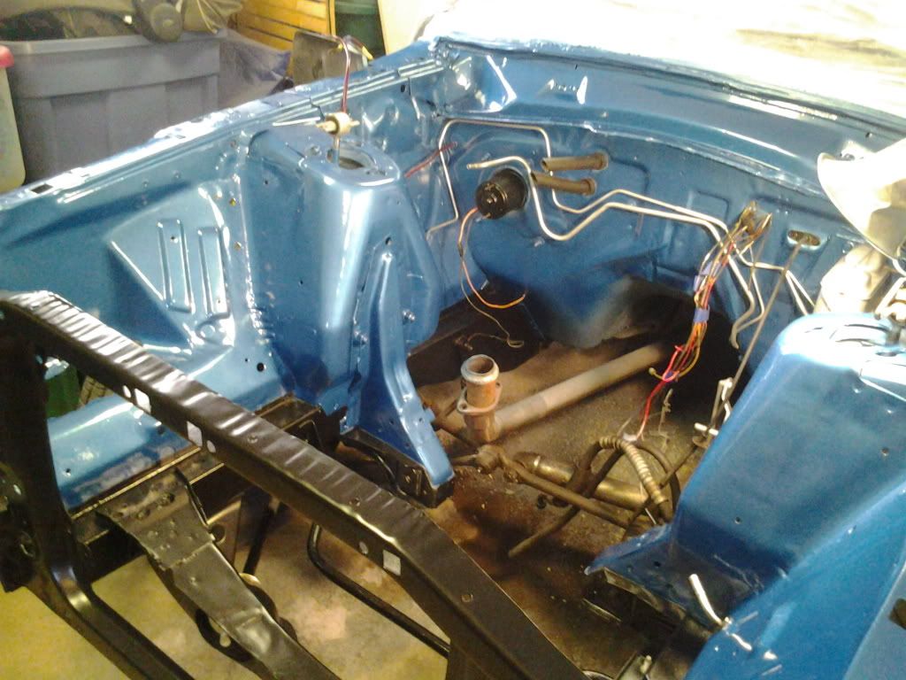

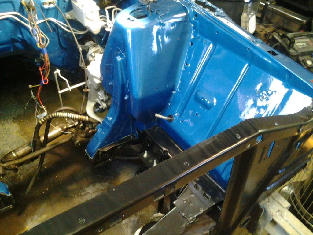

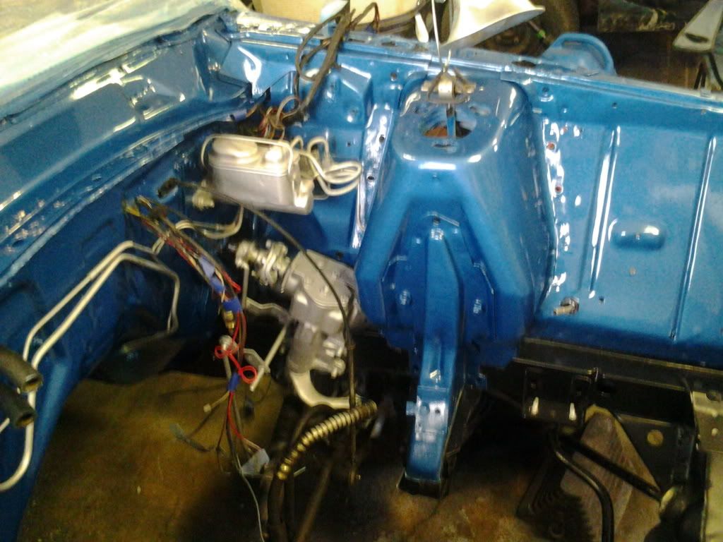

    Went out and took a look now that its dry and its not that bad. I might be able to live with it if I double up on my medication. :rofl2: The shock towers are pretty good, the right front will be completly covered. The left front will be the only wide open area. I think my downfall was at the end. I still had some paint left so I made a heavy pass in some places, they seem to be the worst.
  3. doncomfort
    Apr 16, 2012
    1,289
    chillicothe oh

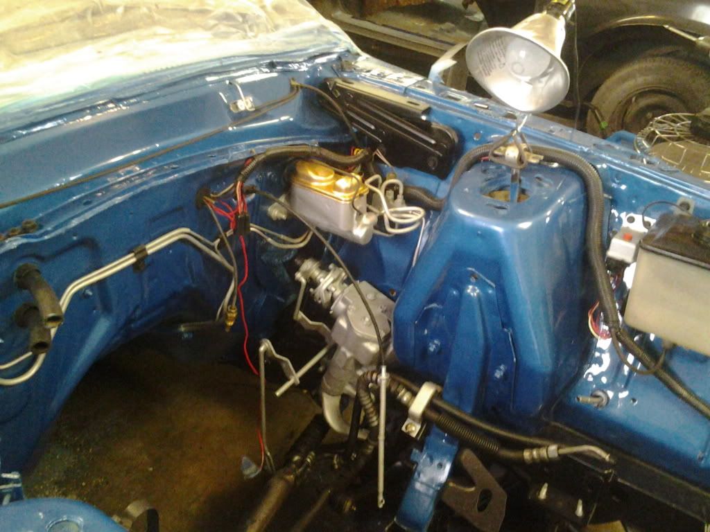

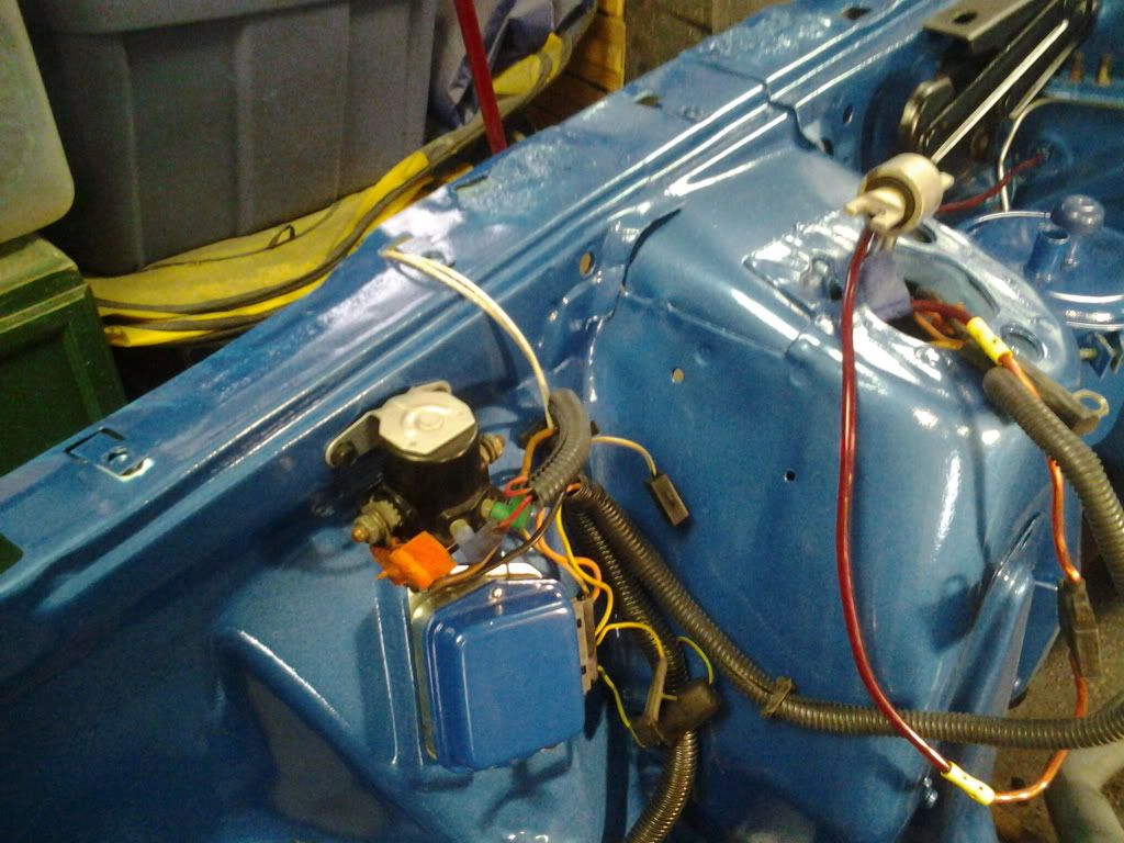

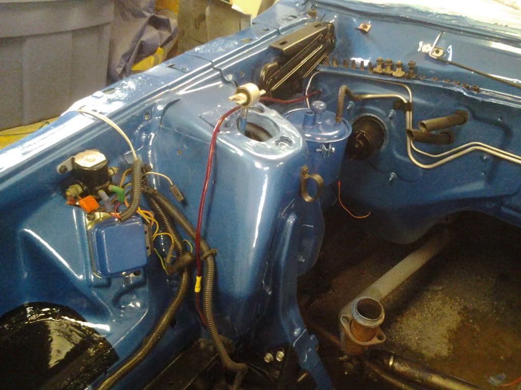

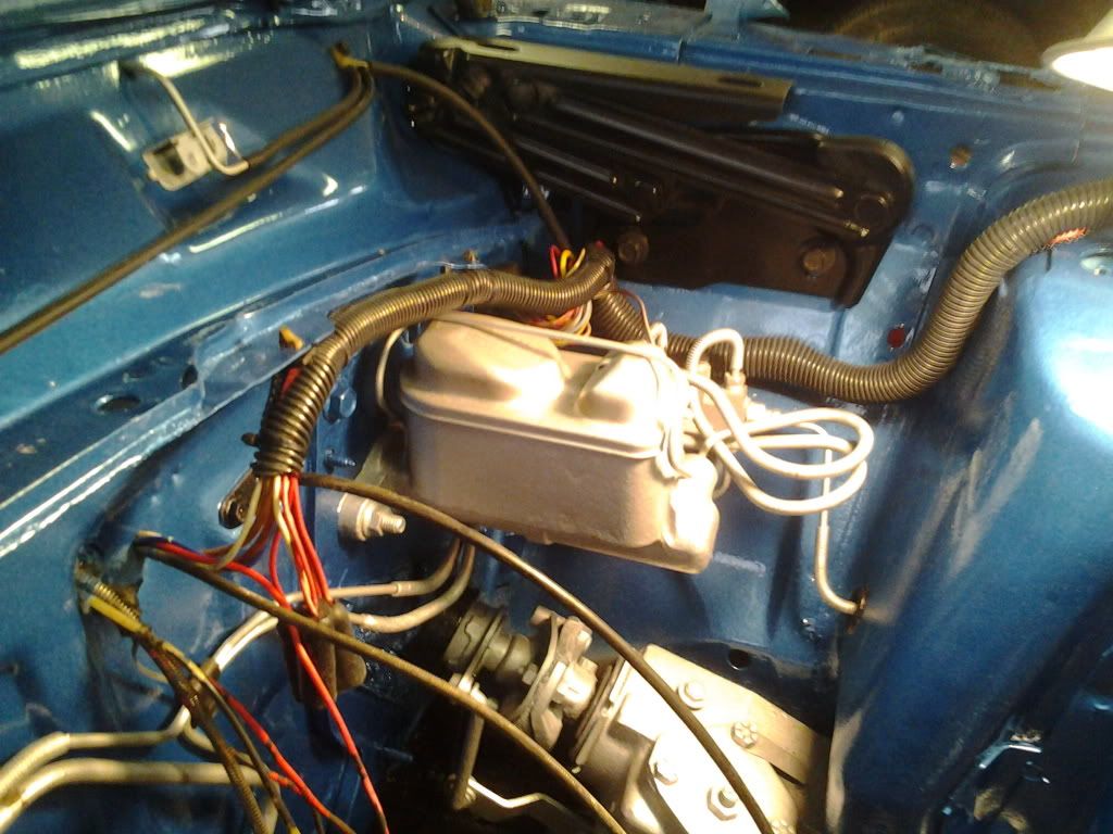

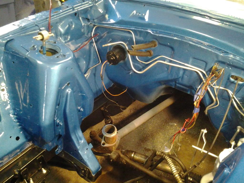

    Redid 2 areas of the engine bay today. The rest is either ok or won't be seen. I am much happier with the results today. I believe I had my air pressure too low on Saturday. First 2 light coats started out the same way. I cranked the PSI up to 35 and it went on much better. Now I'm ready to start cleaning up everything I removed and get it back on.
    Wet sanded yesterday
    Unmasked and touch ups done.

    Glad ur satisfied! Did u remove the mc & steerbox to paint them?
  5. doncomfort
    Apr 16, 2012
    1,289
    chillicothe oh
    Thanks!
    No, I painted them on the car, it was not easy. Next time it's all coming out.

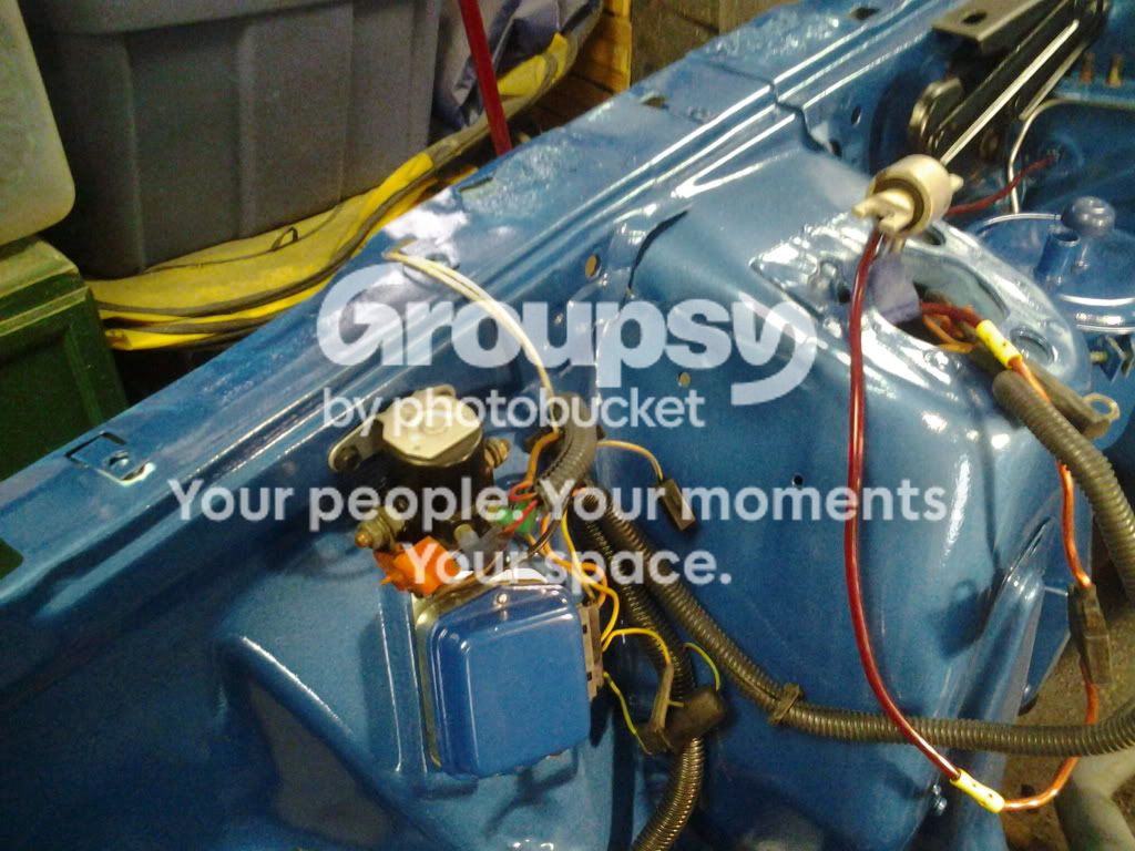

    Spent 2 days in the garage getting things cleaned up and put back. Spent the better part of today fixing the hacked up wire harness around the headlights.
    I'm amazed at all the colors! :rofl2:Everything has been black for so long I forgot what it was supposed to look like.
    Now I need to take a break for a few days, I'm fried!

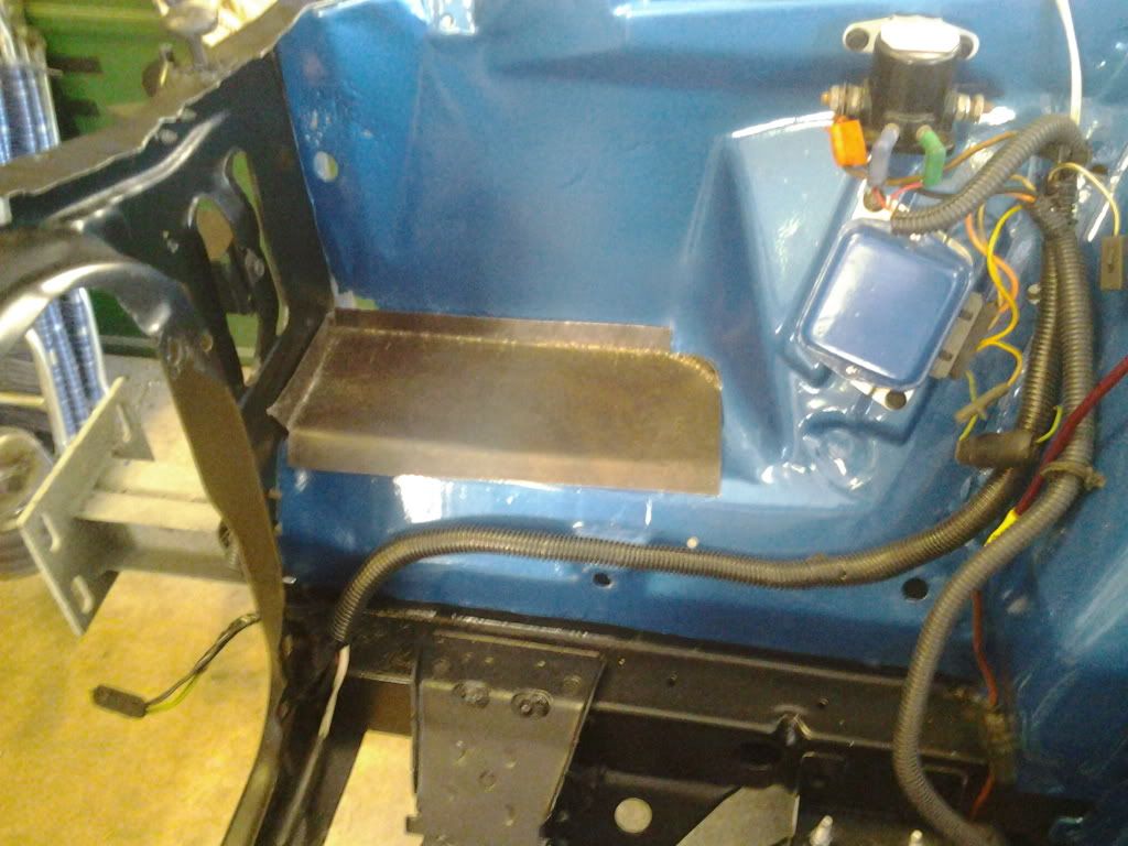

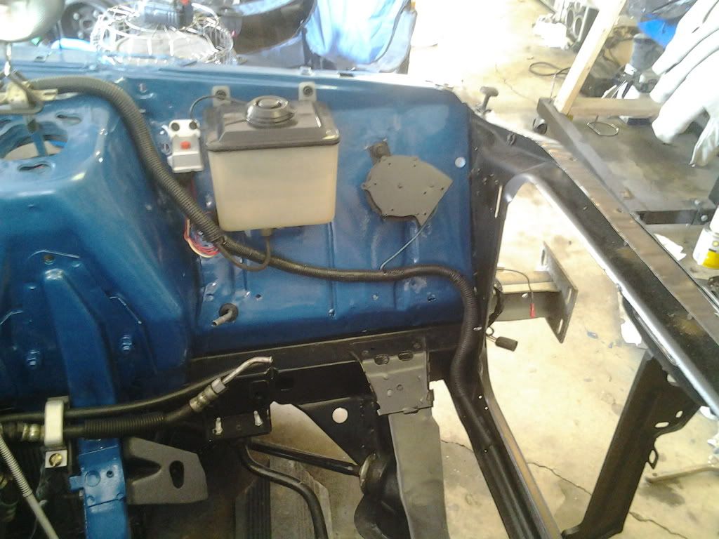

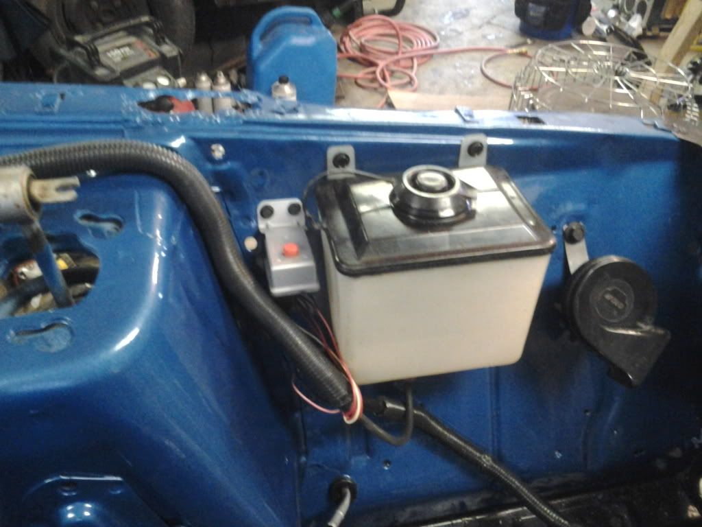

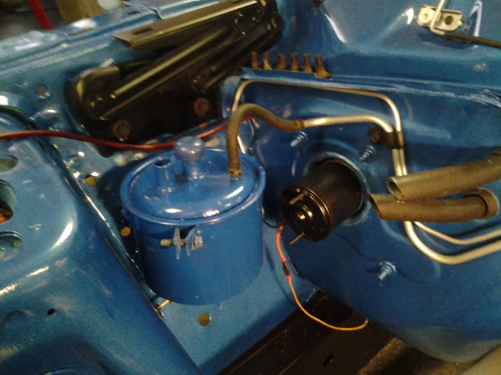

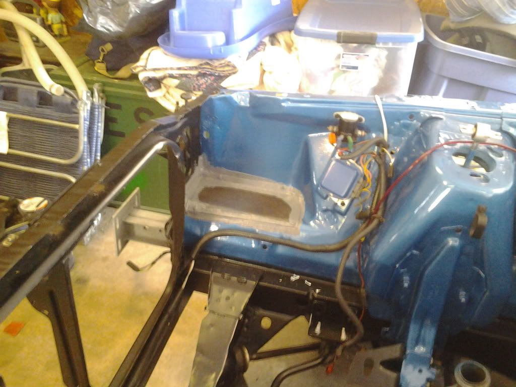

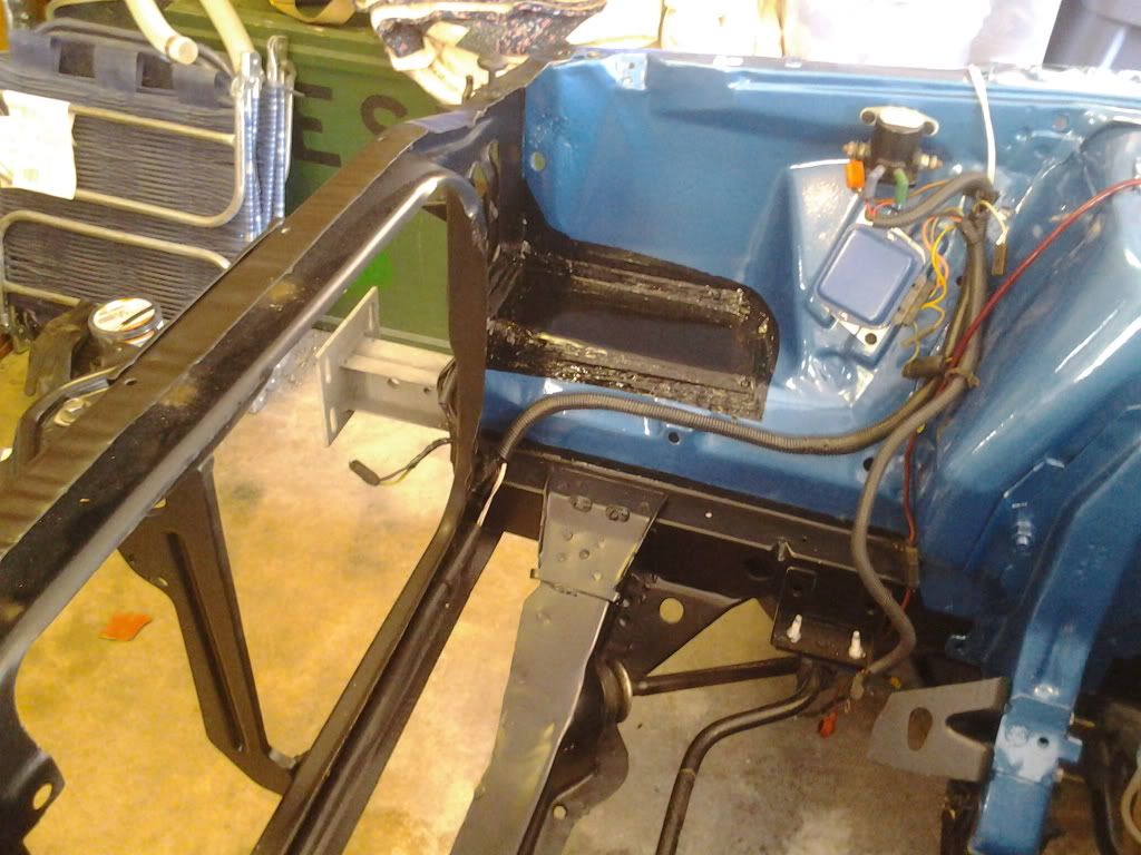

    I know you're getting tired of the same of old pictures with minor changes so I promise, I'm done with the engine bay. I finished cleaning up the wires on the firewall, finished the master cylinder and switched out the horn (I thought my horn was from an 86 Bonneville that I had a long time ago. The one I WAS going to use was off the 72, I thought it looked weird. So I dug through my box of parts and found the horn from the 76 and it was the same as the one I had, so I put mine back.) Installed the engine stands(?), I have a question. I was told to get the mounts from the 250 because they were different. The lower part has the same part number as my originals. Is that right? The last thing I did was make a patch for the rusted out battery area. If I knew how easy it was to make a patch, I would have done it first. I have not mastered welding yet, so it's held in place with sheet metal screws, seam sealed and painted black. should have been blue, but I'm out, so it's black, it won't show anyway, at least I don't have a huge hole anymore. Now I need a new battery tray.
    As I was about to post this pic, I noticed the horn wire looked stressed going into this horn so I just went out and moved it.
    The patch
