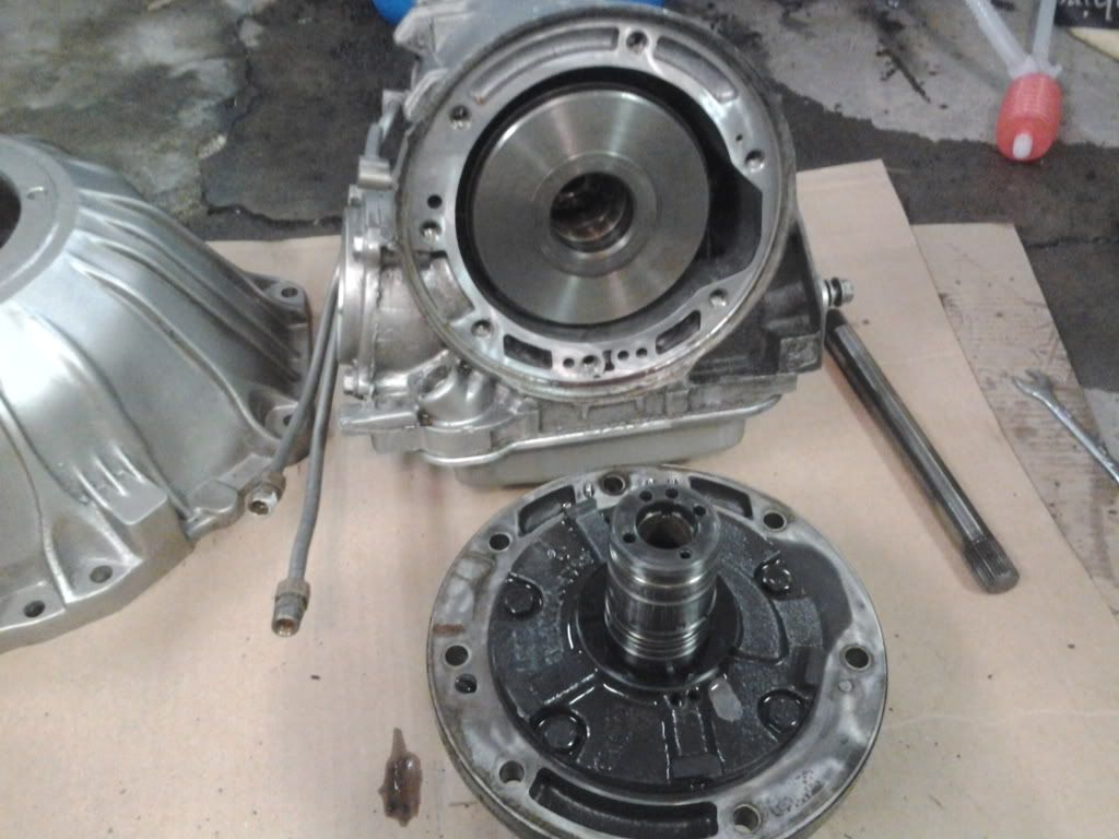

    I cant post a link from from my tablet. Search Doeme's workshop on you tube. I will try to post a link tomorrow. There are 3 parts, disassembly, reassembly and valve body. He goes step by step and gives torque specs as he goes. I learned a lot.
  2. doncomfort
    Apr 16, 2012
    1,289
    chillicothe oh

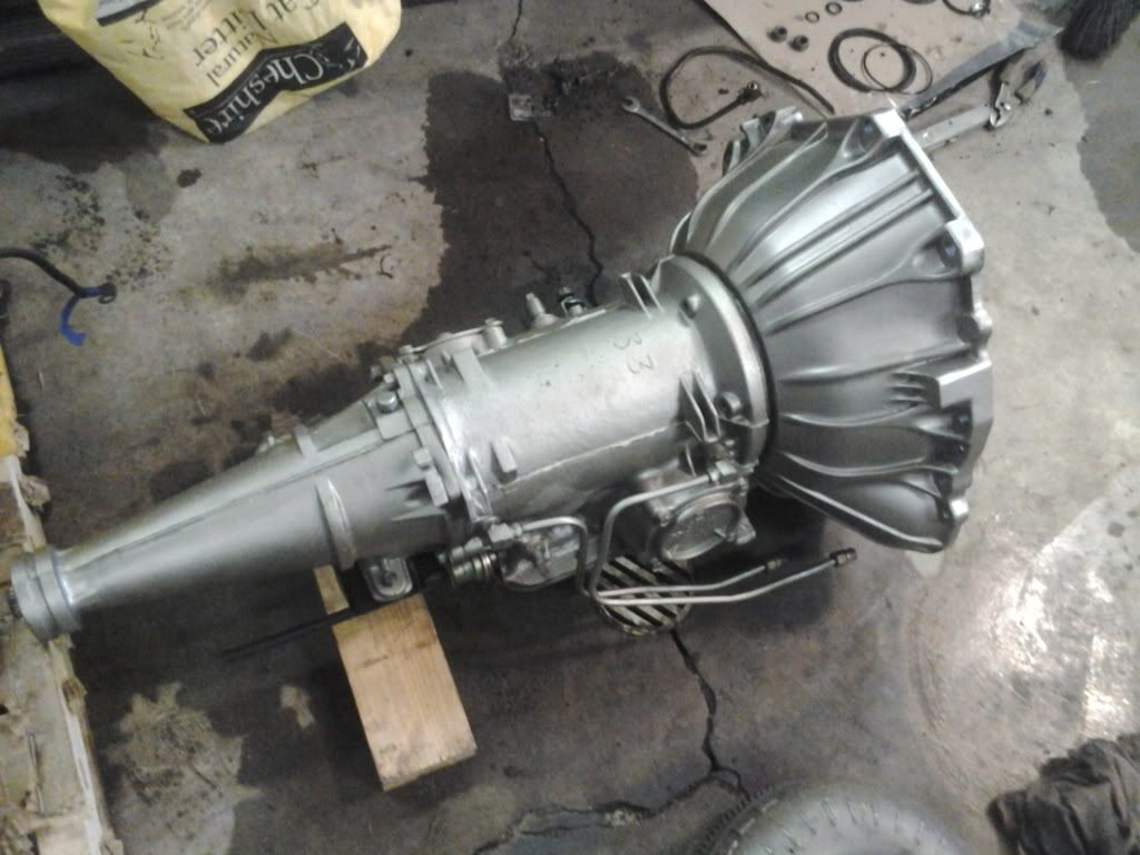

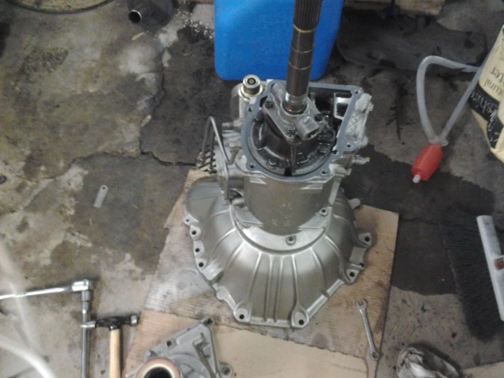

    Whew! I am so glad I decided to check my work on the tranny. The pump was not seated properly. Neither was the kick down lever under the valve body. I went ahead and replaced the paper on the pump and tail section. Also replaced the seal on the reverse servo. Im confident everything ok with it and its ready to go back in the car.

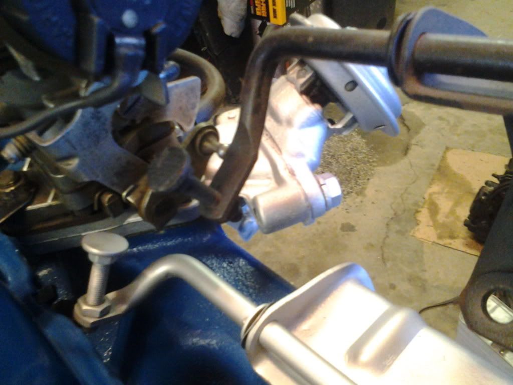

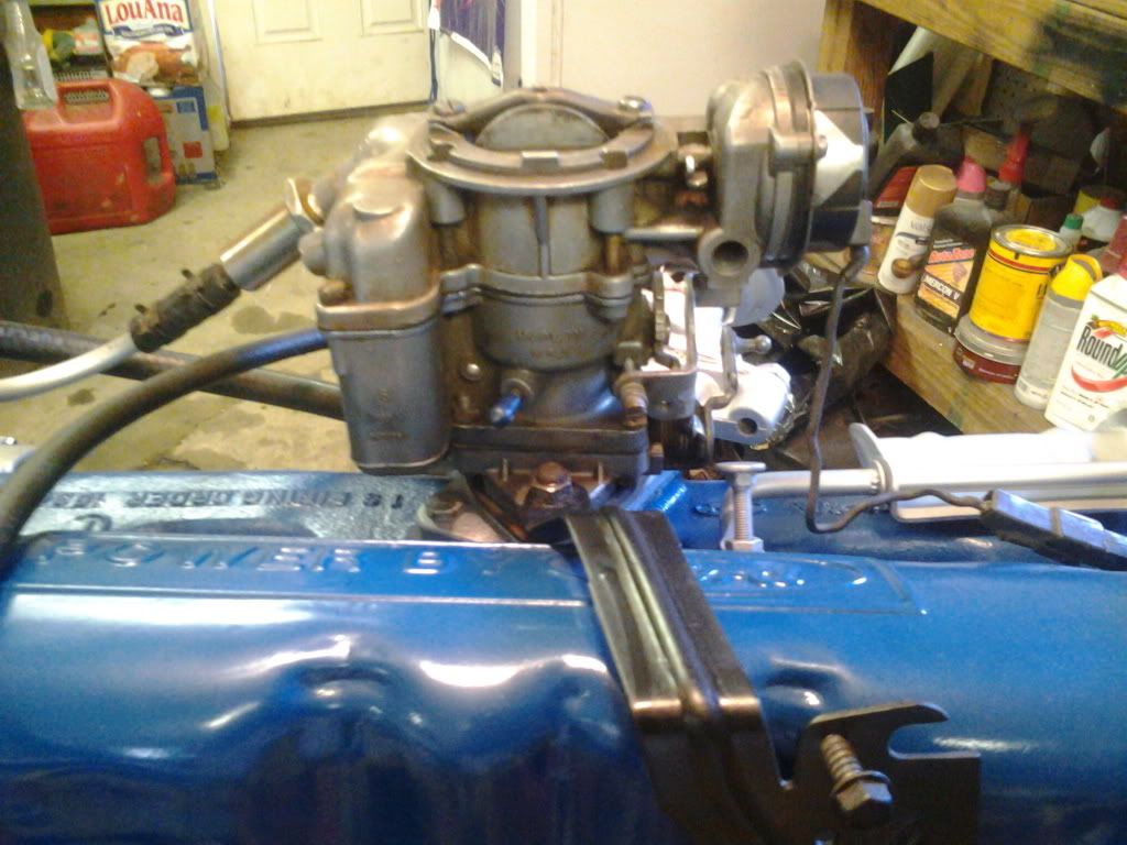

    Rebuilt the carb that was on the 250 when I got it. I drove the car with this carb and it seemed ok, but I only drove it 2 miles. It looked exactly like the one that was on my 200 but I noticed that the one from the 200 was taller than the one one the 250. I guess that makes sense since the 250 is a taller motor, the carb would be shorter. They seem to use the same kick down rod to the tranny, but the section mounted to the head is different. I"m not 100% convinced this is the correct carb for this motor. I bought a rebuild kit for a 72 Maverick with a 250. Everything in the kit was right except the gaskets. I will probably replace it when money is better.

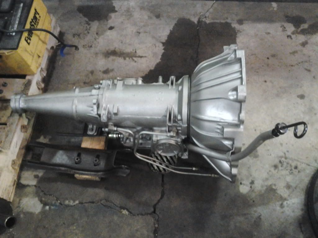

    That's it, everything is done and ready to be put back in the car. I have a cherry picker reserved for tomorrow morning. I"m super excited to get the drive train back in the car. I will get to see how the spring mod affects the way it sits and rectify it if needed. I should be ready to fire it up this weekend. :bananaman
    Here is a pic of the freshened up carb.
    Here is a pic showing the difference in the kickdown linkage.
    Here is another of the other end.

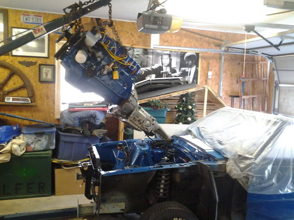

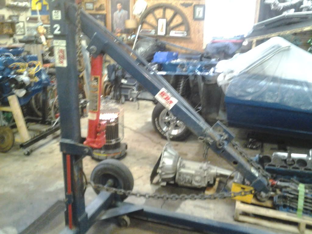

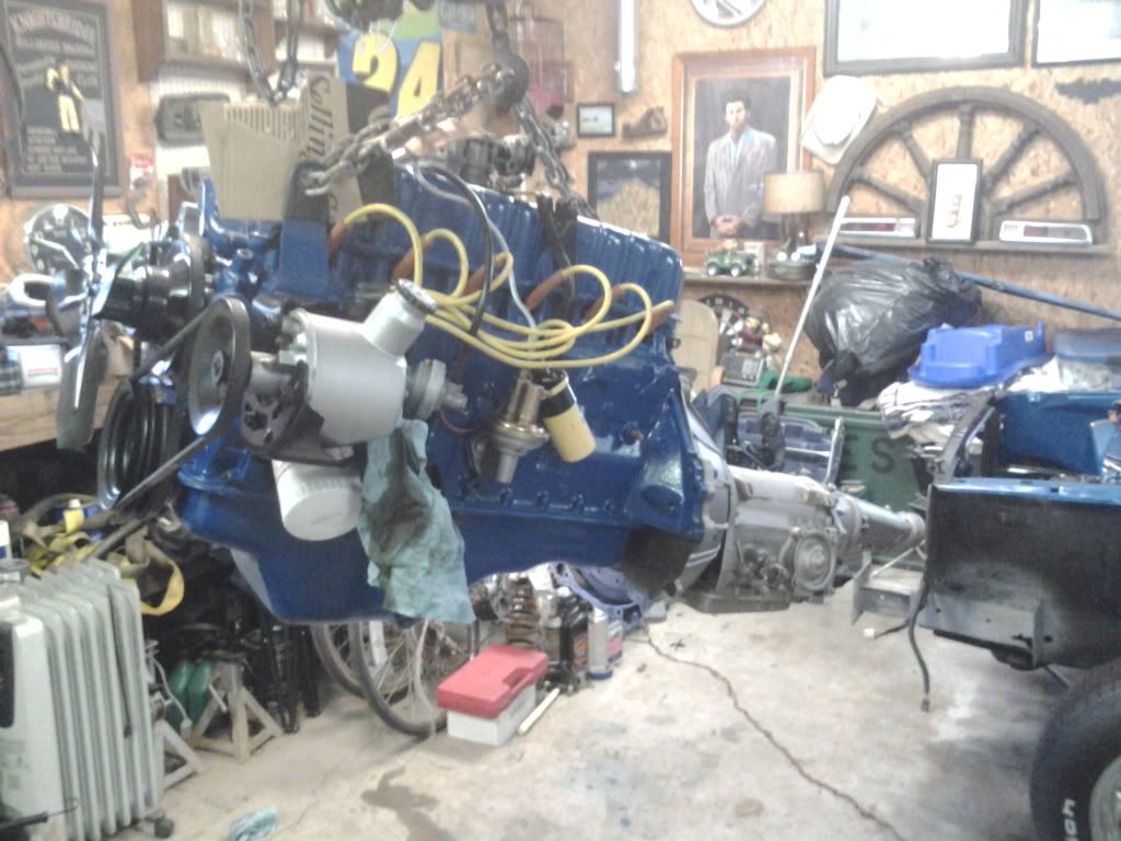

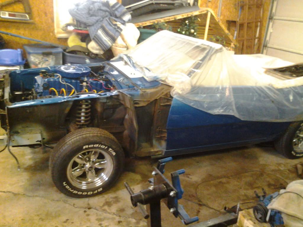

    Was a great day! Picked up an engine hoist this morning and got the engine and trans back in the car. :bananamanEven better than that is the spring mod seems to be perfect. I set a fender in place and even hung the big bumper just to be sure. It lowered it a couple inches I believe. I will know more when I get everything put back, but right now it looks like it will be just right.
    My first experience with one of these. I'm used to using this 10' high wood frame thing I built few years ago. It was a huge and difficult moving it around but it was so nice to do this in a heated garage instead of outside.
    Here is the engine and trans mated up for the first time. Don't they make a cute couple?
    Ready to ease it in my fresh engine bay. I covered everything with big blankets before we lowered it in.
    Here is how the car sits with the cut springs.

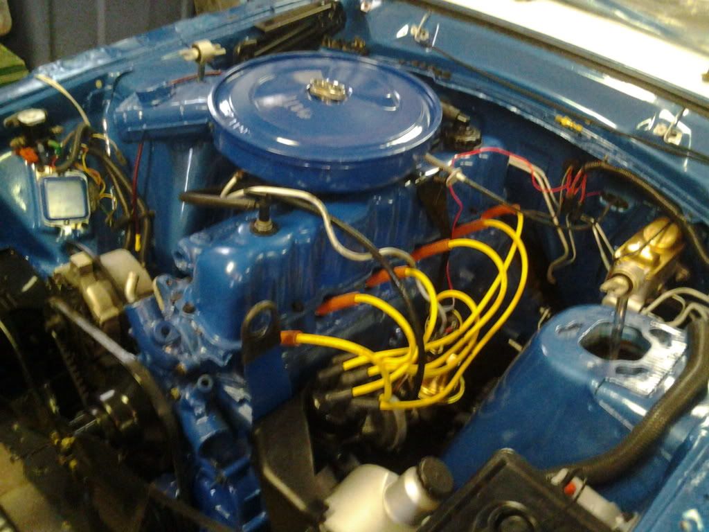

    Here is the 250 in it's new home. Just in time for my car's 40th Birthday.
