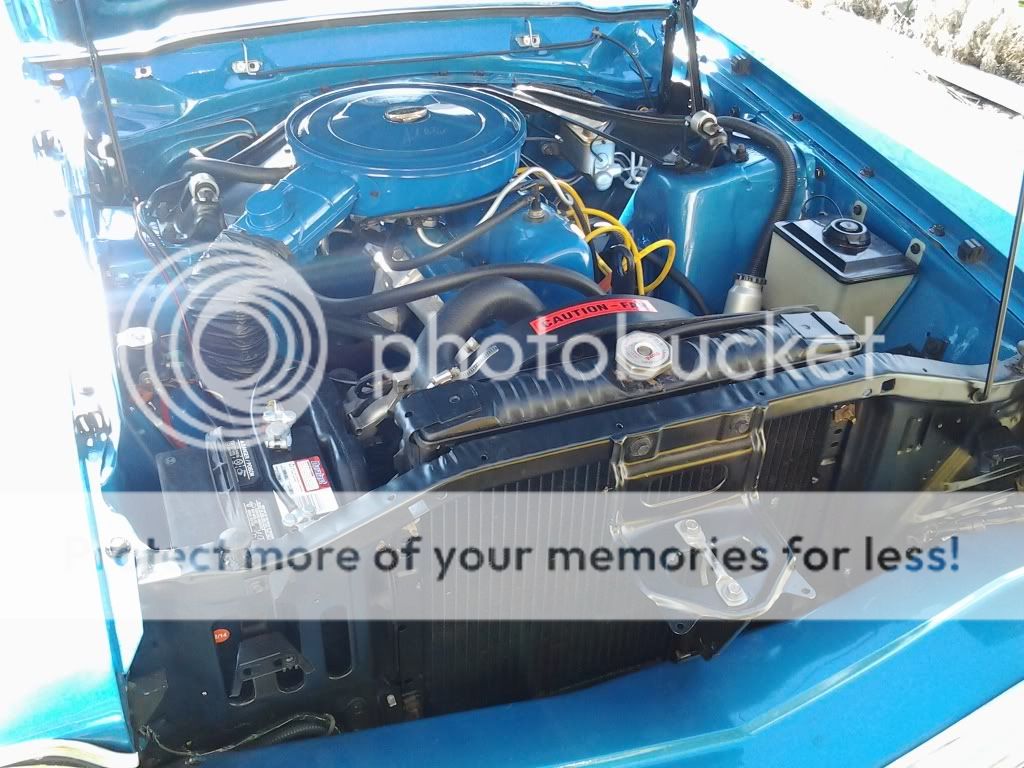

    Did a little tinkering today, nothing major. The shroud wasnt looking like it would fit so I manuvered it into place. Then I couldnt get it out, so I bolted it in. The fan blades are super close on the upper right side. I am going to loosen the radiator bolts and scooch it over to help sith clearence. While I was in there I plucked the timing pointer with my finger. It make the same sound that Im hearing. I bent it up away from the pulley but now I cant see the mark on the damper. I am going to remove it, elongate the holes and put it back. I also cut about 3/8 off my FORD breather nut. Now my hood closes without hitting it. Still so much to do, time is running out!
  14. doncomfort
    Apr 16, 2012
    1,289
    chillicothe oh
    Found a few small puddles of coolant under the car today. Both radiator hose are leaking at the radiator, no surprise. Found a leak at the temp sensor. Hoping that is it.
    I painted a new grill I had, much better than my old one. Finished putting the bumper on and also finished the shroud. Ran the engine and nothing hits, so Im good there.
    The ding ding at start up is definatley the starter. Also found the trans low on fluid, knew it had to be. Book calls for 8 qts and I only have 7 in it. Maybe grabbing at straws but could that have causes the other noise? Seems like I thought it was coming from trans when I heard it. Will know next time I drive it.
    Here is a good pic of the stance after the coil cut.
    Here is a pic with shroud and cut down breather nut
