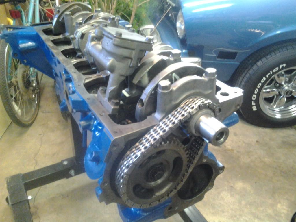

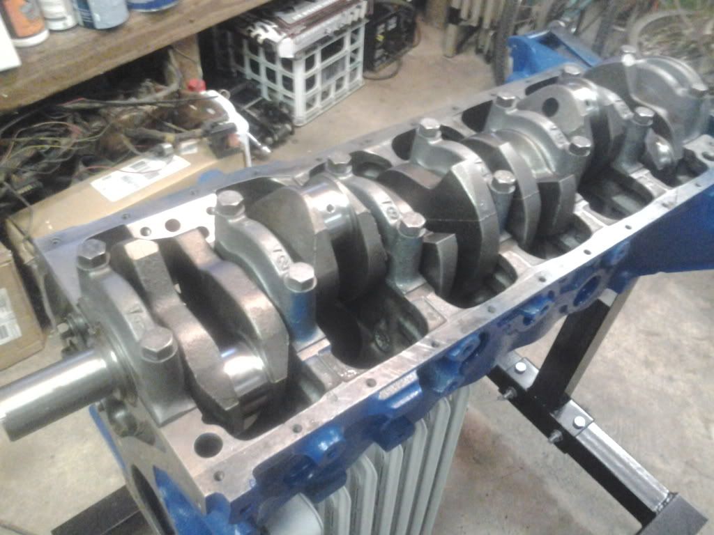

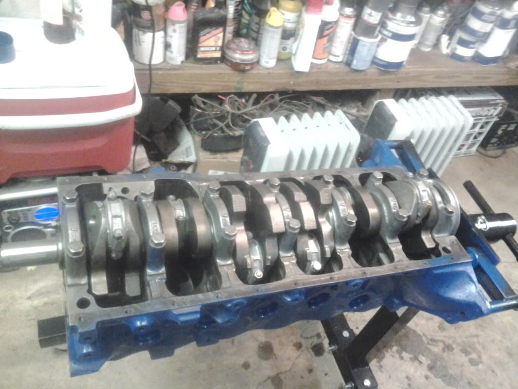

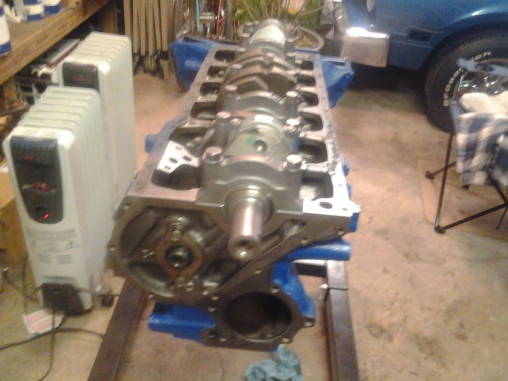

    Today went much better than last Saturday. I installed the cam, crank and pistons. The cam went smooth. I had my first experience with plastiguage, kind of time consuming but glad I checked everything. I had .0015-.002 on all my main and rod bearings. I had a bit of trouble with my rear main seal. It is a steel rod wrapped in rubber and as a bit too long. When I checked my oil clearance on that bearing, the plastiguage was tapered, telling me it didnt seat flat. I took a file to it and got it flush with block and the cap. The pistons went in easily and I'm ready for the timing set. I went to install the timing and I realized I have no key in my cam. I left my old cam at the machine shop so I will have to try to recover it or find a new one. If all else fails, I have another 250 in the yard I can steal it from.

    That’s looking really good! Remarkable how similar the 200 is to the 250 even though its taller and wider. Made a lot of progress, love the way new pistons look too, kind of like the sound of when a wrench hits concrete! Something’s are just awesome to look at!!!!

    Love the pictures, a great job done so far. Just one question, are they cast pistons or aluminum ?

    Thank you. They look aluminum but I believe they are cast. I didnt ask for anything special so Im sure they are same as stock.

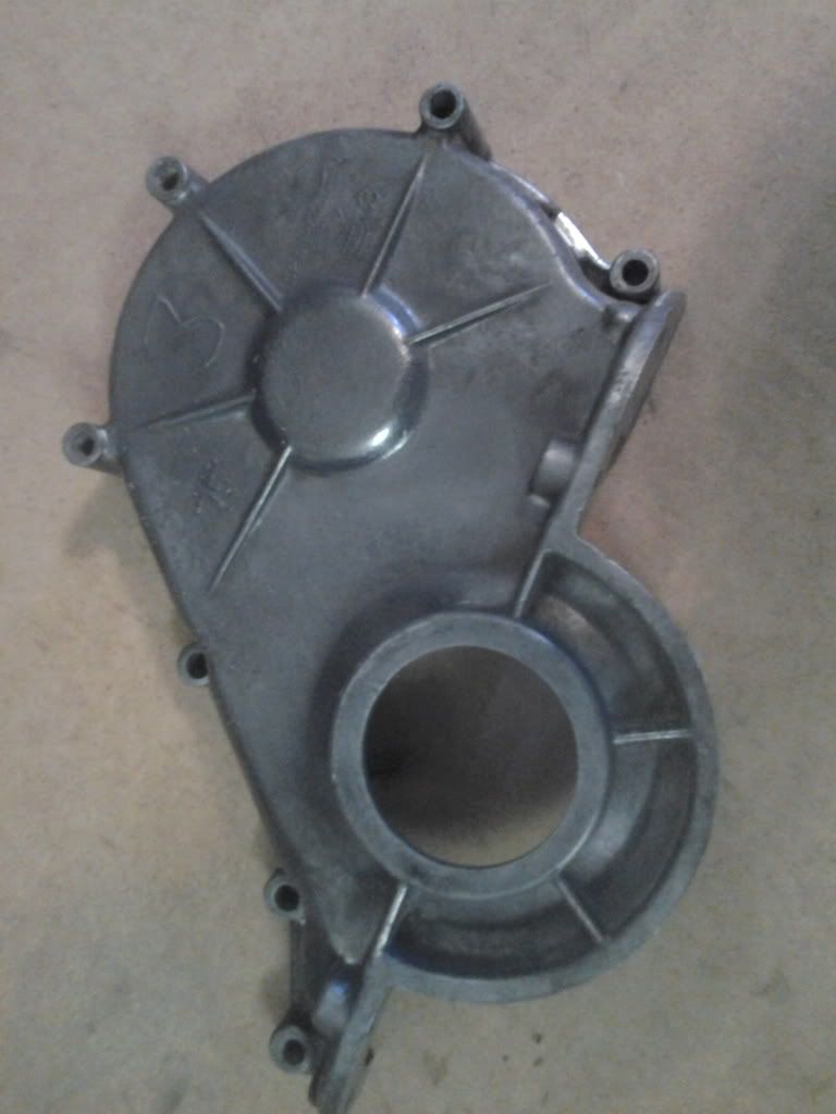

    Happy New Year everyone! Had some time to get out in the garage and work on the engine for a bit. I got the timing set buttoned up and stripped the timing cover with a wire wheel.

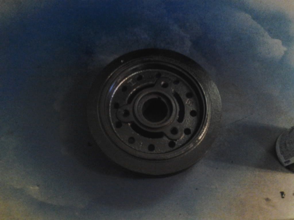

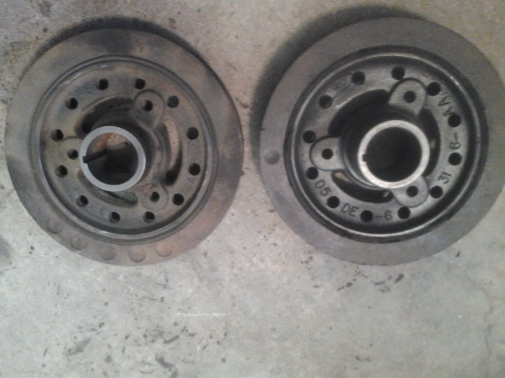

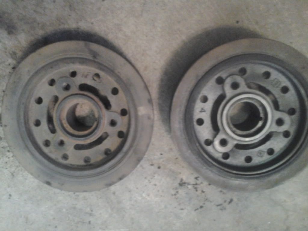

    The paint is drying on the timing cover and now I have a question. Is there any reason why I couldn't use the balancer off a 76 250 instead of the one from the 72? The rubber looks to be in better condition on the later one. I don't see any physical differences in the two. The one on the right is the 76.

    Here is the cover painted along with the later model balancer.
