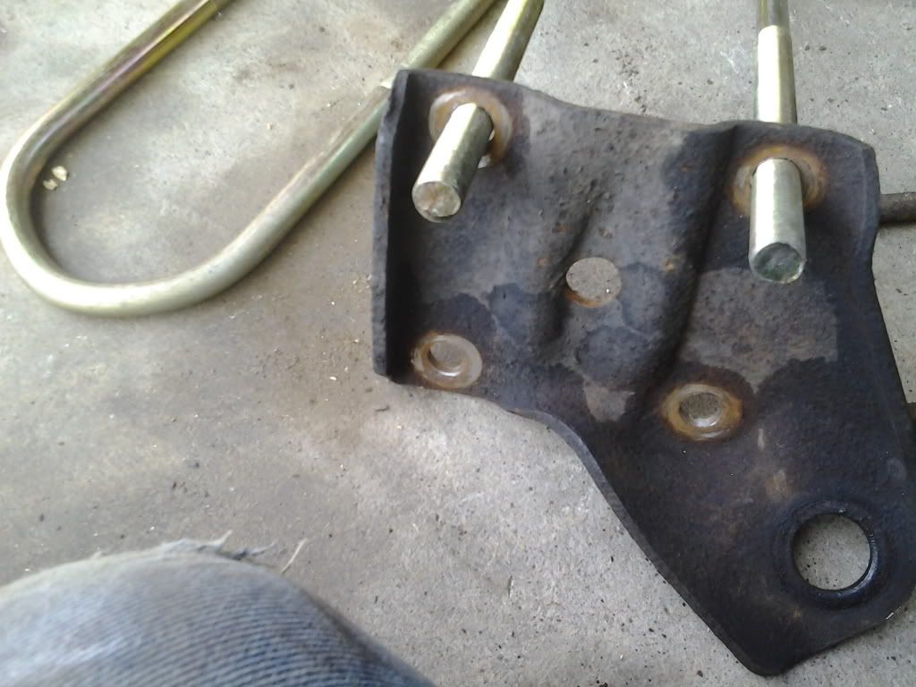

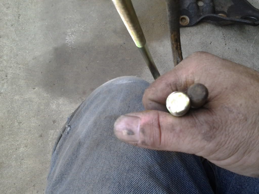

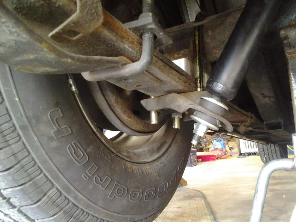

    Another busy day in the garage. I installed a new inline fuse for the new amp. I lowered the idle a little, might go a little lower. I ground down and smoothed out the bottom of my Ford air breather nut. It was tearing up the paint. Also noticed a small scratch on the edge of the breather right beside a place I had just touched up. The brace from the hood was barely touching it. I gave it a few smacks with a hammer, lol. Not sure if I mentioned this earlier but I was loosing a tiny bit of oil out of the dip stick tube. There was nothing left of whatever material it used to have in there. I improvised and took a vacuum hose plug, snipped the tip to allow the dip stick to go thru and slid in on the tube. Now the dip stick seals nice and snug.
    After the alignment my steering was cocked to the right a little. The guy said if he tried to fix it that it might be cocked the other way. I think he was just being lazy, but I told him I would just pull the steering wheel and fix it that way. So I did that today also.

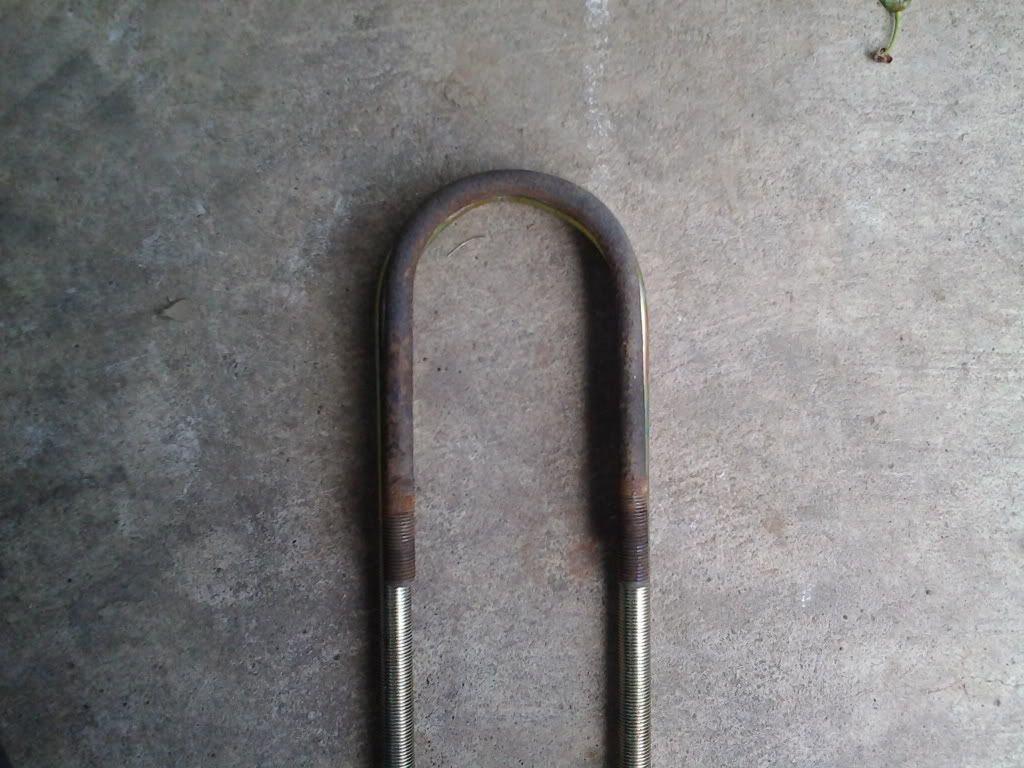

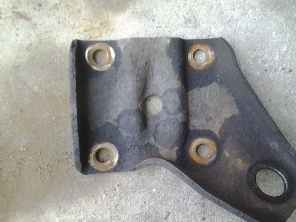

    The big job was dropping the rear end an inch. Actually wasn't that big a deal but the biggest thing I did today. I used the aluminum Auto Zone kit. I know many of you don't like it, but I'm just running a little 250, I don't race, I don't beat on my car. I just cruise.........I'm sure it will be fine.
    It's hard to see in the pic, but u bolts were a tiny bit wider than my stock ones.
    The diameter was larger too, which isn't a bad thing at all.
    Had to drill the holes out to 1/2"
    Here is one side completed after cutting off the bolts.

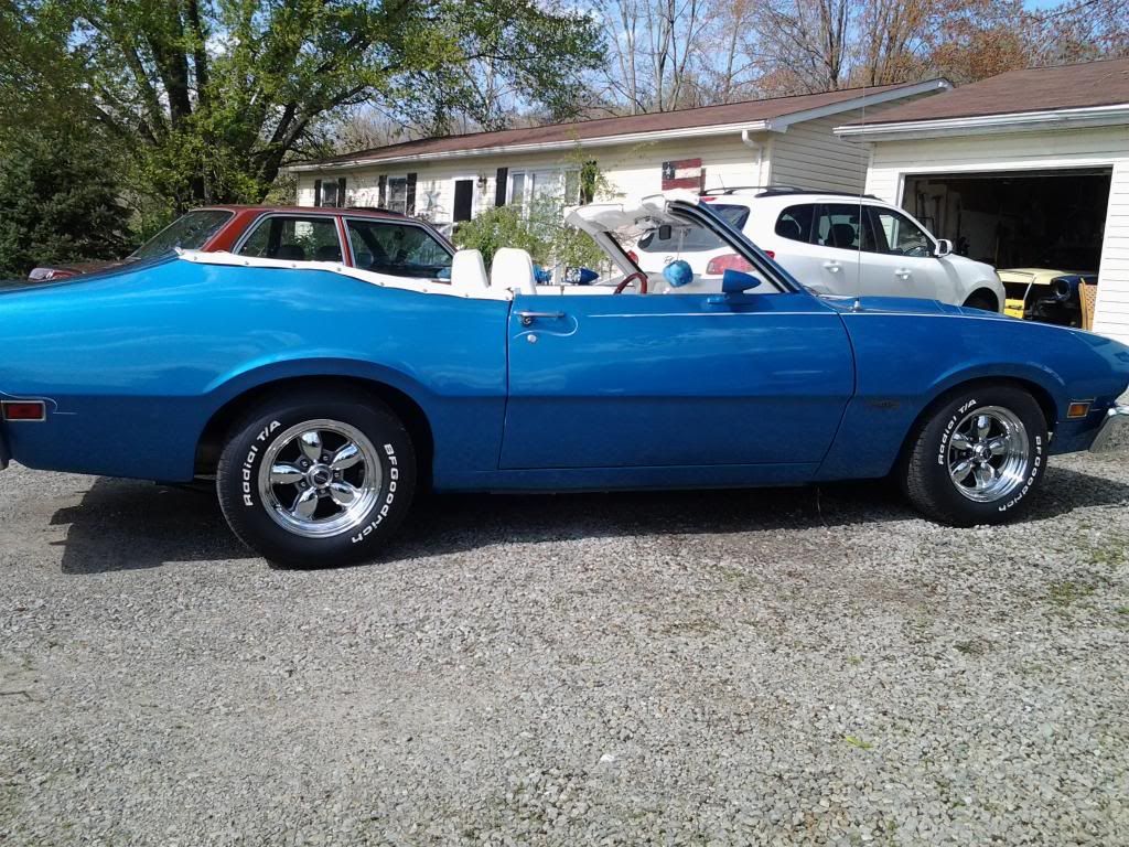

    My new stance. Dropped the front 2 1/2" - 3", dropped the rear 1"...very happy with the result. Car rides just as good as before. Better actually, replacing the upper control arm shafts made a big difference and no more squeak!
