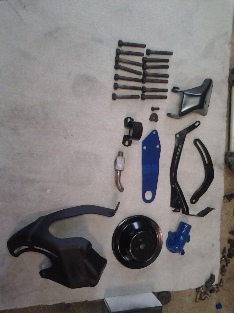

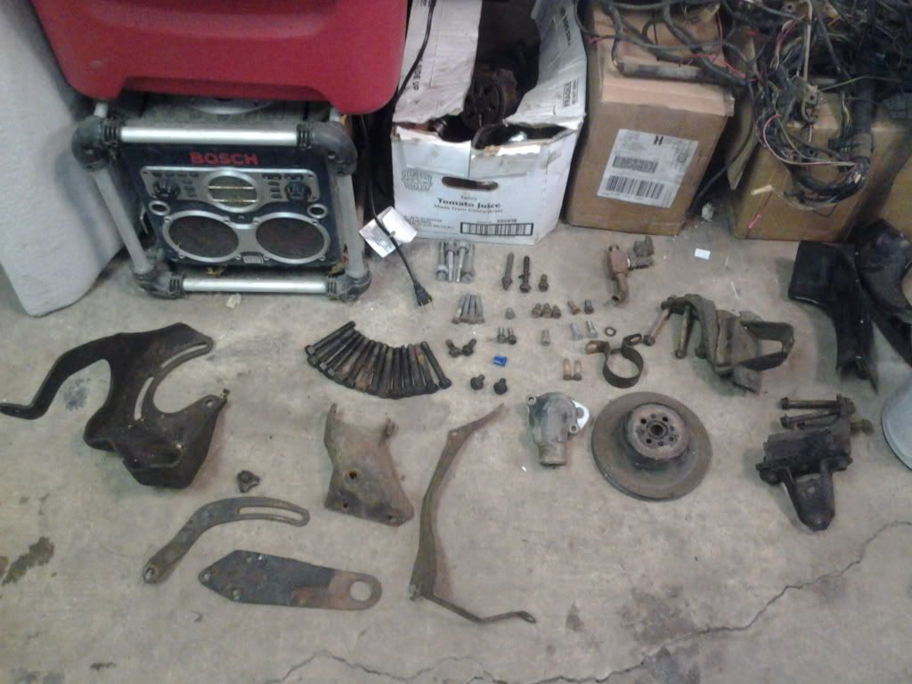

    Worked on getting the accessory brackets and such, stripped and painted.
  10. kboldin
    Jun 10, 2012
    701
    93
    Santee, CA.
    I love shiny new parts!!!!! It’s like Christmas all over again!!!!!

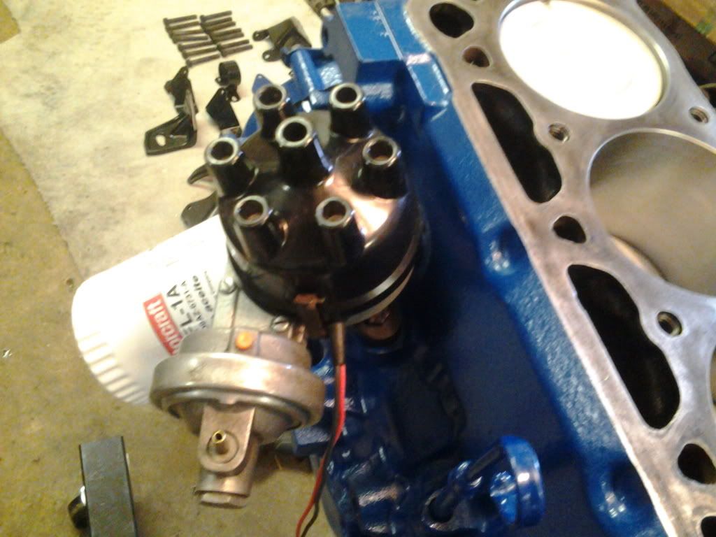

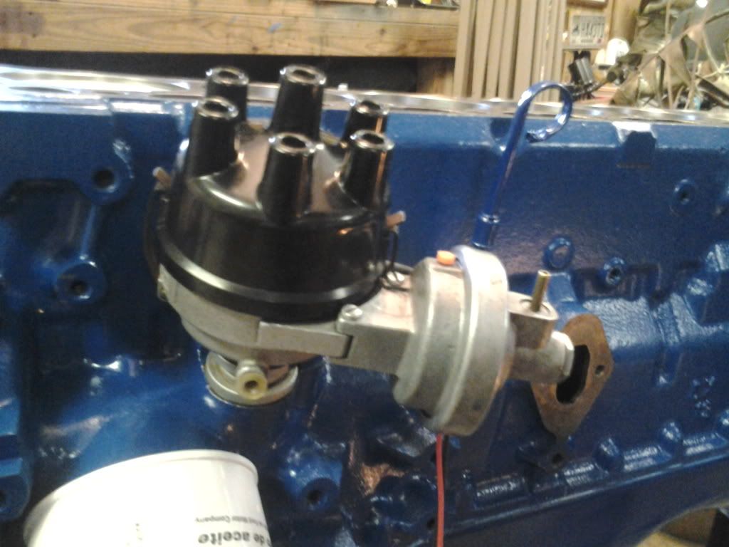

    Got home early today and had time to work in the Man Cave for a while. I put a new shaft in the oil pump, filled the crankcase with a few quarts of oil and ran the pump enough to see oil moving. Then I pulled the distributor and fuel pump off the old 200 and cleaned them up. I installed the distributor, should have time to get the fuel pump in tomorrow.
    I read a thread several months ago about whether a dizzy from a 200 would work on a 250. I checked part numbers and they were the same. Mine dropped right in.
    Here are couple pics from today.
  14. blugene
    10,775
    Progress is progress.. Someday I will make some.. someday..
    I don't remember if you mentioned what, if anything, your doing to the head..
  15. doncomfort
    Apr 16, 2012
    1,289
    chillicothe oh
    Its had a valve job with new seals and guides. All stock, nothing fancy.
