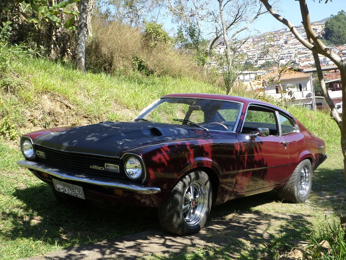

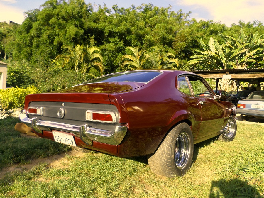

  8. Felipe
    Felipe Member
    Nov 2, 2008
    17
    Brazil
    Ford Maverick 2.3 OHC
    guess 265 in front is too much, it fits but won't be able to steer without rubbing everything, and i think it's a lot unneeded weight on front suspension 275 on 8" wheels is the maximun you will fit ok on the back
    got 295/50-15 ons 10" wheels and it's ok, no rubbing at all, but rebuilt my fenders.
