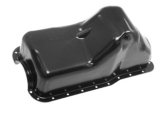

  6. Bryant
    the truck pan is definetly the problem. if i remember corrctly they use more of a center hump pan than the different car pans.
    this is what comes up on google for a truck oil pan
    this is what the front sump oil pan you need looks like
    you will also need to change the oil pick up tube to match the pan.
