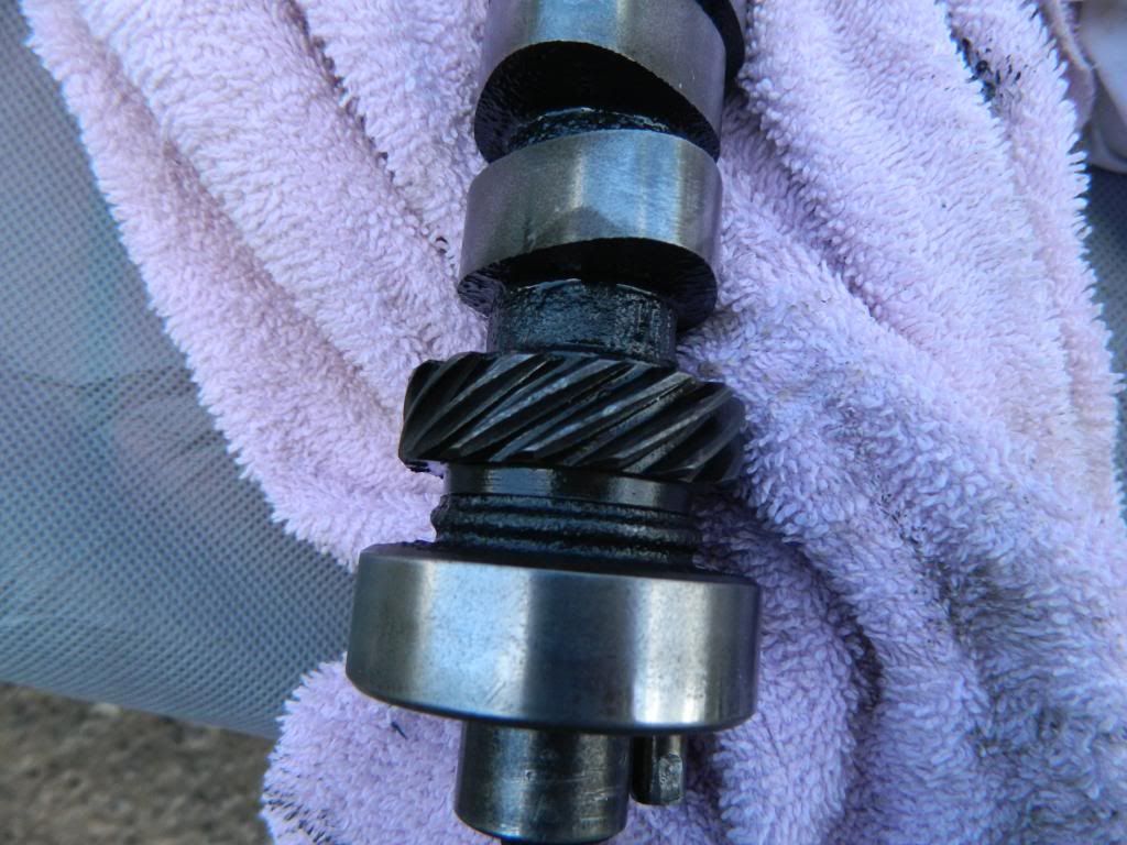

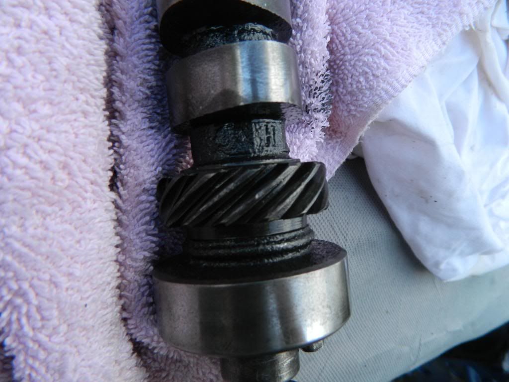

    Got the cam out today. 3-5 teeth have scrapes and chunks in it. Here are the pics. Having trouble identifying it by the numbers. Going to post a thread on it shortly and see if I can get some help figuring out which it is.

    I wouldn't bother. It's well worn with many many miles on it.

    Oh, no. I don't plan on re-using it. I just needed the specs so I can get a replacement.
