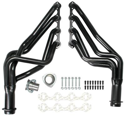

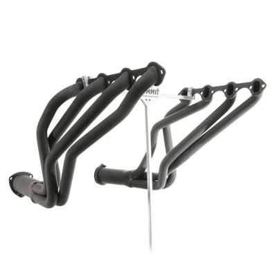

    Got the Summit G9031's. One guy's telling me those fit with a little bit of caressing the firewall, and another is saying he installed Hedman 88300's with no problem by notching the area under the towers a bit...
    ...and since both of those sets of headers look pretty much identical, I figure it's a safe bet one of those methods is going to work for me. I opted for the smaller ones just because I think they'll give me less trouble. But if I ever get heads that can use the bigger tubes then I'll know I can probably drop in a set of 88300's when it's all done.
