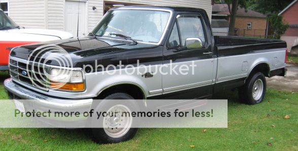

    I'm building a 5.8 efi for my 95 f150 with a tired 5.0. It's a 95 5.8 roller engine completely stock(I believe it 9.1:1 static compression). I'm going to refresh the engine with new rings, bearings, and if budget allows trick flow 170 heads. While I have it apart I'd like to put a cam in it, I'm looking at this cam http://www.summitracing.com/parts/cca-35-510-8/overview/make/ford but unsure if it will work well for my truck. My truck is 2wd, auto, 3:08 may switch to 3:55 , it will mostly be used to haul stuff (i.e. trash, car parts, motorcycles) and occasionally tow the maverick to the track. I would like it to be relatively quick (high 14's) as well, my goal is 300hp, 400ft-lbs. Any better cam suggestions welcome. Thanks in advance!

    I asked on a truck forum, no answer, a search shows few guys running the above linked cam but all were off road trucks. My truck is not what I would call heavy (for a truck anyway) at 4500lbs. I'm basing the power figure on a calculator from ET and weight, says 14.9 at 4500lbs requires 268hp.

    My truck will not spin the tire in a straight line, don't know if its cause the engines tired 233k, or cause the 3.08 rear. I'm planning on a power trax no slip, or if I can find a factory 3.55 ls rear in the yard.
