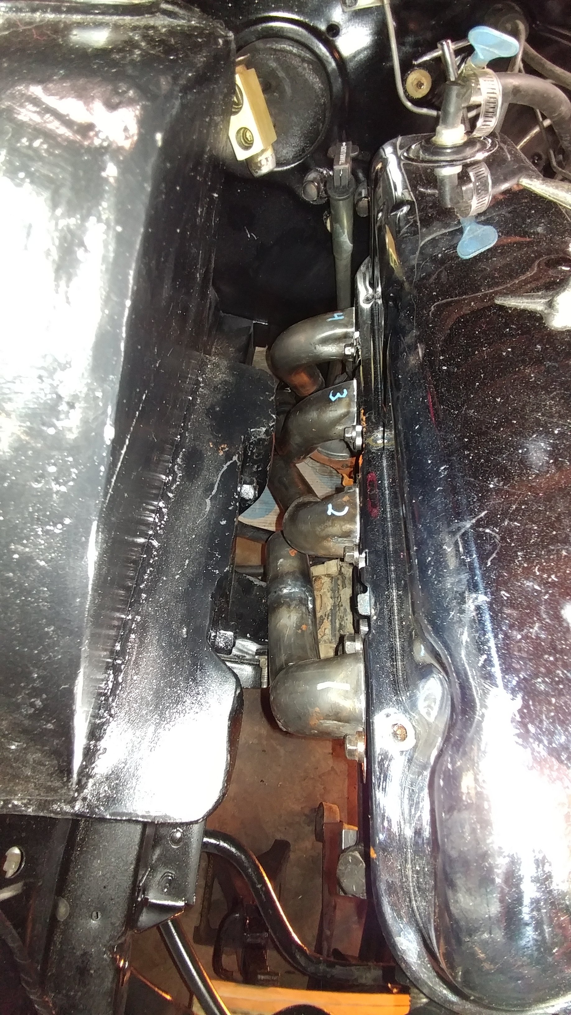

    Or, get the Crites swap headers and do it that way. You will have to cut a piece out of each shock tower, but it will be worth the extra effort.

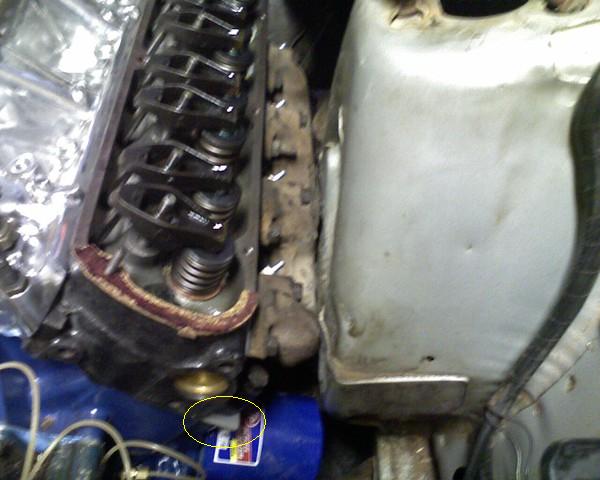

    Here is the difference between a 351W with no modification to the shock tower:
    And chopped towers with Crities headers (this is a 302):
