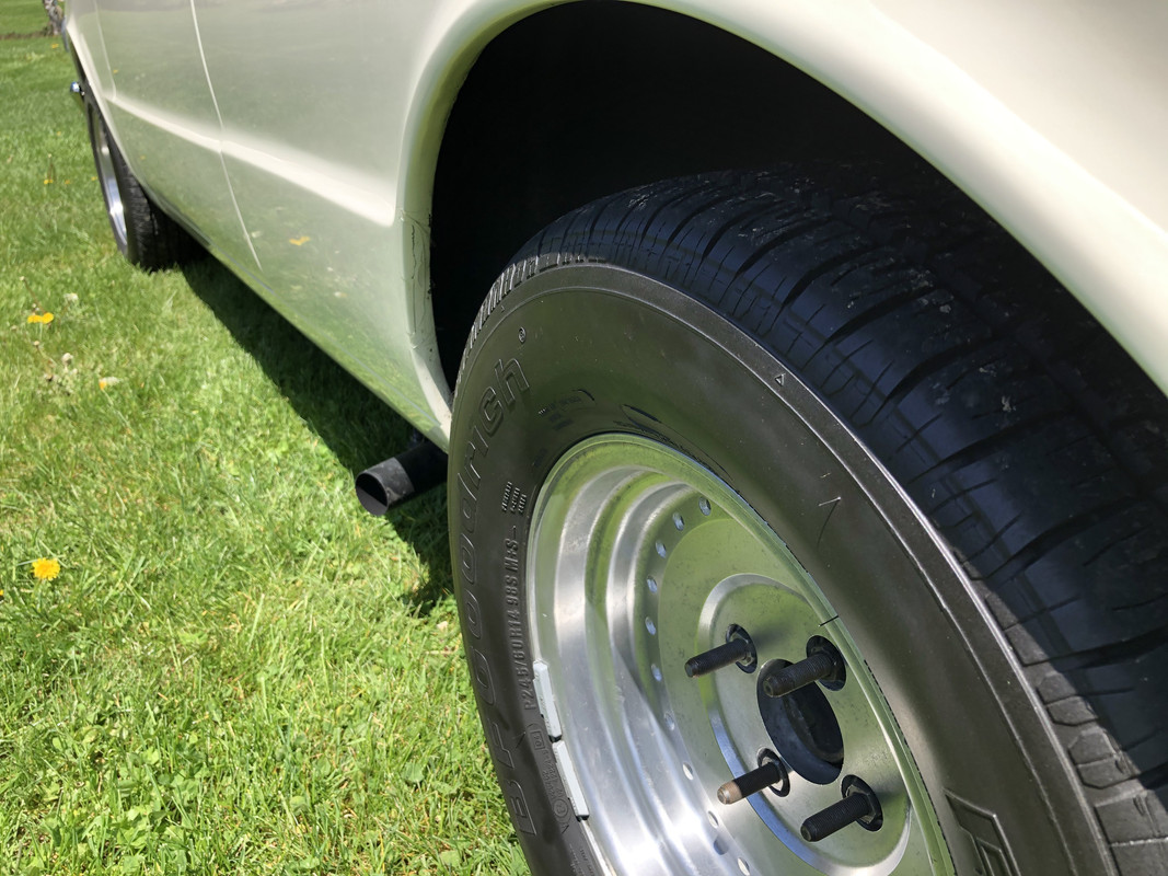

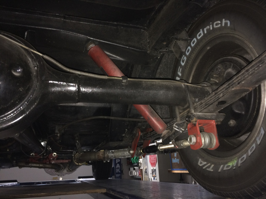

    The 4 bolt Maverick 8" rear will bolt right in to early Ford Falcon / Comet and has value to anyone upgrading from the early integral rear and retaining the authentic 4 lug originality theme.
    61 Comet 250 Tri-Power / 3 Pedals / 8" - 3.80 Posi
    have fun

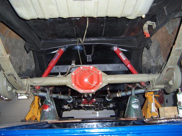

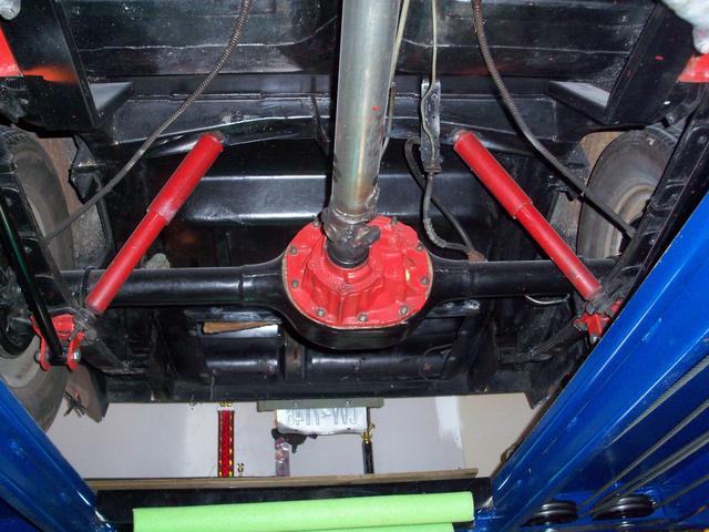

    Is the 7.25 an integral rear axle like early Falcon Comet or different type from 8" and early falcon / Comet integral?.
    ... collected a few six cyl Maverick/Comet rears but all were 8" (AFAIK) . (71 4 lug, 74 & 76 5 lug)
    thanks
    '61 with 60's Integral ( what is size - 7" ?)
    Maverick 4 lug 8" 3.80 Posi in the '61
    . [​IMG]
